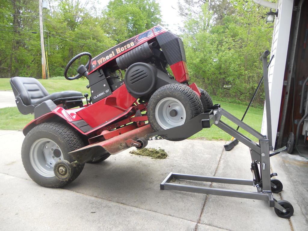

Racinbob 13,004 #1 Posted May 11, 2019 I've always been a stickler for cleaning under the mower deck after every mowing but I'm not going to remove the deck every time. My usual method has always been to lift it with a floor jack under the transmission. I've pondered one of these Harbor Freight lifts for quite some time but just never pulled the trigger. Well, I did a few weeks ago and I have to say that for well under a c-note it's one of the best investments I've made. Much safer than the floor jack. I love it! 10 3 2 Share this post Link to post Share on other sites
squonk 47,053 #2 Posted May 11, 2019 I got one of those too. I do put jack stands under the wheel pads just in case. 1 Share this post Link to post Share on other sites
WHGuy413 2,859 #3 Posted May 11, 2019 I missed out on a mower lift that was for sale here for 40 bucks. Kicking myself for not seeing the ad as soon as it was posted. Less than a hour later it was gone. Share this post Link to post Share on other sites
Racinbob 13,004 #4 Posted May 11, 2019 That's a good idea Mike. With the positive locking thingys I feel pretty safe and I don't slide fully under it. Share this post Link to post Share on other sites
P3x 60 #5 Posted May 11, 2019 That looks like it would certainly make cleaning decks easier. What is the lift/weight rating? Share this post Link to post Share on other sites
Racinbob 13,004 #6 Posted May 11, 2019 300# They also have one with a higher rating but this is plenty to lift the front. Share this post Link to post Share on other sites
edgro 680 #7 Posted May 16, 2019 just a note for all, Harbor Freight currently has a $30.00 off coupon for the 750 lb version of this, I think i'm going to be getting one, l like the color of this one better. coupon is good thru 5/31/19 https://www.harborfreight.com/750-lbs-Heavy-Duty-ATVMower-High-Lift-Jack-63298.html?ccdenc=eyJjb2RlIjoiODgyODc4MzIiLCJza3UiOiI2MzI5OCIsImlzIjoiMTY5Ljk5IiwicHJvZHVjdF9p ZCI6IjEyMTczIn0%3D 1 Share this post Link to post Share on other sites
lynnmor 8,856 #8 Posted May 17, 2019 I have one of those jacks. The hydraulic jack leaks and there is no replacement from Harbor Freight. The bottom mount for the jack broke and bent down to the ground, I bent it back and re-welded it. My suggestion is to get the heavy version and forget this light duty model. Better yet, buy from some other supplier that can supply parts if you have a failure. Share this post Link to post Share on other sites

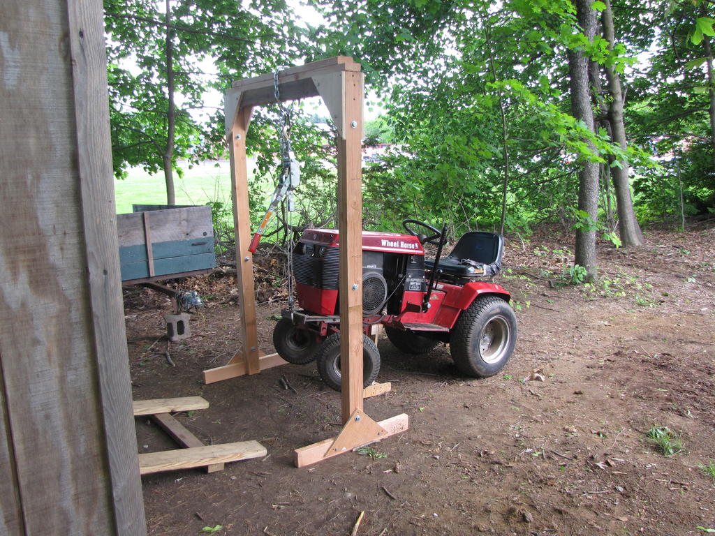

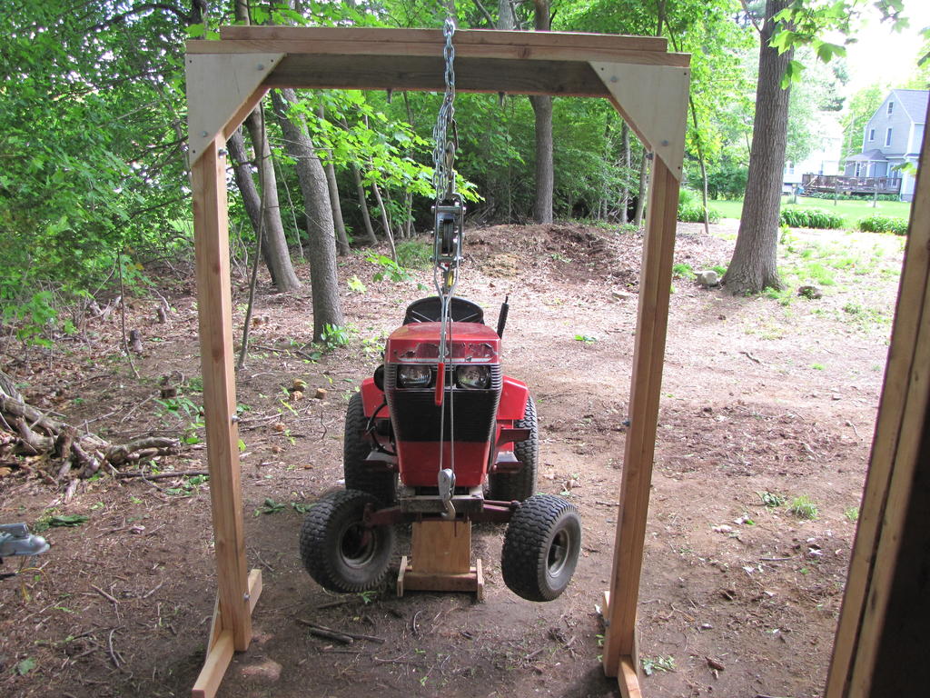

CCW 1,507 #9 Posted May 24, 2019 Not having a garage, barn or shed large enough to work in or store more items I needed a way to lift my 312-8 to allow me to drain the transmission and get the WH off the ground to work under it. Gantry cranes are awfully nice so I built a small one to fit over and across my tractor. Uses a four ton come-along I bought for stump removal. Did the job perfectly without any deflection of the cross beam. 2 Share this post Link to post Share on other sites
CCW 1,507 #10 Posted May 24, 2019 This crane allows me to lift the front end so the bottom of the tires are nearly 20" off the ground. Wood supports for front and rear were very stable. Share this post Link to post Share on other sites
