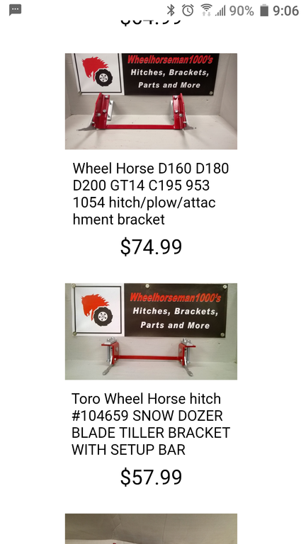

WVHillbilly520H 10,379 #3 Posted May 10, 2019 10 hours ago, RandyLittrell said: Will the axle brackets I have on my GT-14 work on my 310-8. They look like they should, but thought I would ask before pulling them off the 310. Thanks, Randy I believe the GT14 are different from the B,C,3,4,500 series tractors... @wheelhorseman, check his website...https://wheelhorsepartsandmore.com/brackets-linkages.html ... Share this post Link to post Share on other sites

RandyLittrell 3,945 #5 Posted May 10, 2019 Thanks guys, I didn't even think of looking on Wheelhorsemans site. Thanks guys, I will just buy some for the 310. Randy Share this post Link to post Share on other sites
