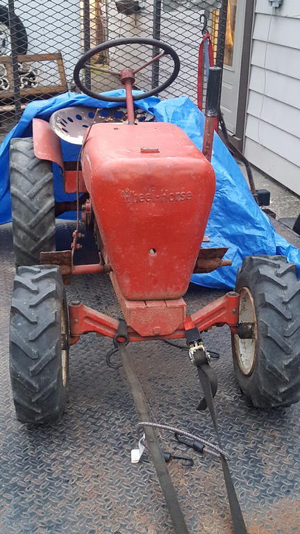

Guest 88vic #1 Posted May 9, 2019 Its time for everyone's favorite game, Guess this Horse ! Share this post Link to post Share on other sites
Jennifer 1,878 #2 Posted May 9, 2019 Guess a suburban with an RJ hood??? 2 1 Share this post Link to post Share on other sites
953 nut 69,131 #3 Posted May 10, 2019 Could we see a front shot and the other side? Share this post Link to post Share on other sites
953 nut 69,131 #6 Posted May 10, 2019 57 minutes ago, Jennifer said: Guess a suburban with an RJ hood??? and the clutch setup from an RJ. Nice Frankenhorse, enjoy it! 1 Share this post Link to post Share on other sites
Guest 88vic #7 Posted May 10, 2019 So its a mix of the 2 ? Suburban and RJ, very interesting. Share this post Link to post Share on other sites
wallfish 20,576 #8 Posted May 10, 2019 (edited) There's a lot going on there. Suburban frame with RJ hood stand welded on. That lift selector might be RJ-59 early style as the notches are on the top. The pedal is RJ as well as the hood. Foot rests are 1960 Suburban Check the brake band tab on the trans. If it's at a 45 deg angle, that side plate is Suburban, if it's plumb straight up and down it's RJ The tension arm for the idler pulley is RJ Also check the casting numbers on top of trans near the shifter, One of the coolest things is the bullet hole! Edited May 10, 2019 by wallfish 3 1 Share this post Link to post Share on other sites
wallfish 20,576 #10 Posted May 10, 2019 RJ trans Guess someone wanted the advanced steering of a Suburban for their RJ It's difficult to see good in the pics but it appears the hood stand was removed from an RJ frame and welded to that one 2 Share this post Link to post Share on other sites

Racinbob 13,135 #12 Posted May 10, 2019 A well done blend of an RJ and Suburban. I'm thinking the frame is Suburban and a 5003 transmission was bolted on. Too many things scream Suburban frame as mentioned as well as the lift sector. Like John said, the hood stand appears to be welded on like the RJ's. The Suburban stand was bolted on. Share this post Link to post Share on other sites
