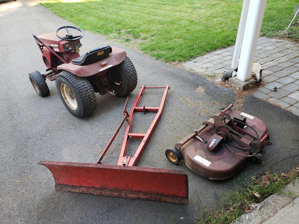

71_Bronco 1,073 #1 Posted May 8, 2019 (edited) Just picked up a '68 Commando 8 (1-4831) , with a 36" deck (5-2362) and a front mount plow (6-2133). Needs a little TLC, but couldnt pass it up. The gentleman was even nice enough to deliver it for me as well, and was super nice. Runs well (says it puffs a little blue when it starts), shifts fine, drives nice. Has the horizontal shaft 8hp Kohler. Need to get some belts for the deck, needs to patch a hole in the deck, and need to address some little things on the tractor itself (figure out why the tires are leaking, fix the seat), but should be a pretty easy repair to get her mowing again. I'll post some better pics later, but heres a teaser for now. Edited May 8, 2019 by 71_Bronco 8 5 Share this post Link to post Share on other sites

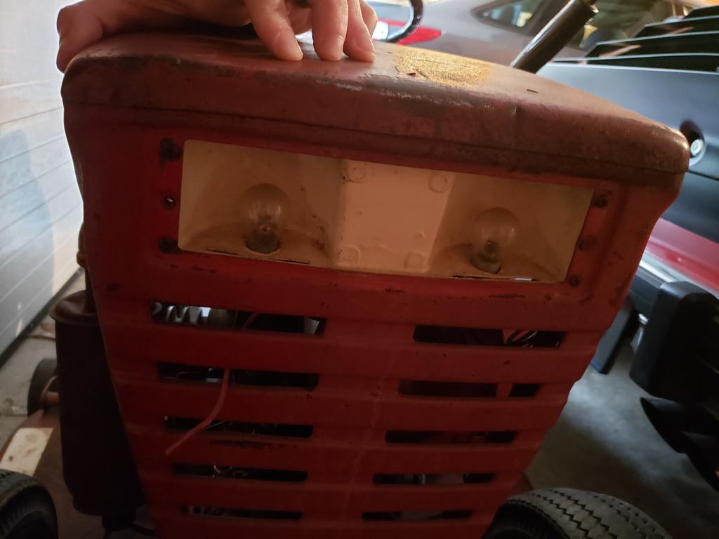

71_Bronco 1,073 #10 Posted May 9, 2019 I bought this to use around the yard, as I just don't have time to finish my Bronco 14 (yet). I will have to do some minor tweaking as I go, but nothing that will prevent me from using this. I have about 1/2 - 3/4 acre of flat lawn to mow, so I shouldn't be working this too hard. Some things I noticed off the bat: - Someone added a head-light conversion to the front, and a red light on the seat pan. They work, but I want to double check the wiring, and may add a solenoid to be on the safe side. - I have 2 hitches, a stationary one that wraps under the trans case, and the swivel one connected to the lift handle via cable. Not sure if this is normal. - Need to look at the clutch pedal set-up, looks a little off to me. All in all, it will be a fun tractor, to use and to tinker with. I think I did well for the price. I am mechanically inclined, and have the tools to wrench on this myself. Looking forward to spending a little QT with her 2 Share this post Link to post Share on other sites
WHX?? 58,347 #11 Posted May 9, 2019 The swivel one is appropriately called a slot hitch and the other one is called a draw bar. What you have is preferred and totally acceptable. The slot hitch is intended for ground engaging implements such as a plow, disc, harrow or cultivator. Draw bar pretty much for tubs. As far as the lights they are commonly PO added and might be fine as is. I guess I don't understand what you mean by adding a solenoid? A single single FUSED switch should work fine. Give us a few pics on the clutch setup and we'll see if we can help with that. I can see you becoming a supporter what with all the you going to need to post! 2 Share this post Link to post Share on other sites
953 nut 70,344 #12 Posted May 9, 2019 8 hours ago, 71_Bronco said: Someone added a head-light conversion to the front, and a red light on the seat pan. Those lights would have been standard on a 1968 Charger, wonder if they were a dealer option? Adding a fuse would be a good idea. Share this post Link to post Share on other sites
71_Bronco 1,073 #13 Posted May 9, 2019 953, thank you for the diagram. I do have the lighter and the rocker switch on my dash. I wonder if someone transplanted it somewhere along the line, or if it was added as a dealer option as you said. I'll get some more pictures tonight, including the messed up clutch pedal. On a completely side tangent, how hard would it be to swap in a larger motor onto this small frame? Something like a K-321 14hp? Share this post Link to post Share on other sites

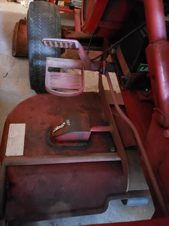

ebinmaine 81,146 #14 Posted May 9, 2019 19 minutes ago, 71_Bronco said: messed up clutch pedal. On a completely side tangent, how hard would it be to swap in a larger motor onto this small frame? Something like a K-321 14hp? if what you're looking at on the clutch pedal is the fact that it leans backwards a bit. You can adjust that some with the rod that connects to it. It's important to make sure that your BRAKE ADJUSTMENT is done FIRST, then adjusting that rod. I have a couple of different 8 horse tractors and I had a 12 and now a 16. If you don't specifically need the extra power for something like a rototiller or tall grass, that little 8 horse is more than enough and it will use far far less fuel.... Right around half. That said, I'm curious to see what the answers are because I'm thinking of putting a 12 into a similar tractor that does not have an engine currently. Share this post Link to post Share on other sites
71_Bronco 1,073 #15 Posted May 9, 2019 6 minutes ago, ebinmaine said: if what you're looking at on the clutch pedal is the fact that it leans backwards a bit. You can adjust that some with the rod that connects to it. It's important to make sure that your BRAKE ADJUSTMENT is done FIRST, then adjusting that rod. I have a couple of different 8 horse tractors and I had a 12 and now a 16. If you don't specifically need the extra power for something like a rototiller or tall grass, that little 8 horse is more than enough and it will use far far less fuel.... Right around half. That said, I'm curious to see what the answers are because I'm thinking of putting a 12 into a similar tractor that does not have an engine currently. That is correct, at rest, the pedal leans back towards the rear end. It does function properly though, both the brake and "clutch" portion. May just need an adjustment. And I'm not looking to replace the 8hp. I have the 14hp Kohler from my Bronco 14 on the bench, and of course, it made me go "hmmm... what if...." lol Share this post Link to post Share on other sites
ebinmaine 81,146 #16 Posted May 9, 2019 1 minute ago, 71_Bronco said: That is correct, at rest, the pedal leans back towards the rear end. It does function properly though, both the brake and "clutch" portion. May just need an adjustment. And I'm not looking to replace the 8hp. I have the 14hp Kohler from my Bronco 14 on the bench, and of course, it made me go "hmmm... what if...." lol Yep. That should be just exactly it. go ahead and get your brake adjustment done and then on the rod where it is attached to the pedal there's going to be a clip. Just pop that Rod out and you should be able to screw that Rod forward there by adjusting it and leading the pedal forward more. I've had the exact same thought about the engine..... Share this post Link to post Share on other sites

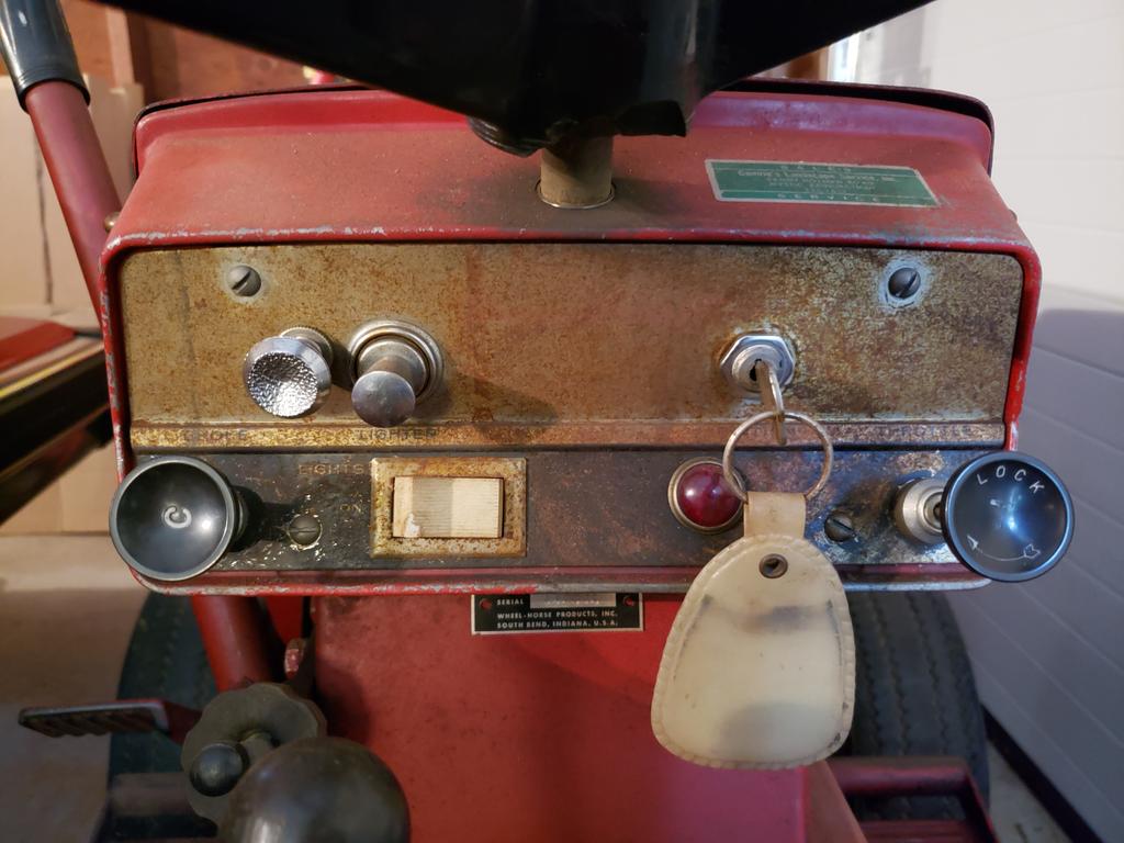

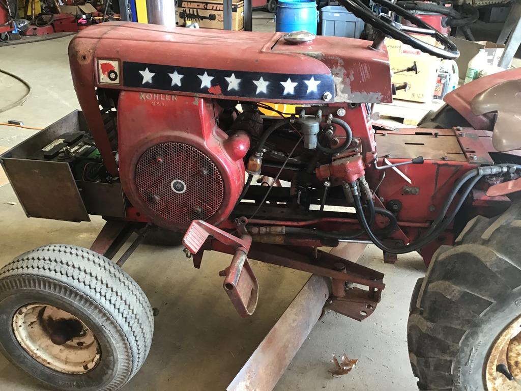

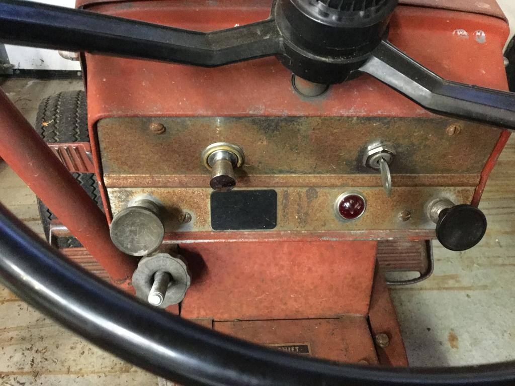

71_Bronco 1,073 #19 Posted May 9, 2019 Got some more pics. The slot hitch is frozen, so I'm going to have to work on that. The headlights dont have a lens, but I have a sheet of 1/8" lexan I can cut one out of. I also took a pic of the dash with all the accessories. I couldnt get a good pic of the clutch pedal because its packed tight in the garage right now. 3 Share this post Link to post Share on other sites
Sparky-(Admin) 26,691 #20 Posted May 9, 2019 Here’s the dash from my Commando 8. Mine has a filler plug where your rocker switch is. It also doesn’t have “LIGHTS” printed next to the spot where a rocker switch would go. Interesting, yours looks factory minus the odd switch you have next to the cig lighter. 2 Share this post Link to post Share on other sites
71_Bronco 1,073 #21 Posted May 9, 2019 (edited) Looks like the lights / dash plate are a definite transplant. I just looked behind the dash with the hood open. There are no wires running to the light toggle switch. The chrome round thing is a pull / push switch, and that is what the light are turned on with. It is also wired so the lights come on no matter if the key is in or out. Will have to either rewire it or make sure I dont leave the lights on and kill the battery. I may keep an eye on Ebay and the classifieds to see if a decent dash plate comes along. Edited May 9, 2019 by 71_Bronco Share this post Link to post Share on other sites
ebinmaine 81,146 #22 Posted May 10, 2019 (edited) 46 minutes ago, 71_Bronco said: Looks like the lights / dash plate are a definite transplant. I just looked behind the dash with the hood open. There are no wires running to the light toggle switch. The chrome round thing is a pull / push switch, and that is what the light are turned on with. It is also wired so the lights come on no matter if the key is in or out. Will have to either rewire it or make sure I dont leave the lights on and kill the battery. I may keep an eye on Ebay and the classifieds to see if a decent dash plate comes along. It's entirely possible, in fact quite likely, that a previous owner was either uninformed or too lazy to find the correct switch. It's crazy what some people will do to these machines. The dash plate you have could be usable with a sticker kit from Terry but you may still see a small dimple there. Throw an ad in the wanted section and I'm quite sure you'll find something very soon. Edited May 10, 2019 by ebinmaine Correct autocorrect Share this post Link to post Share on other sites
