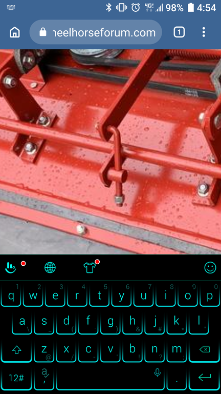

McSterritt 17 #1 Posted May 8, 2019 Hey all, I just finished breathing some new life into this deck I picked up. It’s a 85-42MR01 and it has a different height adjustment mechanism then most of the other decks I’ve seen. I’ve looked for an owners manual but I haven’t been able to find one for this particular deck. Honestly this is the first deck I’m going to put on my 520H and maybe the adjustment will become obvious when I start but I was wondering if anyone as seen an operators manual for one of these decks with what I will call “multi-link” rear height adjusting wheels? Will the adjustment be the same as rear discharge decks that have the simpler rear wheel setup? Before and after pictures bellow. Pretty much rebuilt everything. Thanks 1 Share this post Link to post Share on other sites

McSterritt 17 #5 Posted May 8, 2019 My question was targeted at the rear trunion nut. I just wasent sure if the adjustment would be any different with this style rear wheel. Thanks for the help. Now if it would stop raining in NY I could throw the deck on and do some mowing! 1 Share this post Link to post Share on other sites
