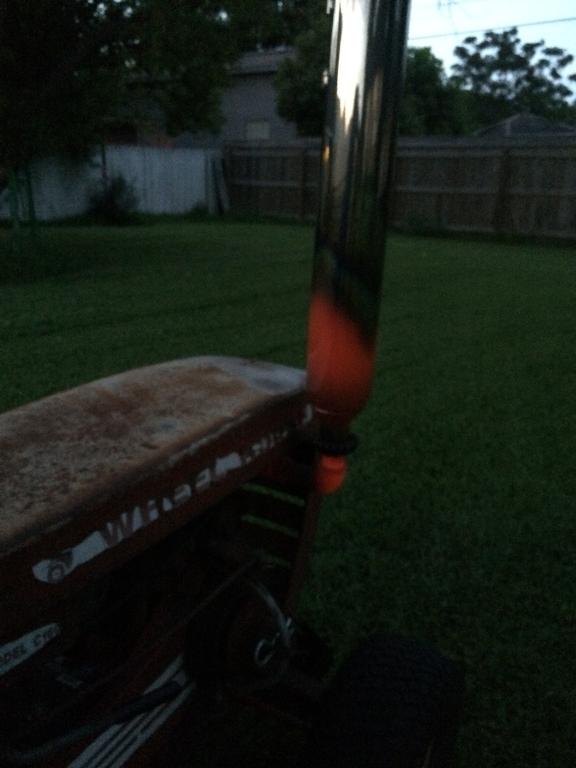

Hacksawhero123 351 #11 Posted May 12, 2019 My k341 was set a bit too far advanced and was running hot. My exhaust elbow and stack tip was cherry red hot. After retiming, she ran cooler and all was well in the world again. Use an ohm meter. You want the points to break contact at the same point that the “S” timing mark on the flywheel lines up with the pointer. Best of luck. Mark 1 Share this post Link to post Share on other sites
Hacksawhero123 351 #12 Posted May 12, 2019 A good sign that your timing might be a fuzz off. Mark. 1 Share this post Link to post Share on other sites
