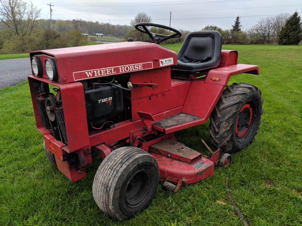

Harris1453 1 #1 Posted May 5, 2019 Hello, I just joined the wheel horse party I just bought a d160 kinda on a spur of the moment thing and now I may be regretting that a bit but I'm hopeful I can get some help! The problem I have is someone through the years repowered it with a KT17 series 2 motor and I have an issue where it starts and runs pretty well but as soon as the mower gets hot it loses all power when running the mowing deck. If I shut the deck off I have enough power to make it back to the garage. Once cooled down it will work good again for about 15-20 mins and do the same thing. Things I have checked and did so far 1. Plugs look ok, I cleaned them and have new ones on the way but overall I don't think they look to bad 2. Cleaned the carb and adjusted to where I seems to run the best. I will say that I can get it to run fairly smooth even when warm but not with any load on it. 3. I found one of the spark plug wires that go to the cylinder I believe is not running correct had corrosion on the terminal that connects to the could so I clean that up the best I could. 4. When running rough if I pull that wore off the coil I notice no real change in the motor. If I plug that one back in and pull the other the motor dies quickly. So I am suspecting a bad coil from what research I have done but wanted to see others thoughts. I don't currently have a way to check compression but I'm willing to get what I need to make this thing run good. Also thoughts on this thing running with the KT17 vs original motor and if I should consider another repower of it. I paid 600 for it and body and hydro wise all seems to be in great shape. Also came with wheel weights and 48inch snowblower Thanks in advance and sorry for such a long first post 😁 Mike Share this post Link to post Share on other sites

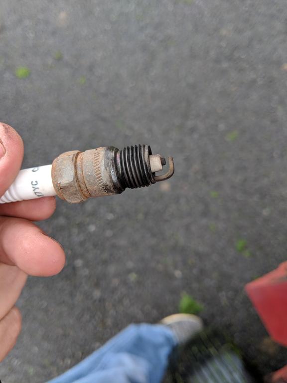

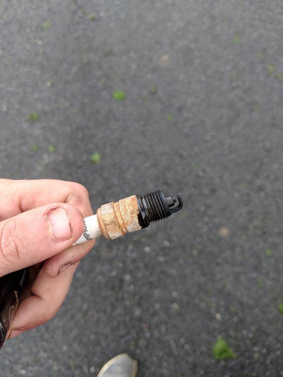

Harris1453 1 #7 Posted May 5, 2019 Well, I bought a inline spark tester and the bad news is even when running rough it appears I have spark. I pulled the spark plugs after running for a awhile and this is what they looked like after. Sorry I'm a bit lost at this point so any help is greatly appreciated 🙏🙏🙏 Share this post Link to post Share on other sites
953 nut 69,578 #8 Posted May 5, 2019 Have you removed the engine tins to clean your engine's cooling fins? I would replace the spark plug that is not firing to see if it is defective. Share this post Link to post Share on other sites
Darb1964 1,174 #9 Posted May 5, 2019 The plugs don't look that good to me, you could switch the plugs in the cylinders see what that results. The gap looks wide to me. I know it sounds simple but how well is the deck greased,or maybe some other drag. I picked up a 518_h last year for parts the po told me his service guy thought the motor was blown. I got it home charged the battery fresh gas started right up smoked and cleared up when it got warm. When I tried to move it dogged down smoked bad, the parking break was stuck. The i engaged the deck same. I greased the tractor freed up the deck very little smoke. I have fixed the break , the tractor runs and works good uses some oil but a lot of use let in her 1 Share this post Link to post Share on other sites

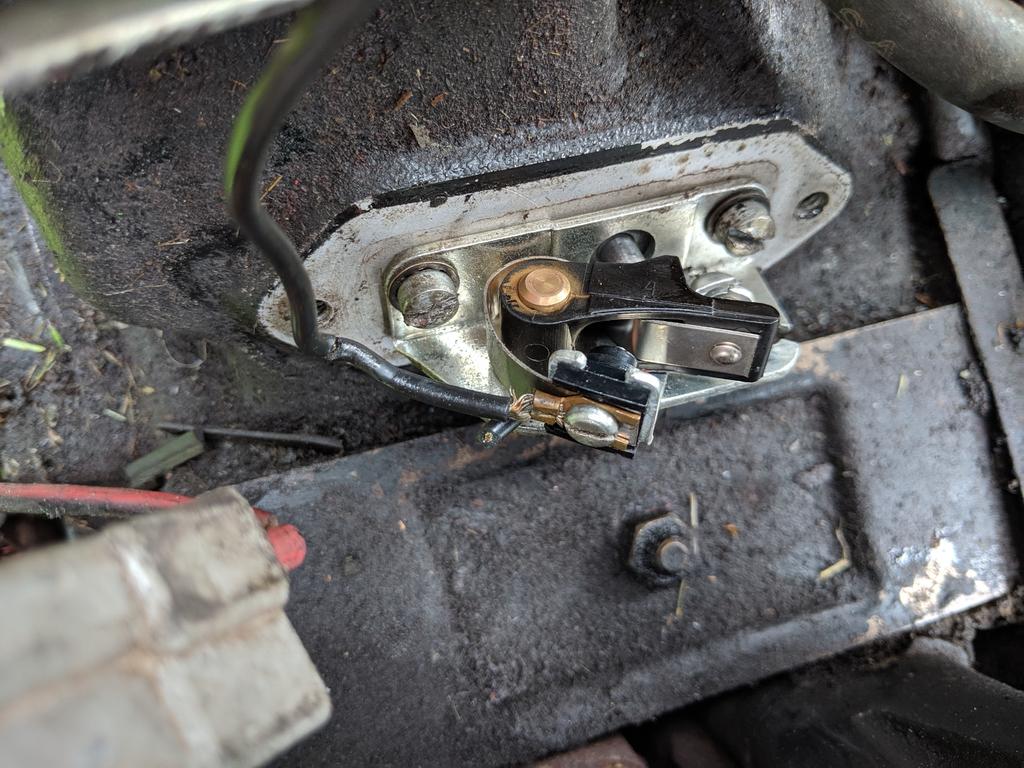

Harris1453 1 #18 Posted May 10, 2019 Finally some success!! I looked at the points (I know I should have sooner) and the wire from the coil was barely hanging where it connects to the points. Also I adjusted the gap to .020 per the spec in the manual (it was at .035). It's running like twice the tractor it was even when j thought it was running good lol. I mowed for close to 40 mins with no major issues. It still wants to run i with the choke half on so I'm going to take the carb off and clean. While I'm doing that I will look for any air leaks. But overall it's running waaaaaaaaay better. Thanks for all the help! 1 Share this post Link to post Share on other sites
Bill D 3,159 #19 Posted May 12, 2019 Glad to see you found the main problem. I would recommend installing a new, high temp wire from the coil to the points as the wire looks damaged in the pictures. Also, install a new cover gasket and wire seal after you install the new points and condenser. Good luck with it. Bill Share this post Link to post Share on other sites
