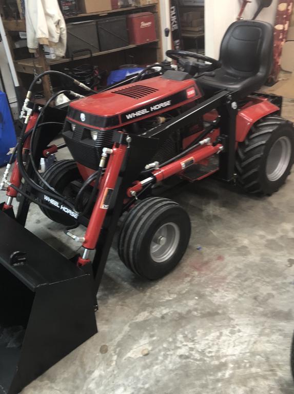

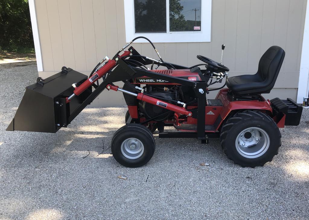

cschannuth 3,821 #11 Posted May 5, 2019 Here’s mine. No issues but I don’t run a mower deck. 4 2 Share this post Link to post Share on other sites
trailhopper 50 #12 Posted May 5, 2019 21 minutes ago, cschannuth said: Here’s mine. No issues but I don’t run a mower deck. Super nice machine! What size rear tires are you running? 1 Share this post Link to post Share on other sites
cschannuth 3,821 #13 Posted May 6, 2019 On 5/5/2019 at 6:45 PM, trailhopper said: Super nice machine! What size rear tires are you running? 23 10.50 12 Share this post Link to post Share on other sites
Chris T 397 #14 Posted May 19, 2019 On 5/5/2019 at 7:22 PM, cschannuth said: Here’s mine. No issues but I don’t run a mower deck. Those fronts are 18s? 1 Share this post Link to post Share on other sites
cschannuth 3,821 #15 Posted May 19, 2019 9 hours ago, Chris T said: Those fronts are 18s? 18” diameter. 18x8.50x8 Share this post Link to post Share on other sites
