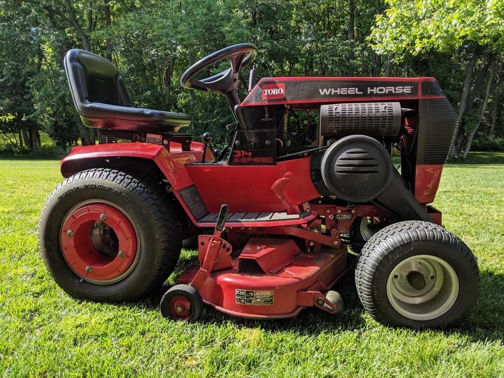

Lots of great options! Well I got suckered into buying a pair of cast iron weights tonight by an original wheel horse dealer. I will post pics in a new post. I figure I will try weights, than adding fluid, and then ag tires if I still have trouble.

Thanks everyone for your help! I got the weights on today and it made a HUGE difference on the slopes. Granted it is getting drier out but I'm sure it will still be significant with some moisture. I'm going to hold off on the ag tires and chains for now.
