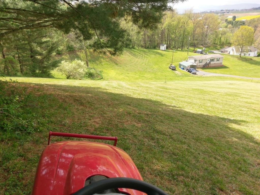

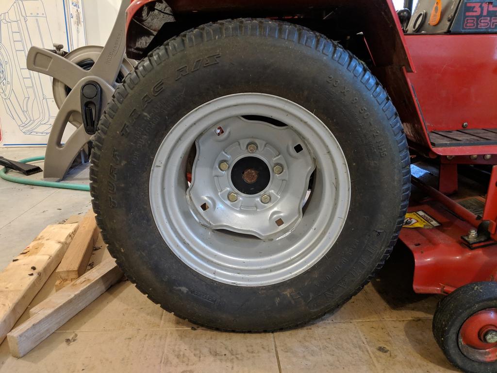

csvt99 173 #1 Posted May 5, 2019 I recently picked up a 314-8 with a 42" rear discharge mulching deck that is now my primary yard mower. I have a slopped section that is 3.5:1 or about 16-17 degrees. I typically mow when the grass is dry but in the evening. There are a few spots where I loose traction along the slope and it spins and I get in a bind depending in conditions. I can mow straight up and down but it will sometimes freewheel on the way down. Do you recommend wheel weights or ag tires? Any other suggestions? Share this post Link to post Share on other sites

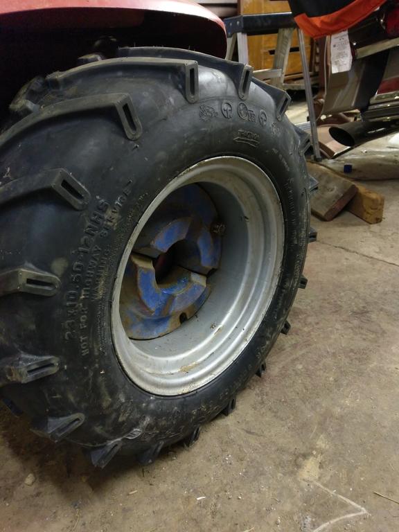

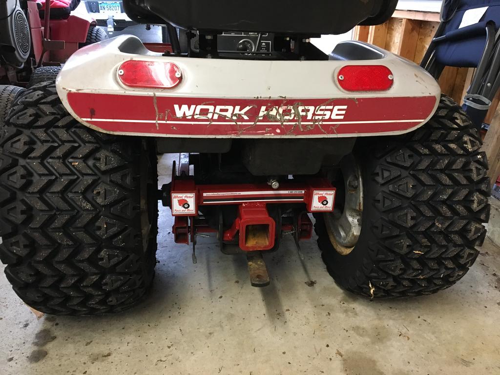

Sparky-(Admin) 26,693 #15 Posted May 5, 2019 Or get something less aggressive than Ags and more aggressive than standard turfs. Then add some weights. Like these.... 10 Share this post Link to post Share on other sites
csvt99 173 #16 Posted May 5, 2019 Any recommendations on wheel weights? I have no experience with them. I've see black wheel horse ones that look nice. Do I have to worry about them scratching the rims? Share this post Link to post Share on other sites
Sparky-(Admin) 26,693 #17 Posted May 5, 2019 Weights will scratch the rims a bit, no harm in that. And if the weights stay on the machine tear round you’ll never see any scratches ! I think any brand wheel weights sized for a 12” rim will work, you don’t have to use weights with the WH emblem on them. Share this post Link to post Share on other sites

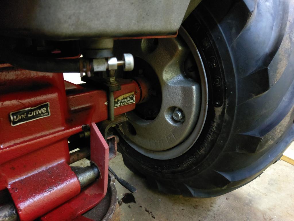

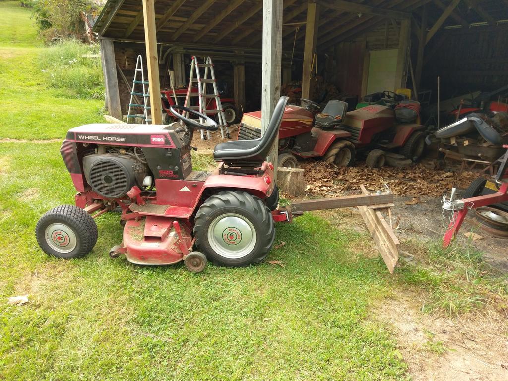

WVHillbilly520H 10,379 #21 Posted May 5, 2019 (edited) 3 hours ago, richmondred01 said: 5 hours ago, Sparky said: Or get something less aggressive than Ags and more aggressive than standard turfs. Then add some weights. Like these.... Like Mark and Sparky,I too have a set of the Farmall/Cub Cadet weights on the inside of my wheels (25# each) plus a set of hard to find Massey Ferguson split weights (35#) hiding behind my custom powder coated wheel covers... Edited May 5, 2019 by WVHillbilly520H 1 Share this post Link to post Share on other sites
