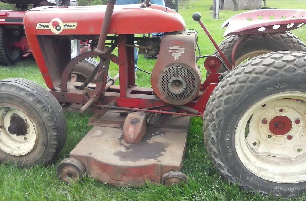

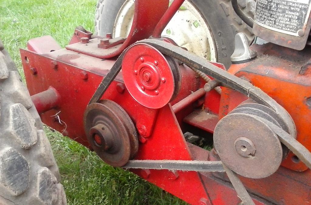

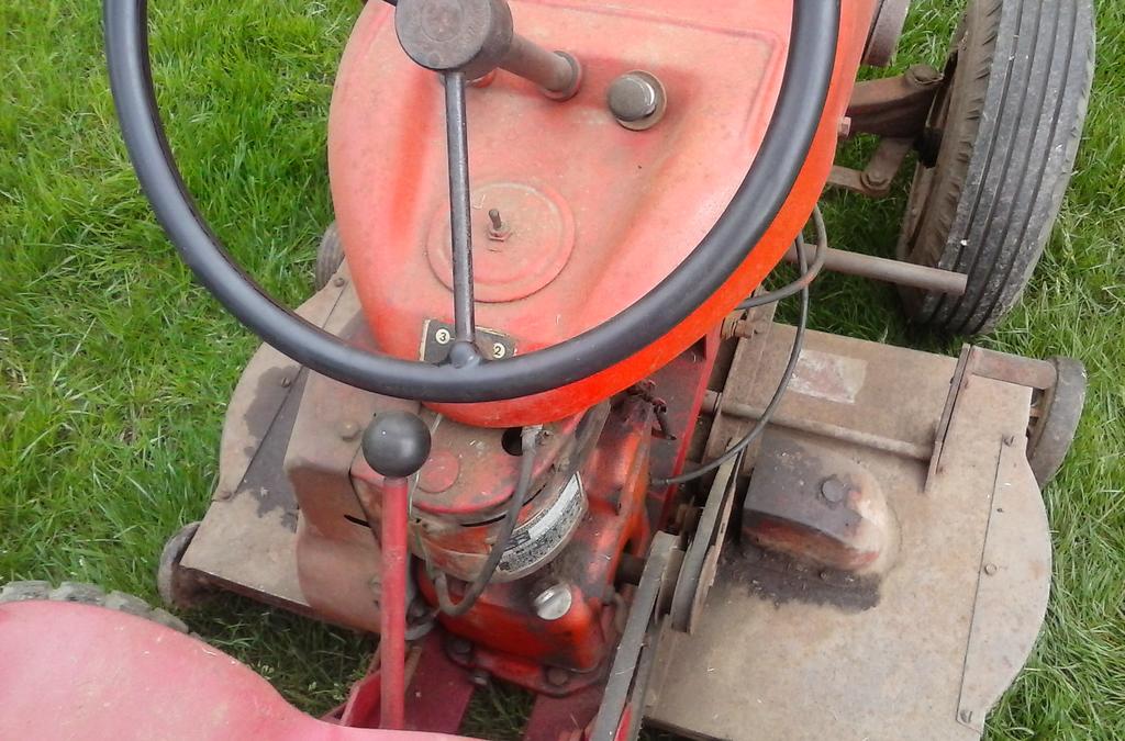

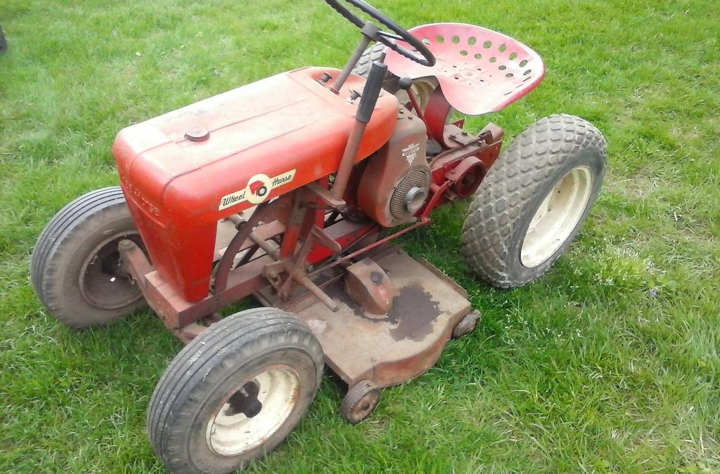

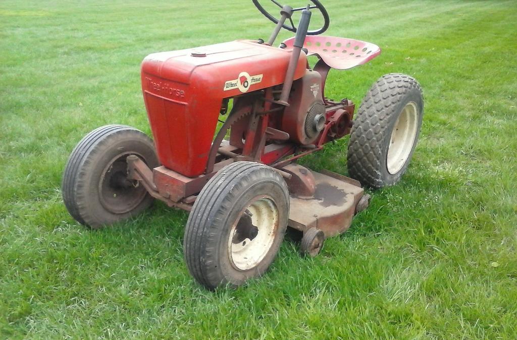

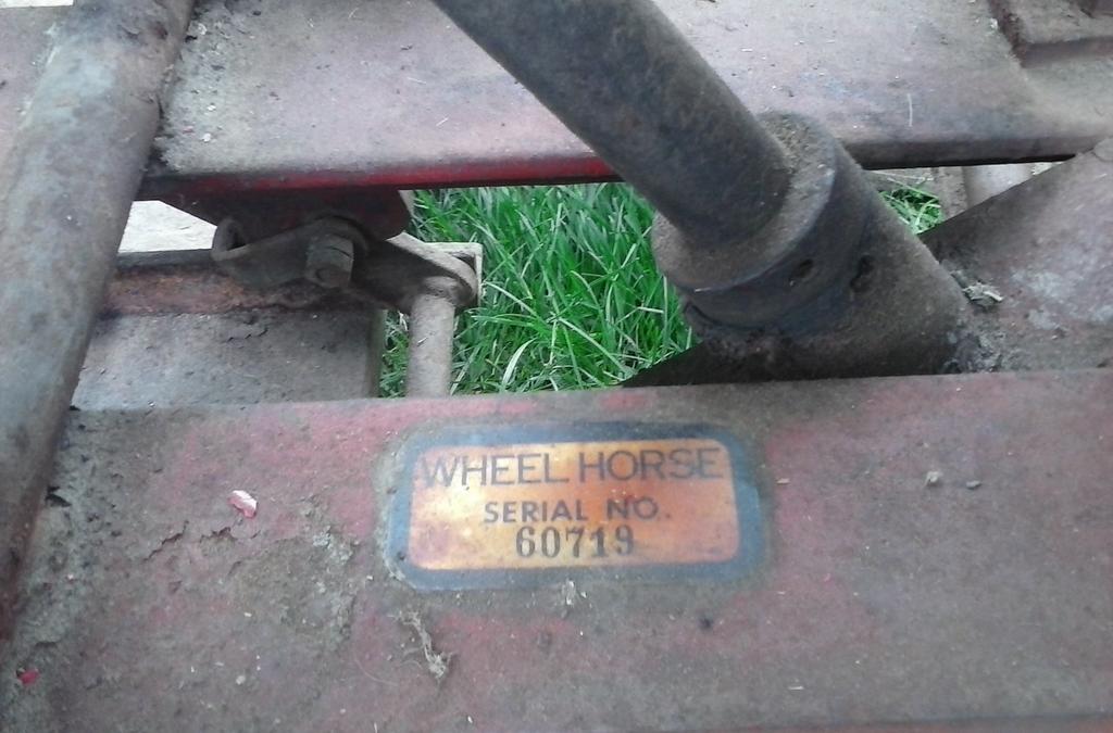

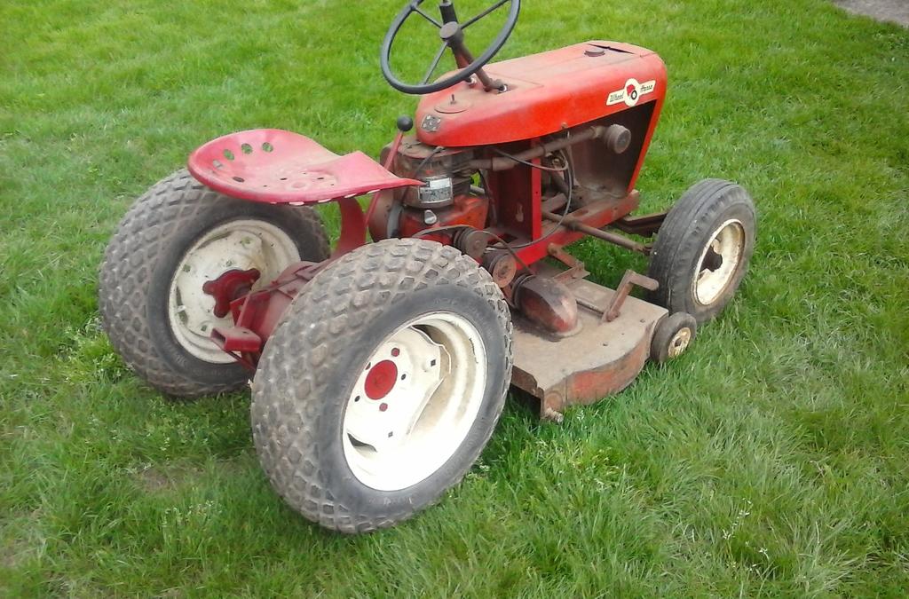

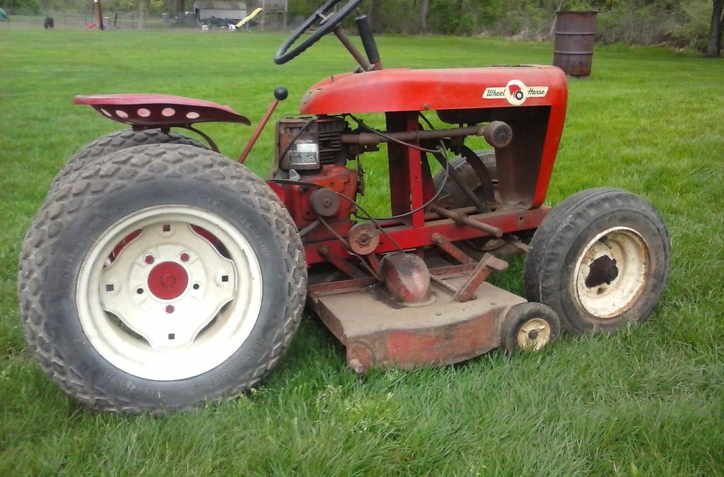

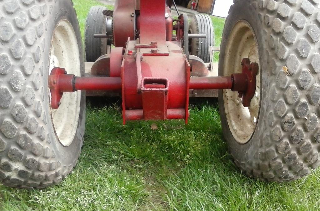

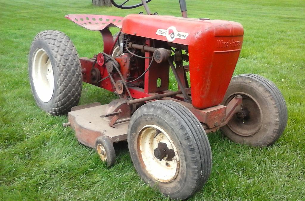

76c12091520h 4,189 #1 Posted May 4, 2019 Ok,need some help from the experts; this has been in my dad's Horse collection for about 30 yrs. His field of expertise ranges from about 1960 on up. What exactly is it and what pieces am I missing beyond the obvious heat shield, belt cover, and recoil? I'm gonna restore it after my 520H and I want to start gathering the missing pieces . I intend to do it cosmetically perfect and as correct as I can. Have at it: 9 3 1 Share this post Link to post Share on other sites
953 nut 66,569 #2 Posted May 4, 2019 (edited) 1961 401 Suburban. It would have had a Kohler K 91 from the factory. Edited May 4, 2019 by 953 nut 2 Share this post Link to post Share on other sites
AMC RULES 37,259 #3 Posted May 4, 2019 ...and, rarely seen Clinton powered. 1 Share this post Link to post Share on other sites
AMC RULES 37,259 #4 Posted May 4, 2019 Cool tractor! Share this post Link to post Share on other sites
wallfish 20,033 #5 Posted May 4, 2019 Agree 1961 401 That Clinton could certainly be a factory original engine. They did produce 401s with a Clinton and I have one too. Not super rare but most of them did come with a K91 Kohler. 2 Share this post Link to post Share on other sites
Shynon 7,596 #6 Posted May 4, 2019 2 hours ago, wallfish said: That Clinton could certainly be a factory original engine. @WHX22 what year is your burb with the Clinton? 1 Share this post Link to post Share on other sites
76c12091520h 4,189 #7 Posted May 5, 2019 That's what I thought; I couldn't win the argument with my dad the Wheel Horse dealer, he was convinced it was an rj because of the Clinton but I just saw too many things that didn't look right. He still relies on his old paper manuals and parts books, microfiche , etc. What else does anyone see that may be incorrect? Share this post Link to post Share on other sites
Pullstart 70,103 #8 Posted May 5, 2019 @76c12091520h!!! Nice tractor, whether it’s original or not! 3 Share this post Link to post Share on other sites
rjg854 13,073 #9 Posted May 5, 2019 @76c12091520h I have to agree with Kevin Share this post Link to post Share on other sites
wallfish 20,033 #10 Posted May 5, 2019 9 hours ago, 76c12091520h said: That's what I thought; I couldn't win the argument with my dad the Wheel Horse dealer, he was convinced it was an rj because of the Clinton but I just saw too many things that didn't look right. He still relies on his old paper manuals and parts books, microfiche , etc. What else does anyone see that may be incorrect? 401 --- Cast front axle, cast foot pedal, push/pull controls, stamped steel hood stand, idler pulley pulls up on inside of belt, lift selector RJ --- Steel front axle, steel foot pedal, lever throttle control, steel bar hood stand, idler pulley pushes down on outside of belt, no lift selector The hoods, belt guards, gas tanks and steering components are different. That should win the argument, LoL I don't see anything on there that's incorrect. That's a 1961 deck too. It's just missing the fenders, belt guard and heat shield 2 1 Share this post Link to post Share on other sites

Jennifer 1,878 #17 Posted May 6, 2019 Oh and I might be wrong but if you could find the shower head muffler for your and a replacement wheel that’s missing on your deck! The cast foot rest. Just my two cents! Share this post Link to post Share on other sites
gwest_ca-(File Mod) 12,276 #18 Posted May 6, 2019 60719 is the highest 1961 serial number recorded so far. Click on the picture. 1 Share this post Link to post Share on other sites

953 nut 66,569 #22 Posted May 7, 2019 8 minutes ago, bottjernat1 said: 1960 suburban 1961! 1 Share this post Link to post Share on other sites

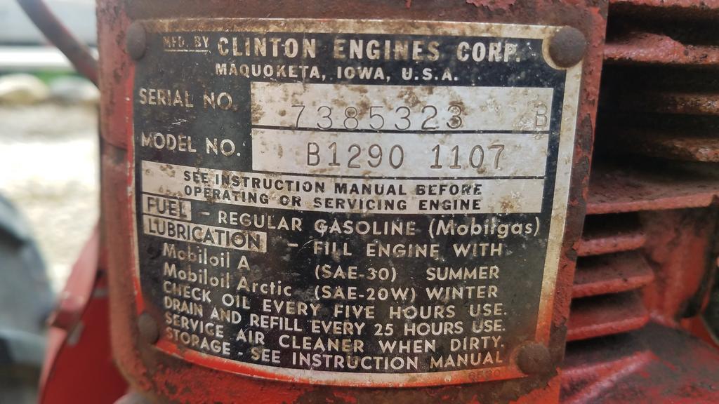

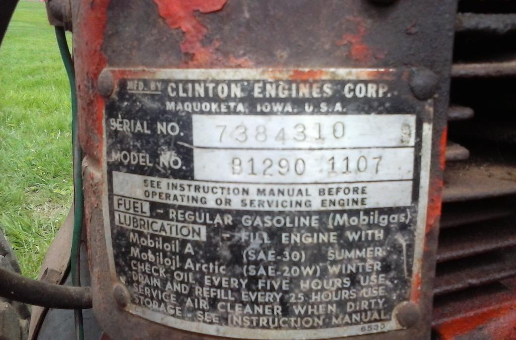

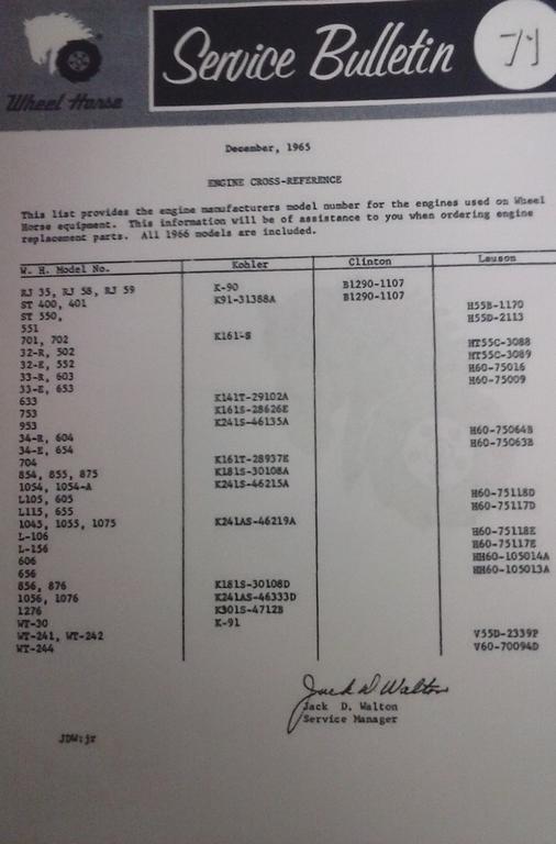

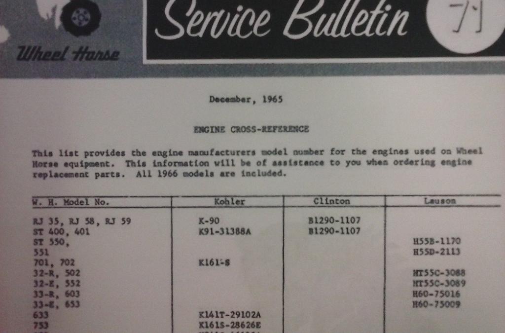

76c12091520h 4,189 #23 Posted May 8, 2019 Thanks to everyone for all the feedback, now that I know what to look for, the differences in the models are obvious, it was just something that was out of my comfort zone. I will be tracking down the missing parts over the next year to begin the restoration after I'm done with my 520. As far as that Clinton engine goes, never say never. While there is no way to prove beyond a shadow of a doubt that it's the engine it was born with, it certainly could be and having spent the last 4 days researching and looking at it I have no doubt it is. See attached: I'm sure 50+ yrs ago when these were built they were using whatever parts they had available at the time they came down the line, whether that was a Kohler, Lawson, Clinton, etc. 3 Share this post Link to post Share on other sites

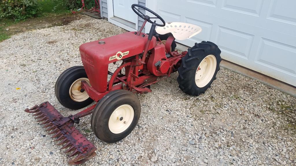

oldiron613 590 #24 Posted August 6, 2019 Here is a picture of my Wheel Horse 401 model powered by a Clinton 1290; very similar to yours. I recently saw another at the Garden Tractor Daze show in Portage, WI last month that was configured exactly the same, without fenders which makes me think this configuration may have been the "budget 401" at the time. It's an oddity, but there's certainly a few of them out there. I notice too, that the engine serial number on mine is very close to yours as well. 3 2 Share this post Link to post Share on other sites
