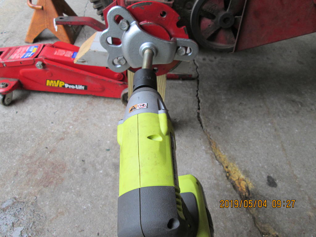

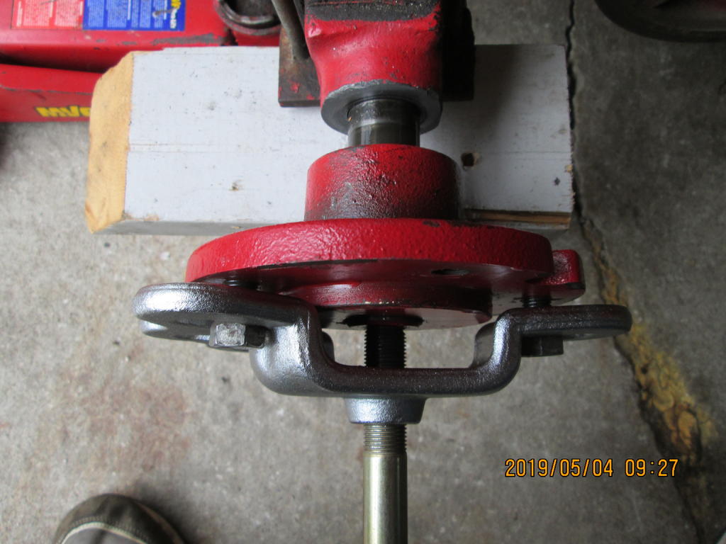

Retired Wrencher 6,977 #1 Posted May 4, 2019 This next one is a rusted sold on the axel and off the key way. Lots of Breakaway. So it will take a few days to keep spraying in the set hole to free up. Then I think I am done with the B80 8. Easy liven in the Summer time. 5 3 1 Share this post Link to post Share on other sites

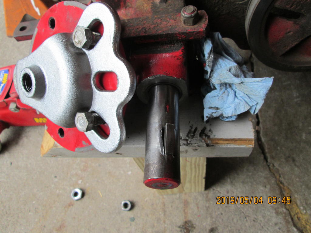

Retired Wrencher 6,977 #4 Posted May 5, 2019 13 hours ago, ebinmaine said: Excellent sir. Eric the next one is going to take a while. Lots of Breakaway and heat= Map gas. That one has to move about an 1" so I can get on the Key way. Share this post Link to post Share on other sites
ebinmaine 80,600 #5 Posted May 5, 2019 5 minutes ago, Retierd Wrencher said: Eric the next one is going to take a while. Lots of Breakaway and heat= Map gas. That one has to move about an 1" so I can get on the Key way. No worries Gary. It may already be on the Inside of the key. You'll get it. Did you remove the set screw so as to get penetrating oil in there? Heat, repeat, Etc... It'll go. Are you adding another set screw? Share this post Link to post Share on other sites
Retired Wrencher 6,977 #6 Posted May 5, 2019 (edited) Yes after I got the first one done. I started on the next. I had to put on small step blocks = DRILLING for spacers because this one is worse that the other one. So I will give it most of the day with the breakaway.Thanks for the post. I think once I get on the Key way I will use lock tight on it. Edited May 5, 2019 by Retierd Wrencher Share this post Link to post Share on other sites
ericj 1,580 #7 Posted May 5, 2019 where did you get that puller, I haven't seen one of them before. Looks like it should work, if it's heavy enough to pull a really stuck one. eric j Share this post Link to post Share on other sites
Retired Wrencher 6,977 #8 Posted May 6, 2019 22 hours ago, ericj said: where did you get that puller, I haven't seen one of them before. Looks like it should work, if it's heavy enough to pull a really stuck one. eric j Eric . At an auto parts store. The second is taking a while to loosen only using Map gas. But not in a hurry. 1 Share this post Link to post Share on other sites

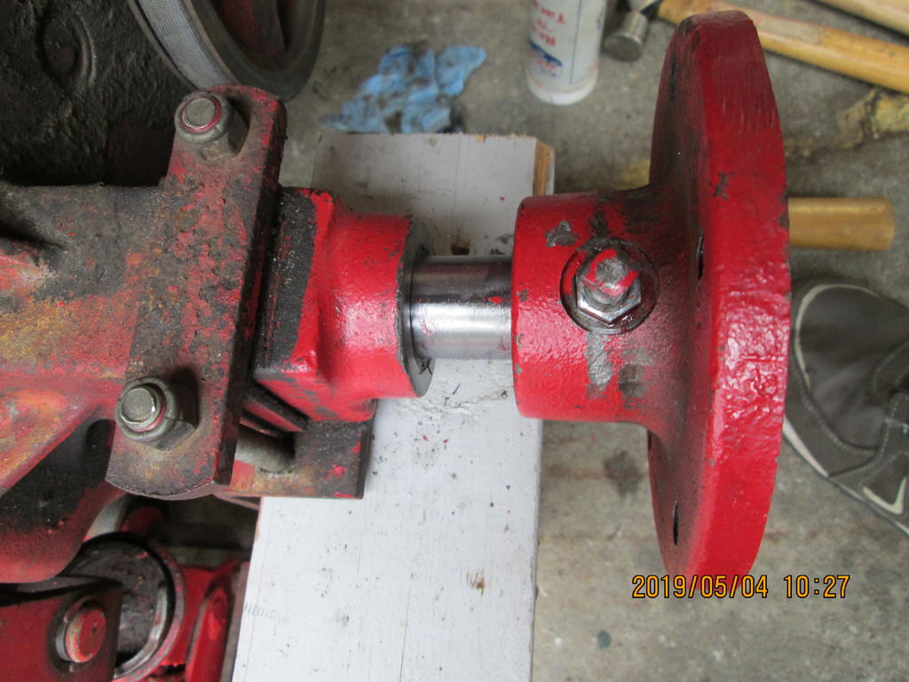

Pollack Pete 2,273 #9 Posted May 6, 2019 Hope you used Never-Seeze on the axle before you put the hub back on.Makes them come off lots easier in 10 or 20 years.What auto store did you buy the puller? Share this post Link to post Share on other sites
ZXT 2,402 #10 Posted May 6, 2019 51 minutes ago, Pollack Pete said: Hope you used Never-Seeze on the axle before you put the hub back on.Makes them come off lots easier in 10 or 20 years.What auto store did you buy the puller? I've seen that puller on the shelf at either Oreilly's or AutoZone. Can't remember which though. Share this post Link to post Share on other sites
Retired Wrencher 6,977 #11 Posted May 6, 2019 11 hours ago, Pollack Pete said: Hope you used Never-Seeze on the axle before you put the hub back on.Makes them come off lots easier in 10 or 20 years.What auto store did you buy the puller? Pete I wont be around in 20 years. It will be for the next owner. Share this post Link to post Share on other sites
Retired Wrencher 6,977 #12 Posted May 6, 2019 10 hours ago, ZXT said: I've seen that puller on the shelf at either Oreilly's or AutoZone. Can't remember which though. CARQUEST. About $100. I have seen cheaper on the net. But I needed it that day so>>>>> 1 Share this post Link to post Share on other sites
