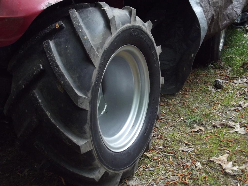

JAinVA 4,638 #3 Posted May 4, 2019 (edited) They can be mounted on the 7.5" width rim.I bought a set of Carlisles that size that were mounted on 7.5" rims but they looked wrong.I mounted them on 8.5" 520 rims and they look great. Edited May 4, 2019 by JAinVA 1 Share this post Link to post Share on other sites

JAinVA 4,638 #7 Posted May 4, 2019 (edited) Those Deestones look fine on a 7.5".The same size Carlilses look cartoonish on 7.5"Here they are on 8.5" rims. Edited May 4, 2019 by JAinVA 1 Share this post Link to post Share on other sites
