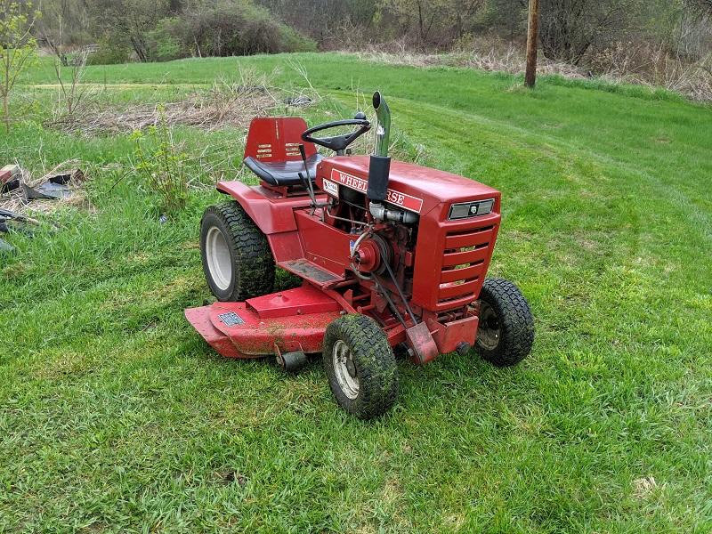

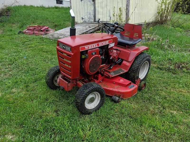

WildmanC120 615 #1 Posted May 4, 2019 (edited) I just moved into my new house (First House) about a month ago now. I now have 3.1 acres all of my own to do as I wish with and it feels awesome. I figured it was also time to use my C-160 I picked up last year and never used. It needed a good servicing and some little things fixed on it but all in all its in great shape and runs amazing. The 36 and 42" decks I have were not gonna "cut it" so last weekend I was able to score a super clean 48" deck to put on this tractor. I gotta say I am super thrilled with how well this tractor handles the 48" deck. It has done nothing but rain here and the grass was thick and over my ankles. This thing had no problem with it and made it look easy. C-160 Running Edited May 4, 2019 by WildmanC120 2 12 1 Share this post Link to post Share on other sites

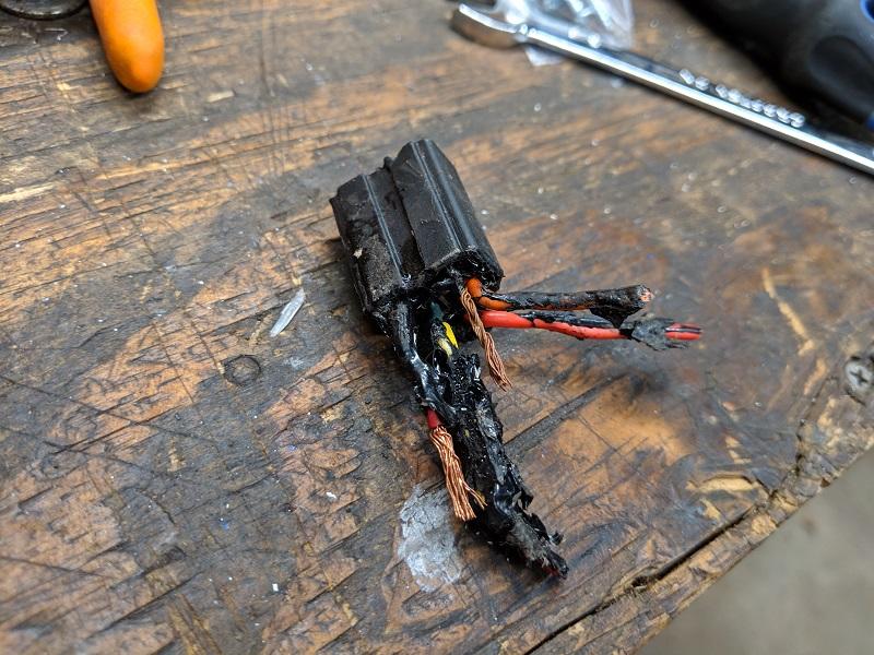

Razorback 1,370 #2 Posted May 4, 2019 Congratulations on the new house and land! What a great feeling! And, I hope you enjoy your C160 as much as I do mine! I’d love to find a 48” deck for mine to help with our acre lot. Man, if I could do that, I could cut my GT family down a bit. I keep a newer Craftsman GT with it’s 54” deck just for mowing. Where was that connector you pictured? 1 Share this post Link to post Share on other sites
ohiofarmer 3,529 #3 Posted May 4, 2019 4 hours ago, Razorback said: Congratulations on the new house and land! What a great feeling! And, I hope you enjoy your C160 as much as I do mine! I’d love to find a 48” deck for mine to help with our acre lot. Man, if I could do that, I could cut my GT family down a bit. I keep a newer Craftsman GT with it’s 54” deck just for mowing. Where was that connector you pictured? Looks like the connector for the ignition key assembly. Anyway, that is a good first house that just needs one other thing--a nice big shop for the C-160 and all the other horses sure to follow. 1 1 Share this post Link to post Share on other sites
WildmanC120 615 #4 Posted May 4, 2019 6 hours ago, Razorback said: Congratulations on the new house and land! What a great feeling! And, I hope you enjoy your C160 as much as I do mine! I’d love to find a 48” deck for mine to help with our acre lot. Man, if I could do that, I could cut my GT family down a bit. I keep a newer Craftsman GT with it’s 54” deck just for mowing. Where was that connector you pictured? That was the old 5 pin for the ignition switch. IDK who touched this tractor last but they did a terrible job fixing wiring haha. Share this post Link to post Share on other sites

peter lena 10,109 #6 Posted May 4, 2019 hello wildmanc120, don,t know what you did to correct that wiring issue, but both the correct switch and 5 point plug in harness are available on line for about 20 $ . my experience with horse wiring is to replace the bad with new , secure solid grounds , use dielectric grease on your connections , for connectivity and corrosion resistance. if that was the major issue had , consider yourself lucky and make sure you detail your baseline service , that will help ensure your tractor running well. pete Share this post Link to post Share on other sites
WildmanC120 615 #7 Posted May 4, 2019 6 hours ago, peter lena said: hello wildmanc120, don,t know what you did to correct that wiring issue, but both the correct switch and 5 point plug in harness are available on line for about 20 $ . my experience with horse wiring is to replace the bad with new , secure solid grounds , use dielectric grease on your connections , for connectivity and corrosion resistance. if that was the major issue had , consider yourself lucky and make sure you detail your baseline service , that will help ensure your tractor running well. pete All I ended up doing was get a new plug and spliced in to the existing wiring. Fixed some cob jobs along the way and back to usable condition. 1 Share this post Link to post Share on other sites

ohiofarmer 3,529 #13 Posted May 8, 2019 Those 5 pin switches can be a bit confusing. mine has 4 positions OFF /remove key IGN+ accessory, IGN without accessory, and Start . What does make sense to me is that the two terminals farthest away from the Start [solenoid] lug share continuity with that lug with the key pulled in OFF position. You would think that none of the switch terminals would share continuity with the key removed. So that leaves only two other switch lugs for the power to the switch..And I assume the other terminal is either the accessory or more likely the coil wire. Why Wheel Horse put no markings on the thing is beyond me. So I looked on the electrical info right here on Redsquare, and there it is..It confirmed that I was on the right track..A big thank you to 953Nut 1 Share this post Link to post Share on other sites
