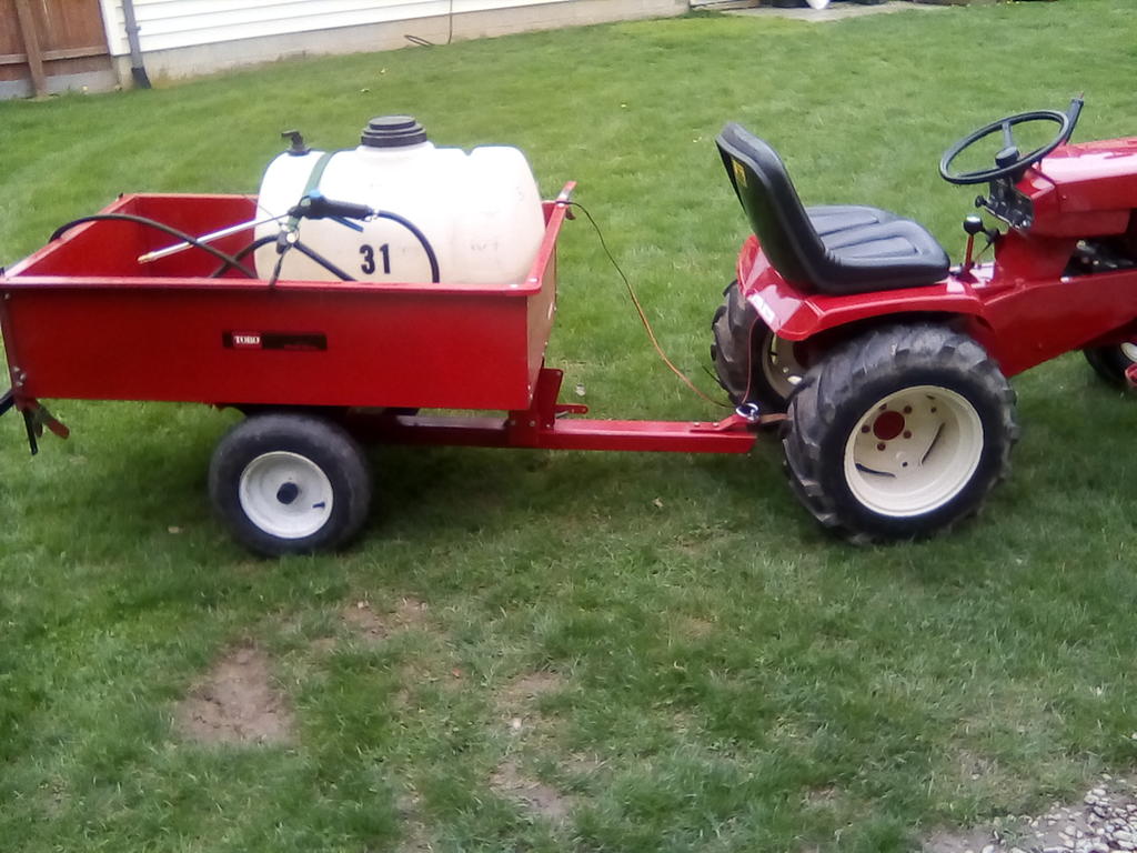

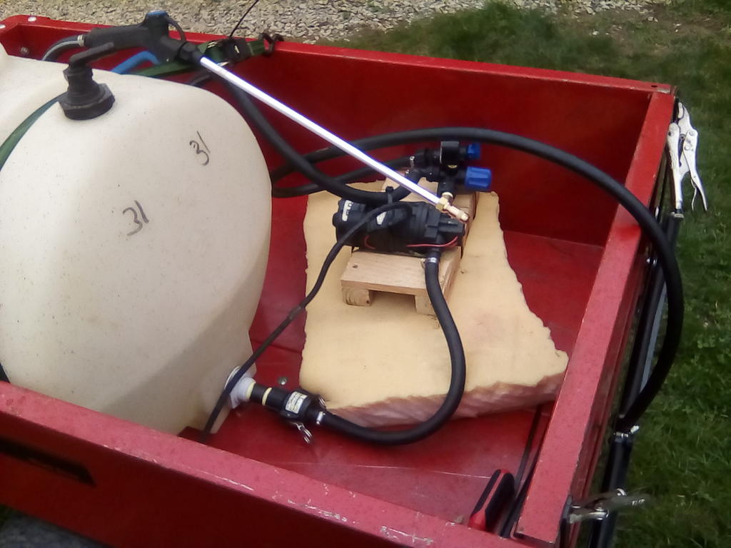

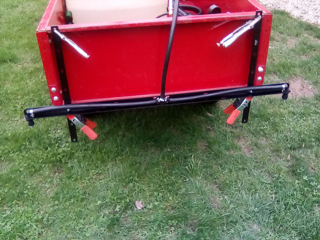

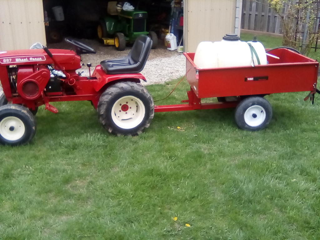

briankd 833 #1 Posted May 2, 2019 been wanting a sprayer to spray my 3/4 acre yard for some time now .looked at the ones that TSC has but couldn't justify the price . my dad b ought one years ago and for what they are they are cheaply made . my dad got this 35 gallon tank and 2.1 gpm pump from the county hwy. dept. when he retired they decomisioned his old plow truck they used this tank and pump to spray additive onto the salt as it come out the back of truck. he gave it to me couple yrs ago and i finaly built me a sprayer . was in rural king couple week ago and they had a spray boom kit for fifty bucks included boom nozzles hose preasure regulator manafold what a deal that was buy it all seperate for 3 times that amont. I've got about 70 bucks in this setup and it sprays 7 foot swath just as good or better than the 300 dollar ones you buy at TSC. 7 4 1 Share this post Link to post Share on other sites

Pullstart 71,104 #4 Posted May 3, 2019 The guy I picked up the Commando 6 from recently used a 4 prong trailer wire harness on his tractors for using a sprayer. I’m not sure how you wired it, or if this is a dedicated spray rig, but that might come in handy. Great work, I bet yours will last longer too! Share this post Link to post Share on other sites

briankd 833 #7 Posted May 4, 2019 (edited) 13 hours ago, pullstart said: The guy I picked up the Commando 6 from recently used a 4 prong trailer wire harness on his tractors for using a sprayer. I’m not sure how you wired it, or if this is a dedicated spray rig, but that might come in handy. Great work, I bet yours will last longer too! what i like about this setup is it all comes apart easy and easy to store not like the complete ones you buy i still just use the trailer for hauling stuff the boom kit came with a two prong quick conector like a 4 prong trailer connector i happen to have one laying around Edited May 4, 2019 by briankd Share this post Link to post Share on other sites
