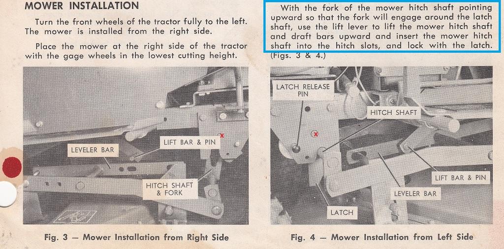

gwest_ca-(File Mod) 12,455 #2 Posted May 2, 2019 Welcome to the forum. This manual is most likely not the model/year you have but the attachment process is identical. Click on the fuzzy picture Garry 1 Share this post Link to post Share on other sites

lt4jim 1 #12 Posted May 2, 2019 Thanks to all for the suggestions. I reviewed the instruction manual to make sure I was mounting the deck correctly, removed the deck and lift arm to check everything again. Lift arm looked OK but I did find that the bar with the lift slot on the deck itself was slightly bent. I don't think it would be enough to have it fall off on rough ground but could happen. Since I had the lift assembly out, I drilled the lift pin so I could add a washer and hairpin clip. I'm sure that will take care of it. Thanks again for the help. Jim Share this post Link to post Share on other sites

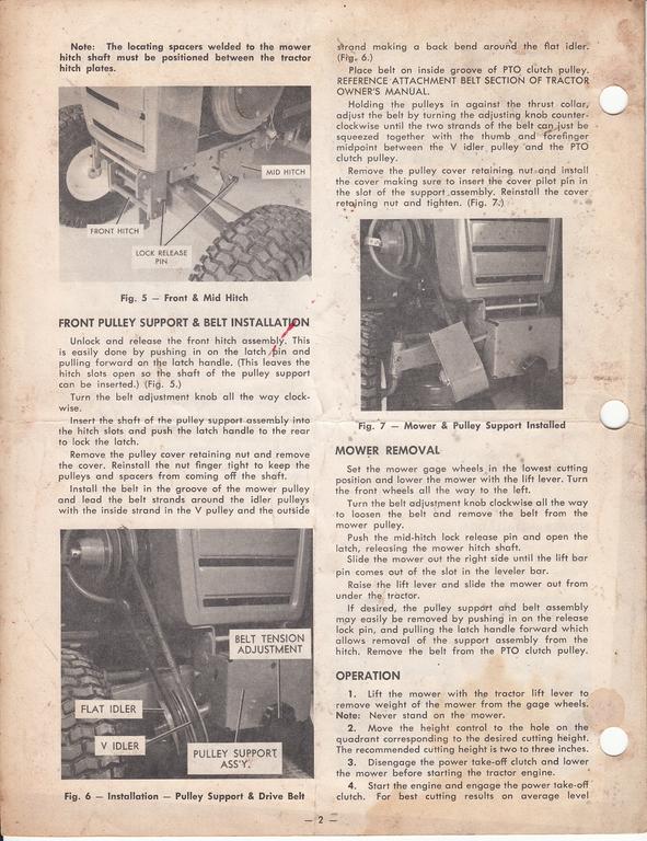

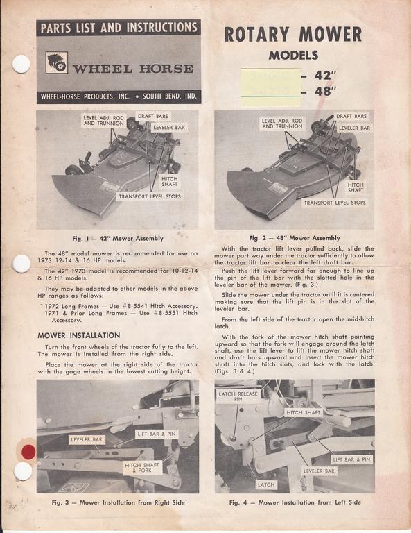

daveoman1966 3,884 #14 Posted May 2, 2019 The mid Tach-o-Matic hitch is spring-loaded to lock the lever in place...should NOT need that little clevis pin at all. (1) Be sure you have the FORK on that lever in the correct position so as to engage the upper pin...that's what keeps the deck from slopping forward / back and Left to Right. (2) That mid hitch MUST have the spring on it to work right. If not, the lever will NOT lock into position. The pages here are for a 48" deck...but are the same for 42" and other decks. 1 Share this post Link to post Share on other sites
