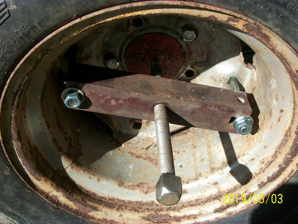

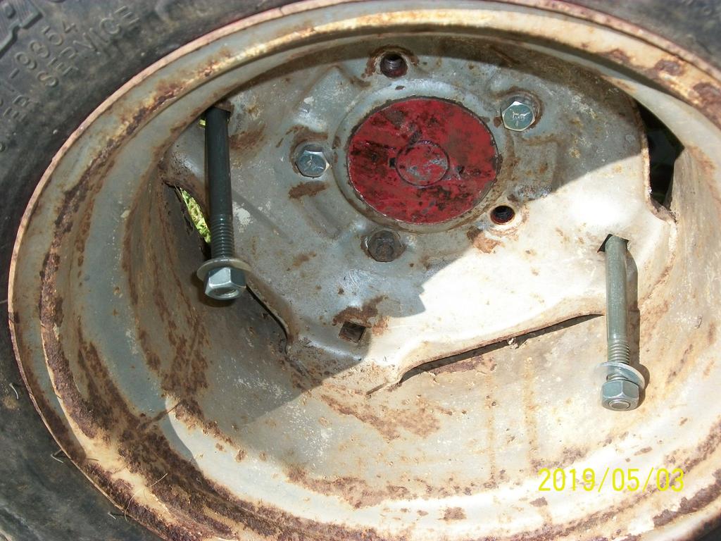

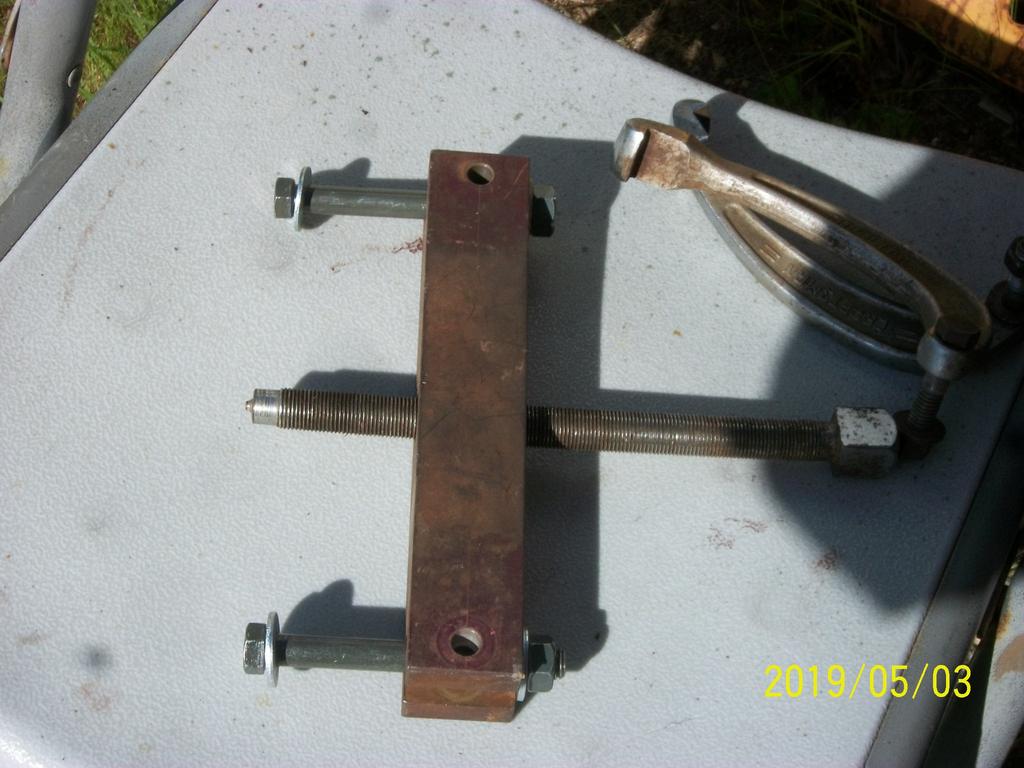

don 76 wheel horse 24 #1 Posted May 2, 2019 This is some info for stack on rims. After almost a year trying to take off stuck on rims. Using P-B Blaster large rubber mallet time and time again. Also tried numerous pullers nothing. One suggestion was driving with loose bolts turning quickly. I finally found a 8 inch old style craftsman puller. That i added 2 bolts through the rim. I also left 2 loose bolts so everything would not fly apart. Well in a few minutes a very loud pop and rim and tire off. worked 3 1 Share this post Link to post Share on other sites

adsm08 4,155 #5 Posted May 2, 2019 3 hours ago, pullstart said: Wow. I can’t imagine those being so rusted, they look pretty clean! It doesn't take much. It's actually a very large surface area. I once spent 10 minutes smacking a single rim off a 1 year old, 10,000 mile F-150, and the wheel was still on there when I quit to go get my face stitched up where the deadblow caught me on the flyback. 1 Share this post Link to post Share on other sites
