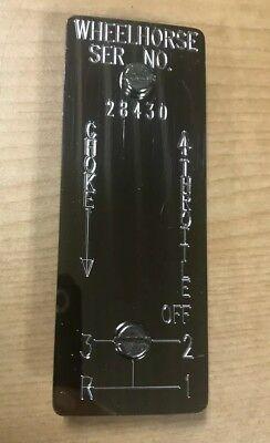

oliver2-44 11,716 #8 Posted May 2, 2019 That's a nice looking Suburban. Does it have a serial number on the aluminum plate below the steering wheel. This picture is of a a reproduction plate.. Share this post Link to post Share on other sites
Hurley1 27 #9 Posted May 2, 2019 Yes. I do plan on mowing with it. And in style to! i plan on saving the belts ..they have the logo and part number on them. Oliver2-44 no mine doesn’t have a number as I can see. just wondering. What would be a fair price for a tractor in all original condition Like this one? after I get off of work today I’ll post a couple of pics I have questions about. thanks guys Share this post Link to post Share on other sites

oliver2-44 11,716 #12 Posted May 2, 2019 7 hours ago, Hurley1 said: Oliver2-44 no mine doesn’t have a number as I can see. If you have that plate, I'm betting theirs a serial number on it. I have a plate that was rusted, but after sanding I can just read the numbers with a light on it. Sand/polish the area the number should be in with very fine wet/dry sand paper. The original WH number was a light stamping. It's numbering was not near as deep as the reproduction one that appears to have numbers machined on a CNC machine. Share this post Link to post Share on other sites
