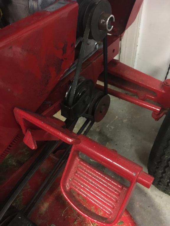

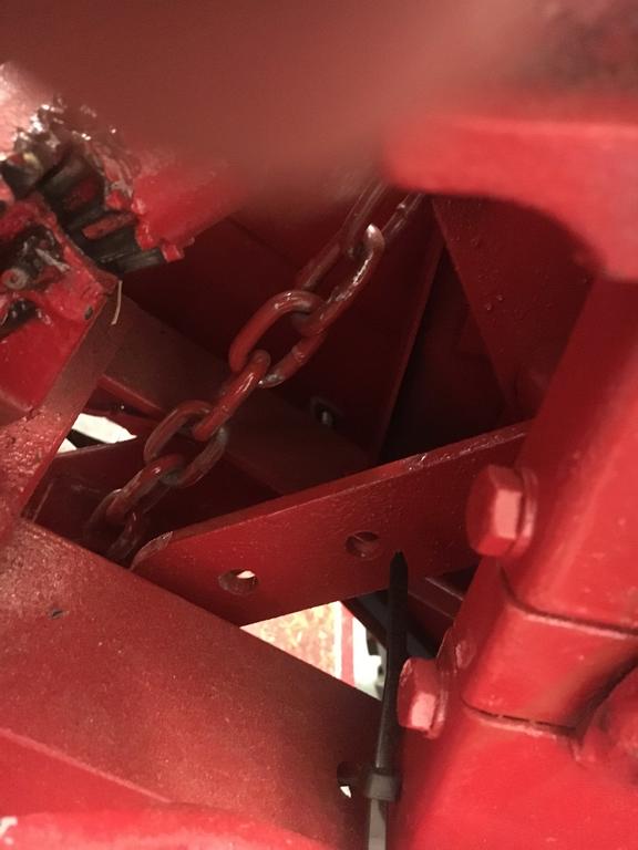

WH656 9 #1 Posted May 1, 2019 (edited) Hi guys, See the chain in the image? Now look beside it and you see a second bar thingy with holes in it.. Is that sposed to have a chain on it too?? I think it should because that might help reel that mower deck in away from the rear tire in the other pick. Is that how it should work? Edited May 1, 2019 by WH656 Share this post Link to post Share on other sites

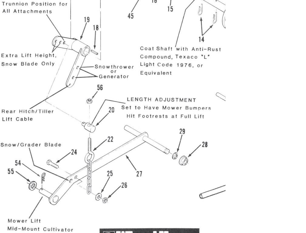

gwest_ca-(File Mod) 12,511 #2 Posted May 1, 2019 That 2nd bar is for the cable that lifts attachments at the rear of the tractor and for the snowthrower or generator mounted at the front Garry. 1 Share this post Link to post Share on other sites
gwest_ca-(File Mod) 12,511 #3 Posted May 1, 2019 Mower manual. Click on the fuzzy picture Garry Share this post Link to post Share on other sites

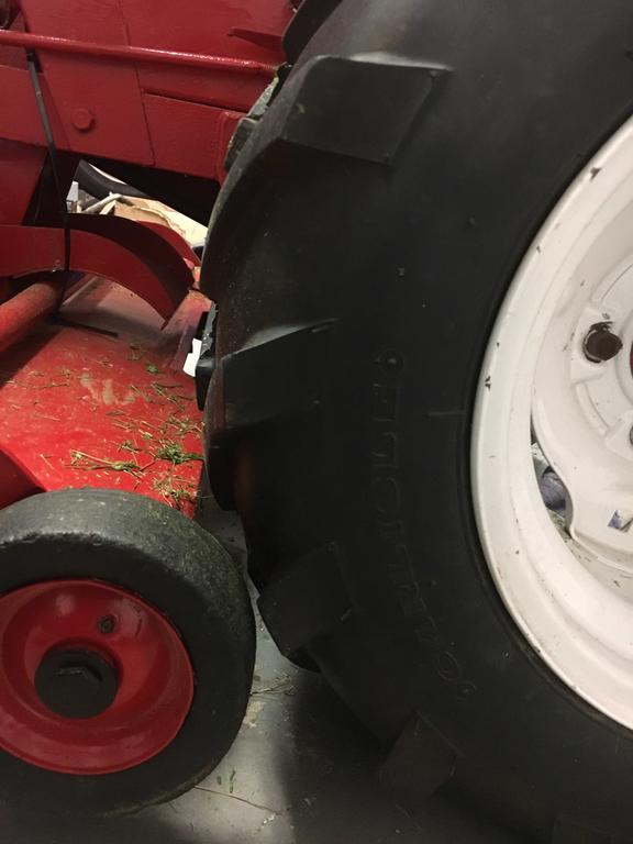

953 nut 69,827 #4 Posted May 1, 2019 5 hours ago, WH656 said: might help reel that mower deck in away from the rear tire Those nice new tires might be a bit larger than the tires that came on your . Did you have this problem before? Share this post Link to post Share on other sites
Pullstart 71,372 #5 Posted May 1, 2019 The chain is on the lifting link, the open link is for pulling a cable forward, essentially lifting rear implements like a plow or tiller. Is is there any side to side movement? It seems like on my 502 deck the belt tension adjustment slides the deck forward and backward. Possibly a shorter belt could allow you to move the deck forward... 1 Share this post Link to post Share on other sites

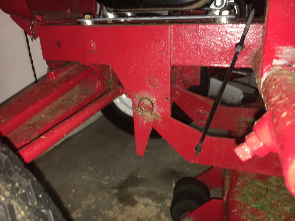

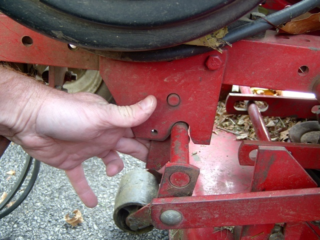

stevasaurus 23,857 #7 Posted May 1, 2019 Look at the drawing that Garry posted in the deck manual, you will see what is called a "quick attach" mechanism. The front of your deck goes into the piece. This is where the deck gets pulled from and the chain just allows you to lift the deck when not mowing. There should be "fins" that rise up under the frame and inside the frame so the deck follows the horse...they keep the deck from going side to side. That quick attach will keep the deck in place and away from your rear tires. Below is a picture from Karl showing the quick attach on a newer horse. Yours will look similar and you can see where the front of your deck fits into that notch. An arm swings down and locks the deck in place. A hair pin locks the arm in place. You need to make sure the deck is in the notch on both sides of the horse. 1 1 Share this post Link to post Share on other sites

WH656 9 #9 Posted May 1, 2019 (edited) Ok, I will take a look at the "quick attach" mechanism when I get back. Thanks. If I recall it is a bit loose there with a GAP. #scratch-head. Tool Crib I just bought this mower, I havent even mowed hardly at all , let alone hit a stump unless PO did. :/ Everything looked even to me. BUT it seems to have a lot of play in it. Edited May 1, 2019 by WH656 Share this post Link to post Share on other sites
gwest_ca-(File Mod) 12,511 #10 Posted May 1, 2019 I am wondering if the double belts are worn too much or the wrong ones. Item 33 bolt in the parts list is what adjusts the double belt tension and appears to move the mower deck back to tension the belts. The part number of 33 in the list is 960200-4 and in the instructions it is 160200-4 - paragraph 2 on page 2. Garry 1 Share this post Link to post Share on other sites
oliver2-44 11,782 #11 Posted May 1, 2019 As mentioned by 953, the rear tires might be part of the problem. Please post the size of those tires to help us confirm or rule them out. Maybe I missed it, but what tractor is this on? Share this post Link to post Share on other sites
The Tuul Crib 7,354 #12 Posted May 1, 2019 (edited) If the new tires are 23’s shouldn’t they be the same size as the old 23’s ? Edited May 1, 2019 by The Tool Crib Share this post Link to post Share on other sites

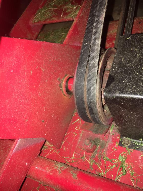

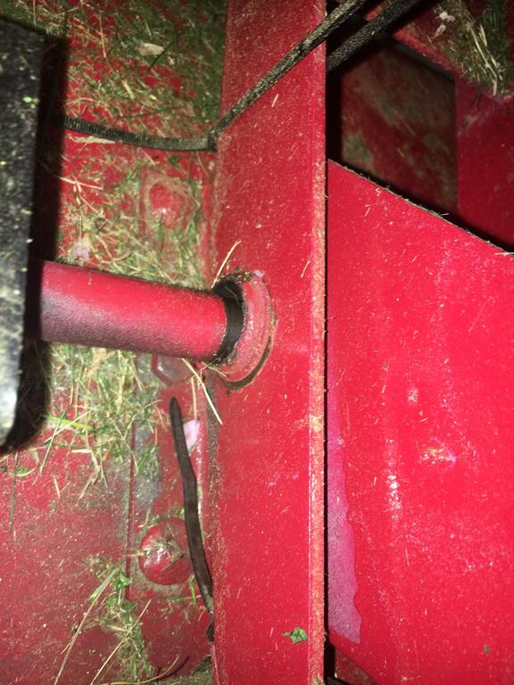

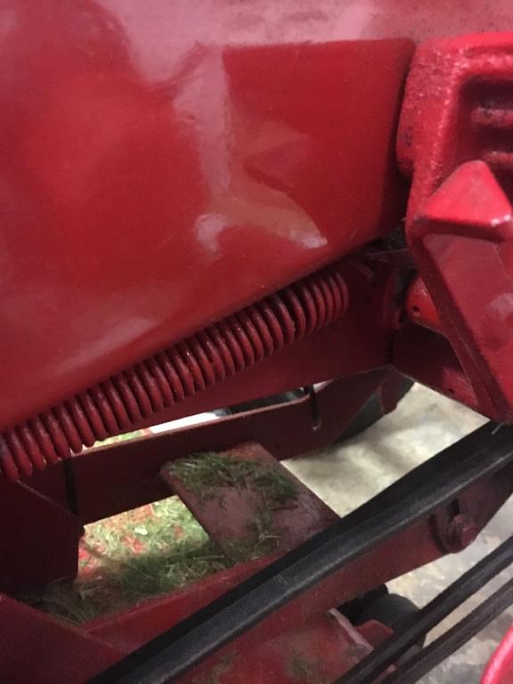

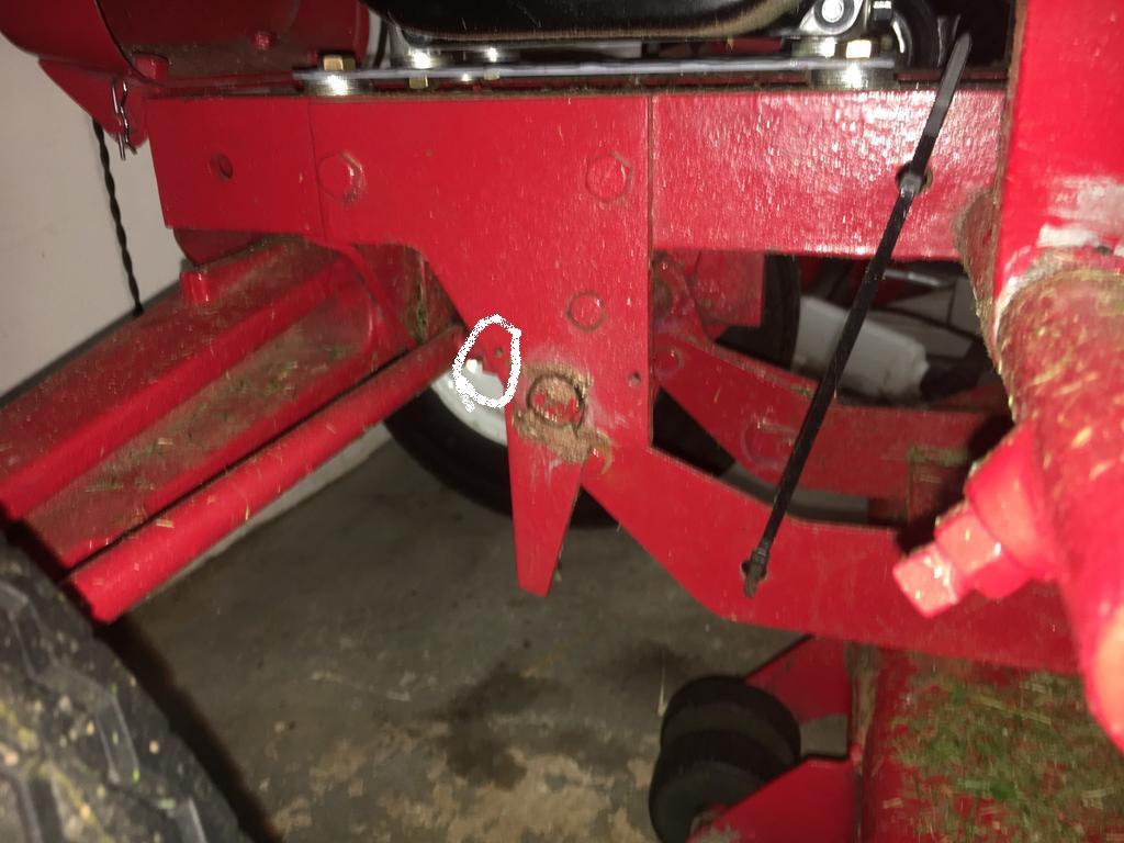

WH656 9 #13 Posted May 1, 2019 (edited) Sure guys, they are 23" tires, 656. One of the deck belts is loose as a goose and the other one.. slightly loose. If I tighten them with my finger, the deck seems to move more toward the tire. :/ BTW as I am mowing heavier grass I noticed the drive belt to the blade slowing down to a near stop too! But it doesnt feel loose.. but that must be too! Notice the shredded rubber left of pulley and belt! And wondering if spring in the pic is ok.. Trying to give as much info.. see the grass? its having hard time cuttin it now. ^those are stones there, not water. I added some more pics.. almost looks like those spindle things should have a bushing or something but I cant tell if its there or not. The quick latch is tight only bc I zip tied it or it would have a gap.. Edited May 2, 2019 by WH656 Share this post Link to post Share on other sites

WH656 9 #15 Posted May 2, 2019 Wait are you saying that second metal thing with the holes actually should attach? If so that would make sense because I cant understand why the deck leans down and back on the .. dr side. Share this post Link to post Share on other sites
stevasaurus 23,857 #16 Posted May 2, 2019 The hole circled in white is where a hair pin would go to keep the quick attach closed. These decks (rear discharge) are really not the greatest in long grass. I sometimes have to raise the deck up and cut and then go back with the deck down. Another option that works good is to cut the grass while in reverse...you kind of get a mulching action then. If you are cutting around 2" of grass , you should get an excellent cut. Of course, the speed of the blades will make a difference. Underside of deck clean, sharpened blades, greased spindles, tight belts & good oiled pulleys will make a difference. Your engine should be topped out at about 3600 RPMs also. You do have the deck attached correctly in the quick attach thingy. The holes may be wallowed out a little, but that should not make that much difference. The tires on my deck (same as yours) are 5 1/2" dia. and I have about 2" clearance between the deck wheels and the rear tires. 1 Share this post Link to post Share on other sites
