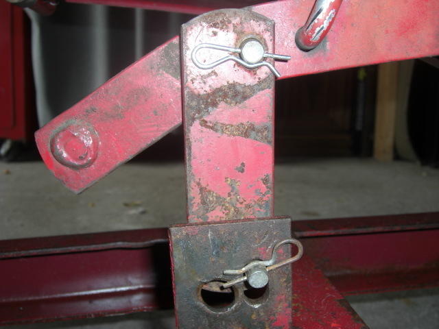

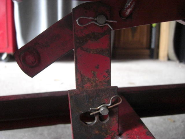

Retired Wrencher 6,922 #1 Posted April 30, 2019 Hi This goes between the lift arm on tractor and the plow with pins and clips. Does any one have the dimensions this part ? would like to make one up. Should not be that difficult to make. I do not like the chain set up on it now. Thanks in advance. Share this post Link to post Share on other sites
ebinmaine 80,325 #2 Posted April 30, 2019 Gary I've got one on the plow that I use for my B and C series tractors. I can measure it for sure when I get home but I feel like it's made out of steel that's about 1 1/4 or 1 1/2 in wide. 1/8 in or 3/16" thick would be fine. Total length is 11.25 and the pin Center is somewhere around 10 or 10 .25. 1 Share this post Link to post Share on other sites

gwest_ca-(File Mod) 12,457 #4 Posted April 30, 2019 Would it be a little over 5" long with the holes centered on about 4"? https://www.partstree.com/parts/toro/parts/105052/ Garry Found this. Click on the drawing. 2 Share this post Link to post Share on other sites

Retired Wrencher 6,922 #9 Posted May 1, 2019 Eric is this the part? Just need length of part and distance between holes Thanks. Share this post Link to post Share on other sites
ebinmaine 80,325 #10 Posted May 1, 2019 8 minutes ago, Retierd Wrencher said: Eric is this the part? Just need length of part and distance between holes Thanks. Gary, mine is the longer one. That one looks more like Garry above is describing. 5.5 inches maybe. I'd go by the blueprint for the shorter of the two that he posted. The one I have is for a slightly different setup and does not use the horizontal bar such as in that picture. It goes directly up to the lift lever. Share this post Link to post Share on other sites
Retired Wrencher 6,922 #11 Posted May 1, 2019 2 minutes ago, ebinmaine said: Gary, mine is the longer one. That one looks more like Garry above is describing. 5.5 inches maybe. I'd go by the blueprint for the shorter of the two that he posted. The one I have is for a slightly different setup and does not use the horizontal bar such as in that picture. It goes directly up to the lift lever. Ok thanks Eric. Share this post Link to post Share on other sites
gwest_ca-(File Mod) 12,457 #12 Posted May 1, 2019 This photo is of the short link on a 1" square grid. https://www.partstree.com/parts/toro/parts/105052/ If you click on the drawing above it will take you to another picture of how they are used. Garry Share this post Link to post Share on other sites
Retired Wrencher 6,922 #13 Posted May 1, 2019 (edited) 3 minutes ago, gwest_ca said: This photo is of the short link on a 1" square grid. https://www.partstree.com/parts/toro/parts/105052/ If you click on the drawing above it will take you to another picture of how they are used. Garry Thanks Garry. I see it now in the drawing . Need more coffee. Edited May 1, 2019 by Retierd Wrencher Share this post Link to post Share on other sites
