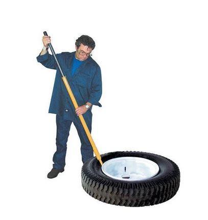

pfrederi 21,268 #17 Posted August 12, 2019 39 minutes ago, Lee1977 said: I use a simular method to brake beads and have had one i could not get loose. It was a 8" two ply that had been glued on. I cut the tire off and cut the bead with a side grinder. was also hard to to sand the glue off the rim. I use one like this Share this post Link to post Share on other sites
