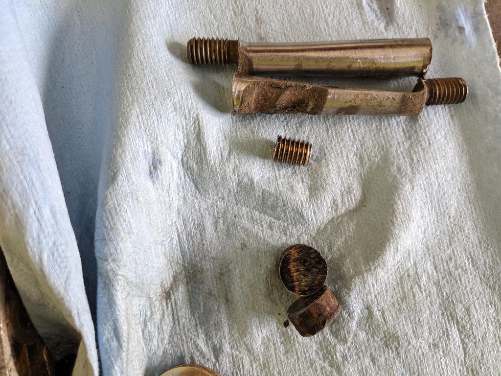

Rxracer 12 #51 Posted May 12, 2019 I will have to download the manual and try to set it up. Because one of the adjustment pins came out of the anti scalp wheel and I didnt notice is. Next thing I know I buzzed my lawn short and crooked lol Share this post Link to post Share on other sites

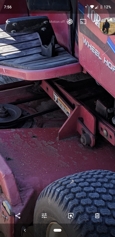

Rxracer 12 #52 Posted May 13, 2019 Found that the deck has some missing hardware. And the j pins we're wore pretty bad. Going to pull the deck and weld up the j pins to get material built back up. It was missing the scissor bolt on the left side of the deck. So guess I got more work ahead of me. You can see the missing bolt in the pic. I ordered the spacer so waiting for that to show up. Share this post Link to post Share on other sites

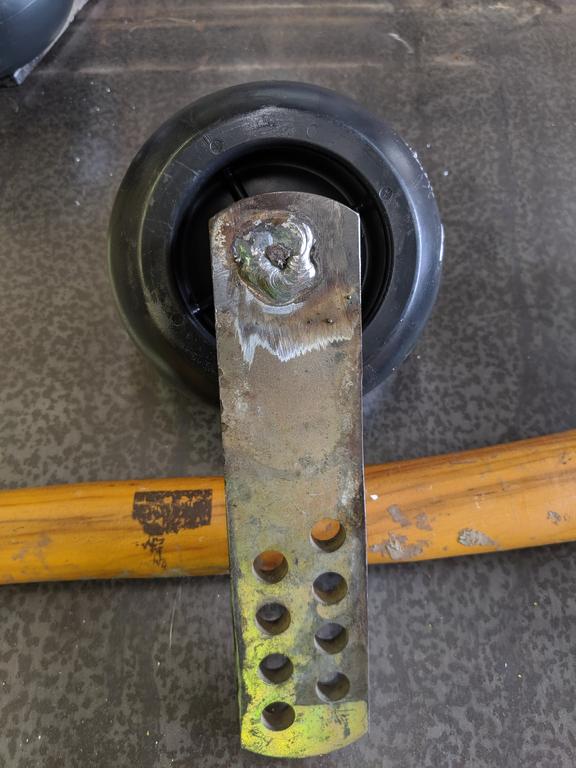

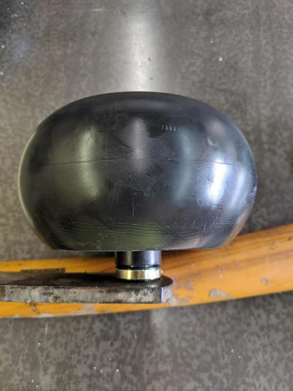

Rxracer 12 #53 Posted May 14, 2019 Anti scrub wheels all fixed up. The kit ordered worked really well. Ground the weld off the back, knocked the old axle out, put the head of the 3/8 in the old axle hole, did 6010 on the front and 7018 on the back. Should be as strong as before. 2 Share this post Link to post Share on other sites
