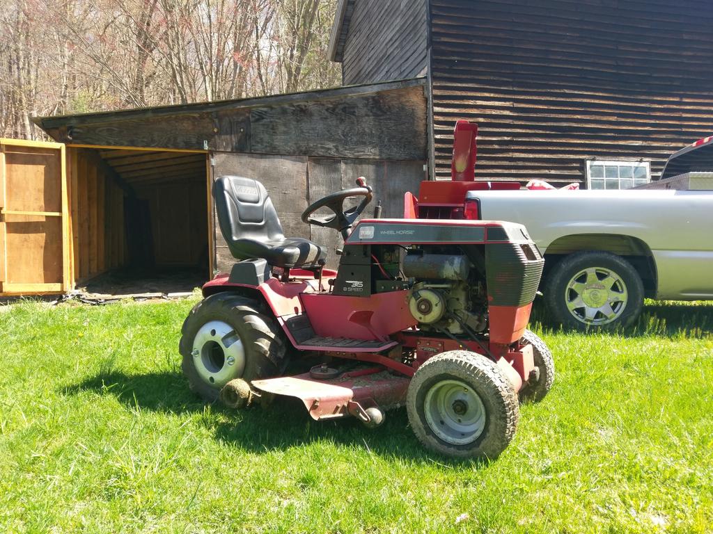

Stepney 2,356 #1 Posted April 26, 2019 (edited) Hello, all. Well, sadly the low hours appearing WorkHorse GT1848 I picked up has a pretty nasty rap. When I bought it, I figured it had acorns in the shroud.. alas, I was moving it just 3' ahead of it's spot in my shed the other day to prepare to pull the engine out, and once it fired up, it made a pretty sharp 'clang' and was now running on 1cyl.. bad suspicion she dropped a rod, doesn't sound like a valve seat to me. Anyway, I've rebuilt my share of older small engines, and a few K series. But never a Briggs post 1950. Can't even really find talk about anyone doing such a thing. I've found all the gaskets/seals, valves, and pistons online, but no luck with rods yet. Anyway, being as WH used these 16 and 18hp oppy's in the WorkHorse and I think there was an actual WH with one? Has anyone here ever rebuilt one? I have a 16hp and a 10hp K series on hand, but I would like to keep a nice smooth twin in it if I could manage to get it going. Of course, I have to tear it down and see the damage, it could be past saving now .. but who knows? Anyway. Has anyone here ever rebuilt an old Boxer Briggs? This one is an 18hp iron liner engine, of the 42ci variety. Edited April 26, 2019 by Stepney 1 Share this post Link to post Share on other sites

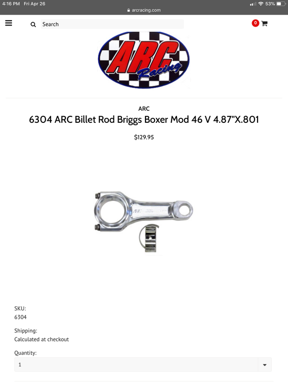

Achto 32,119 #7 Posted April 26, 2019 2 hours ago, Stepney said: but no luck with rods yet Looks like you will definitely need to know your model # before ordering but here is a link. You may want to check out their prices on the rebuild kit too, $7.95 shipping no matter how much you order. http://www.psep.biz/store/briggs_stratton_connecting_rods.htm Share this post Link to post Share on other sites

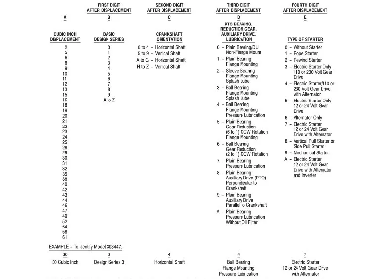

bds1984 1,514 #12 Posted May 28, 2019 (edited) I vote for rebuilding it. I rebuilt a vertical shaft, 18hp twin in high school which wasn't a big deal at all. For me it was the equivalent of two singles that shared one camshaft. IF you are searching for a block, any 18 HP block should work. I have come across many (mostly in 80s Craftsman GTs) and they have the necessary PTO bearing for a WH application. Or you can just use this chart to compare a potential engine you find: For the third digit after the displacement number, look for a 3 or 4. By far most of what I have came across is the 3 for bearing code. I believe I can count on one finger how many horizontal shaft Briggs with pressure lube I have seen; plenty of verticals, but few horizontals. They really are a decent engine if they're maintained but unfortunately many Briggs opposed twins were put into cheap mowers bought by cheap owners which in turn gives them that reputation. On a side note, a finely tuned big Briggs opposed twin sure does sound sweet under load at full throttle! Edited May 28, 2019 by bds1984 duplicate pic Share this post Link to post Share on other sites
