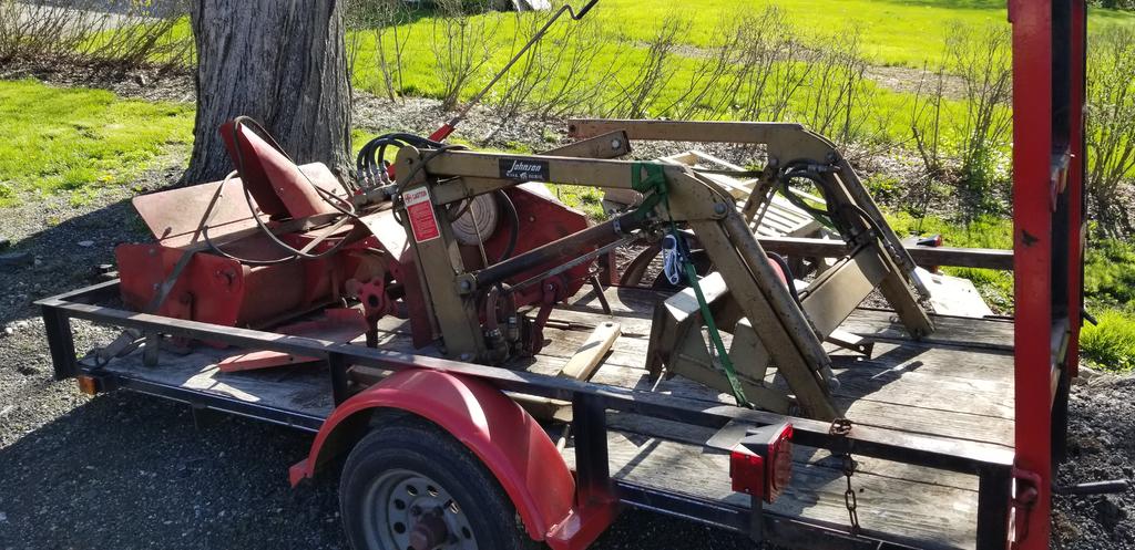

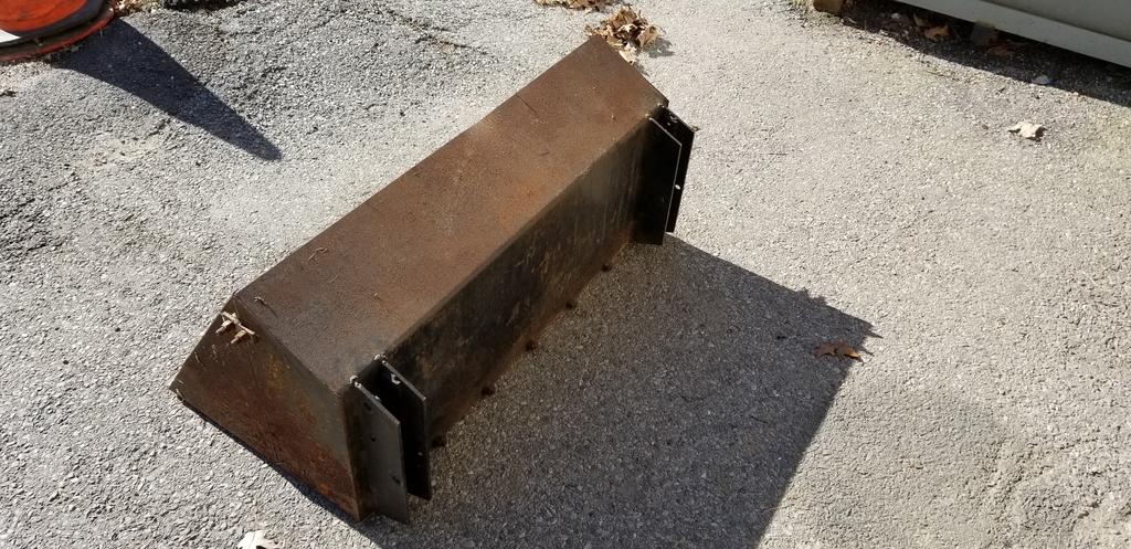

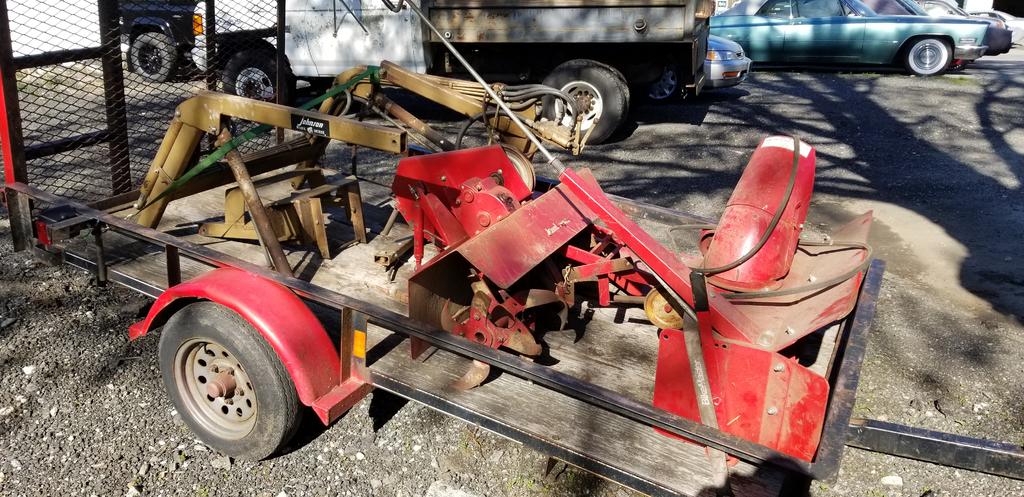

Herder 2,356 #1 Posted April 26, 2019 Any thoughts on this loader attachment, it is included in a package deal that I have been chasing. It would be mounted on a long frame. These are the only pics. I have currently. Share this post Link to post Share on other sites

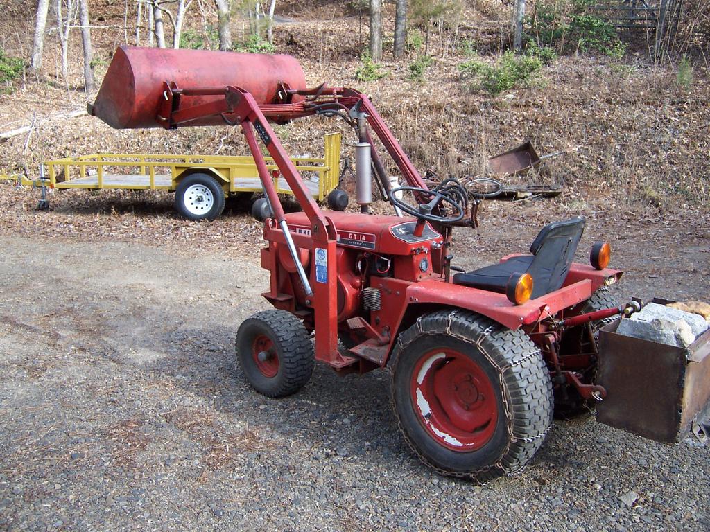

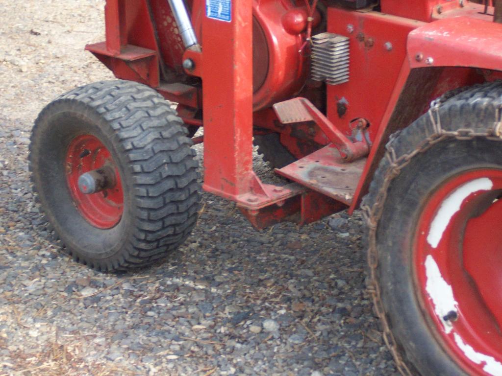

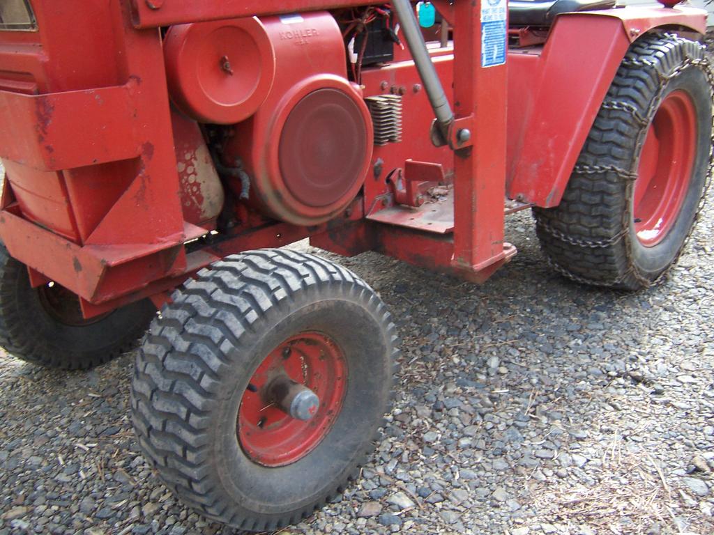

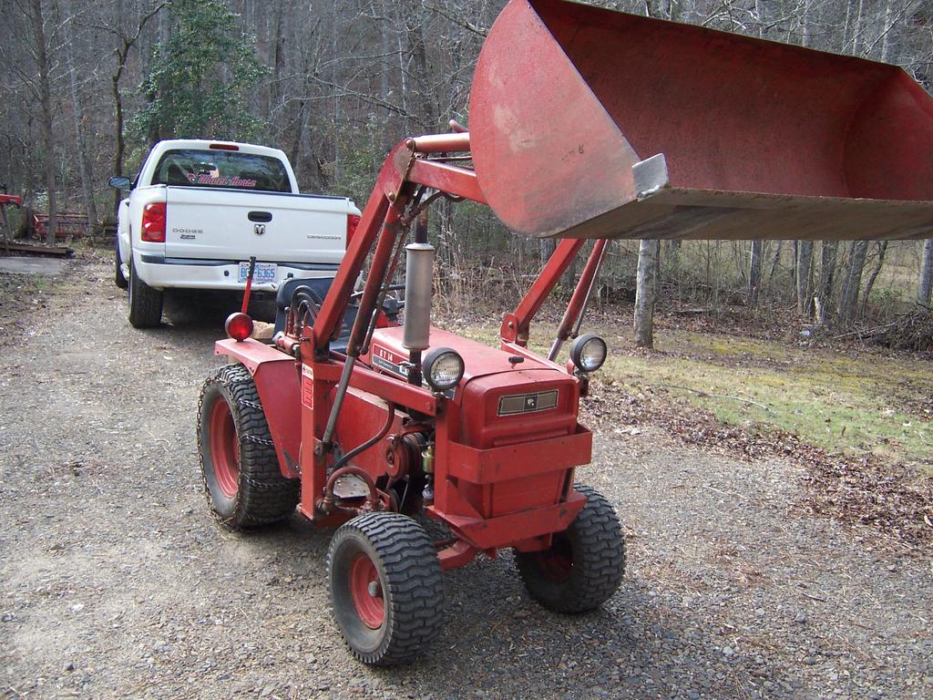

953 nut 68,520 #7 Posted April 26, 2019 2 minutes ago, Herder said: Can you see me now? 54 minutes ago, Herder said: thoughts on this loader attachment, The loader looks as though it hasn't had too much time on it, but a few key elements are missing. You will need a sub-frame that will transfer the forces of the loader to the axles. Also rear weight is very . Here are a couple photos of my Johnson FEL on a GT-14. 1 1 Share this post Link to post Share on other sites

roadapples 6,987 #9 Posted April 26, 2019 Although very important the base frame is not complicated. Wouldn't want to be without mine. If price is right go for it. If your comming to the Big show you can get pictures and measurements for subframe... 1 Share this post Link to post Share on other sites
Herder 2,356 #10 Posted April 28, 2019 On 4/26/2019 at 7:01 AM, 953 nut said: The loader looks as though it hasn't had too much time on it, but a few key elements are missing. You will need a sub-frame that will transfer the forces of the loader to the axles. Also rear weight is very . Here are a couple photos of my Johnson FEL on a GT-14. When you have a chance could you post some closeup pics for sub frame and the mount points for the pump? Nice Johnson by the way! Thanks. Adam. Share this post Link to post Share on other sites
