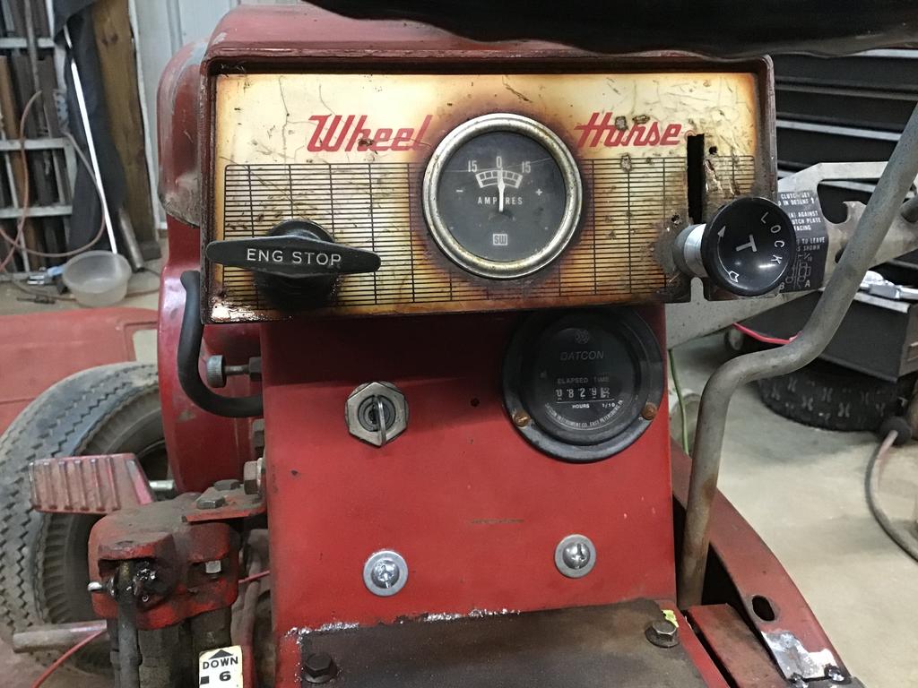

WHX?? 58,324 #53 Posted April 26, 2019 (edited) Yup... check out dem fenders! Got any specs on the engine Dan, .... HP, torque and such. What size genny would have it been used on? Any chance we can get a pic of that relocated monitor panel on the hood stand? Edited April 26, 2019 by WHX22 2 Share this post Link to post Share on other sites

Achto 32,890 #60 Posted April 26, 2019 (edited) As long as we're still on the topic of the Hatz engine I'll add a few pic's of the other minor alterations that I did to the engine. A pic of the engine as I purchased it. After I had the pulley to crank issue figured out it was time to move on to throttle control. Looking at the picture below, the arm for the throttle moves to your left to decrees speed and to the right to increase speed. This engine was designed to be a generator engine so originally the throttle arm was held full open (3600RPMs) by a spring on the throttle arm shaft. The tension on this spring had to be released other wise a small throttle cable would have buckled trying to move it. Second issue, no place to mount a throttle cable. To solve this, the bracket bolted to the right of the picture was made. It is bolted in the location where the ignition switch and indicator lights were formally mounted. Given the movement of the throttle arm I found it better to move the throttle control to the opposite side of the dash. Next item - get rid of the great big ham can muffler. It exited through the top and was just not going to work with the tractor. After removing the muffler I used the gasket as a pattern to make a mounting flange out of 1/4" plate. Clearance was going to be an issue and pipe with a tight 90 degree bend was not locally available, a 1 1/2" close bend header piece was purchased from Summit racing to make the first bend out of the engine. To get out from under the hood I dug through my pile of Harley exhaust pipes to find some thing with the right bend. An after market pipe from a Shovel Head had just what was needed. Before welding the header pipe together, the rims were painted and the tires were mounted. Having the tractor on all 4's allowed me to make sure the pipe would sit strait on the tractor. I'm not a fan of the looks of a bare cast aluminum block, they are just too hard to keep looking good. A light strip down & a little paint cured that. I did leave some of the machined aluminum show to break up the black. A light rub with some polish on occasion will keep the machined aluminum looking good. Some red paint on the tins, to help bring it together with the rest of the tractor. The recoil starter was polished and a custom decal from Terry was added to finish it off. Edited April 26, 2019 by Achto 2 8 1 Share this post Link to post Share on other sites

Pullstart 71,482 #62 Posted April 26, 2019 Hey Dan, looks like we need to trade cables! 3 Share this post Link to post Share on other sites
Achto 32,890 #63 Posted April 26, 2019 (edited) 29 minutes ago, pullstart said: Hey Dan, looks like we need to trade cables! I like the kill cable Kevin You could kill this Hatz engine with the throttle cable. I have mine set so that it will idle nice with the throttle knob pushed all of the way instead of it killing the engine. Why??? This way you have to shut the key off to kill the engine. A big reason for doing it this way - I rebuilt the engine on my dads Ford tractor, 2 weeks later I stop back over to see if it was ready for its first oil change. What do I find?? 120hrs on the clock & a dead battery. Because some one had left the key on after shutting the engine off. Edited April 26, 2019 by Achto 1 1 Share this post Link to post Share on other sites
