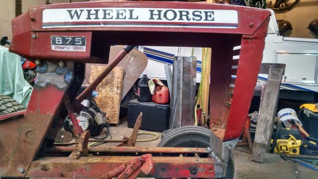

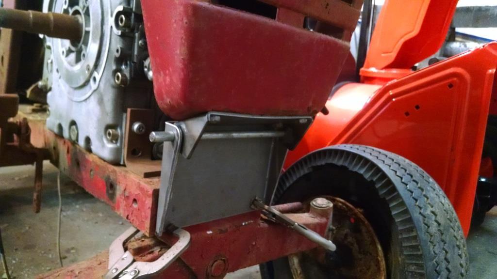

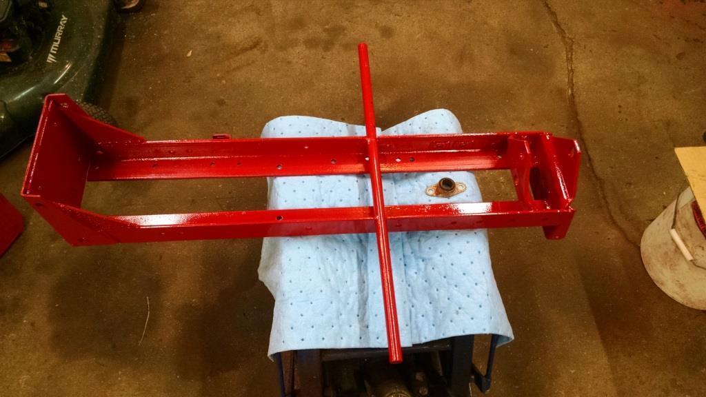

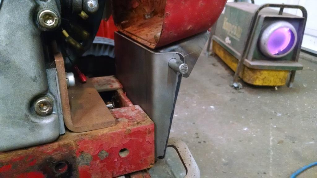

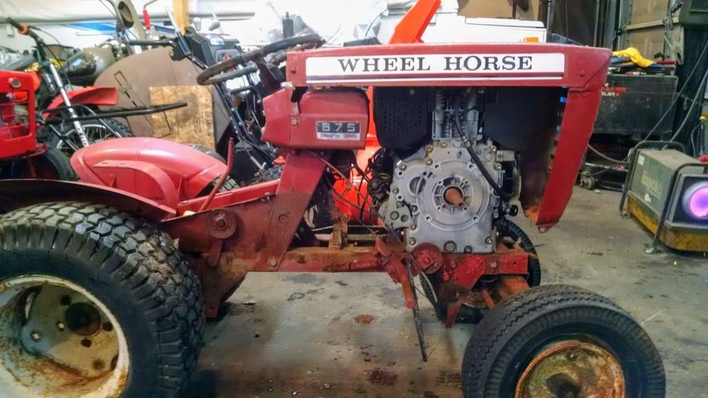

Achto 32,845 #32 Posted April 25, 2019 7 hours ago, pullstart said: I’ve got a question. Can I see more pictures? Sure can Kevin. I'll back up some. As you can see in my ground zero pic Radpferd came to me as a mutt. I could've tried to put him back to original but instead I decided to just roll with it. First on the list was to make the rather tall Hatz fit under the hood. This pic shows the challenge ahead. I didn't want to cut a hole in the hood so I set a piece of 3/4" thick wood on top of the engine, set the hood on top of it & started measuring. First up was to make an extended hinge for the frame. While I was at it I also made a new hinge for the hood as the old one was pretty worn out. Then there was the dash pedestal. I cut a piece of 12ga and bent it to make the pedestal taller. Weld nuts were added on the inside to ease the dash installation. This changed the angle of the steering shaft some but every thing seems to work well. The steering shaft was cut below the dash, then a piece was welded back on to extend it to the proper length. Total lift kit required to fit the engine was 3 1/2". 2 8 Share this post Link to post Share on other sites

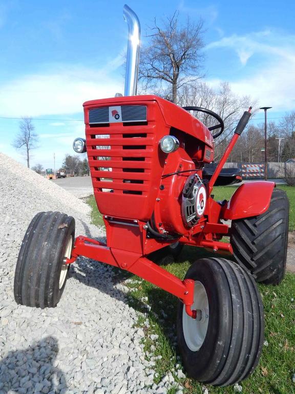

classiccat 548 #33 Posted April 25, 2019 Incredible custom Dan! I think you pulled off the “fat bottom” factory option! 1 1 Share this post Link to post Share on other sites
dclarke 4,274 #34 Posted April 25, 2019 An awesome job on this build, Dan. Love the pics! keep them coming. 1 1 Share this post Link to post Share on other sites

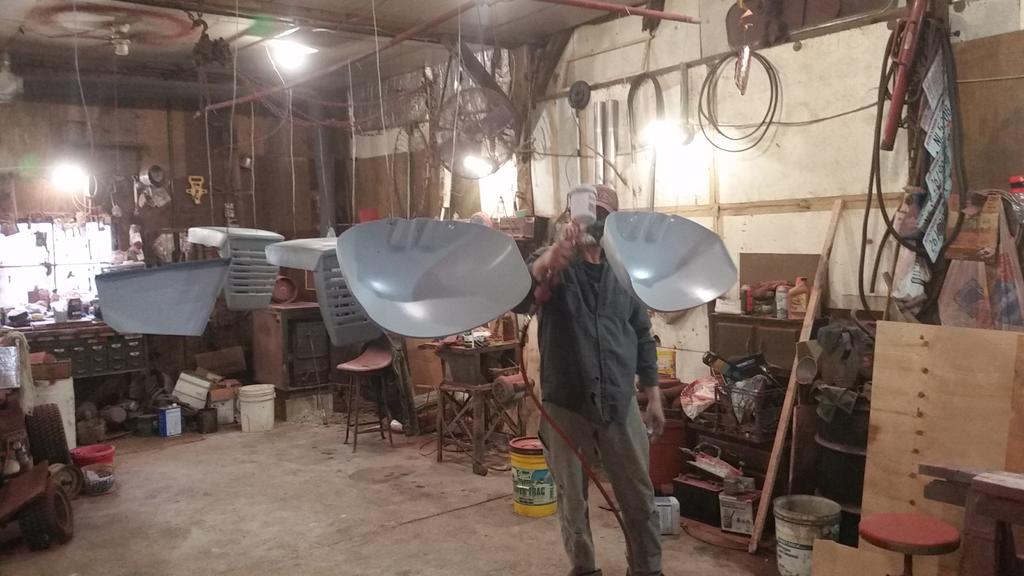

WHX?? 58,307 #41 Posted April 25, 2019 Assembly time was ungodly quick ... pics taken 4/6/19. Laying down primer. Red went on 4/7/19. Fenders and a few other pieces got the runs so repainted 4/13/19. Maybe those fenders just didn't want to be RED! 1 2 Share this post Link to post Share on other sites

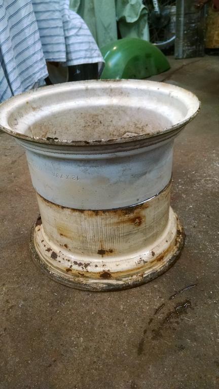

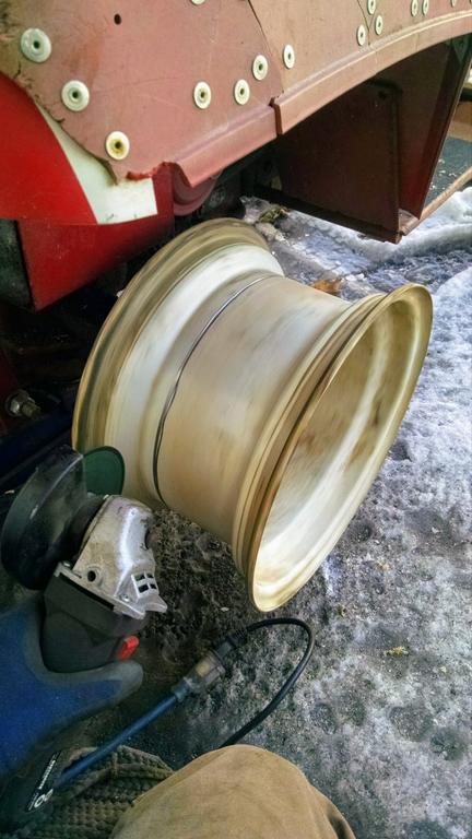

Achto 32,845 #48 Posted April 25, 2019 (edited) I'll slip in a couple more pic's then I guess I need to actually do my job. These are in process pics of making the 11" wide rims. To cut these I bolted them on to my ultra rare C145 turning lathe. With it running wide open full forward on the hydro lever, I used a 4 1/2" grinder to cut the rims apart. Stacked together & ready to weld up. After welding I was with in a 1/16" on my tolerance. Close enough for who it's for. Edited April 25, 2019 by Achto 2 6 1 Share this post Link to post Share on other sites
