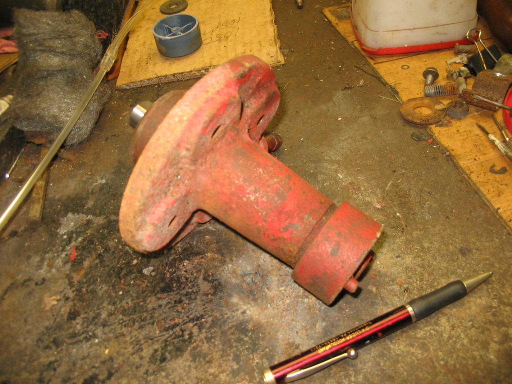

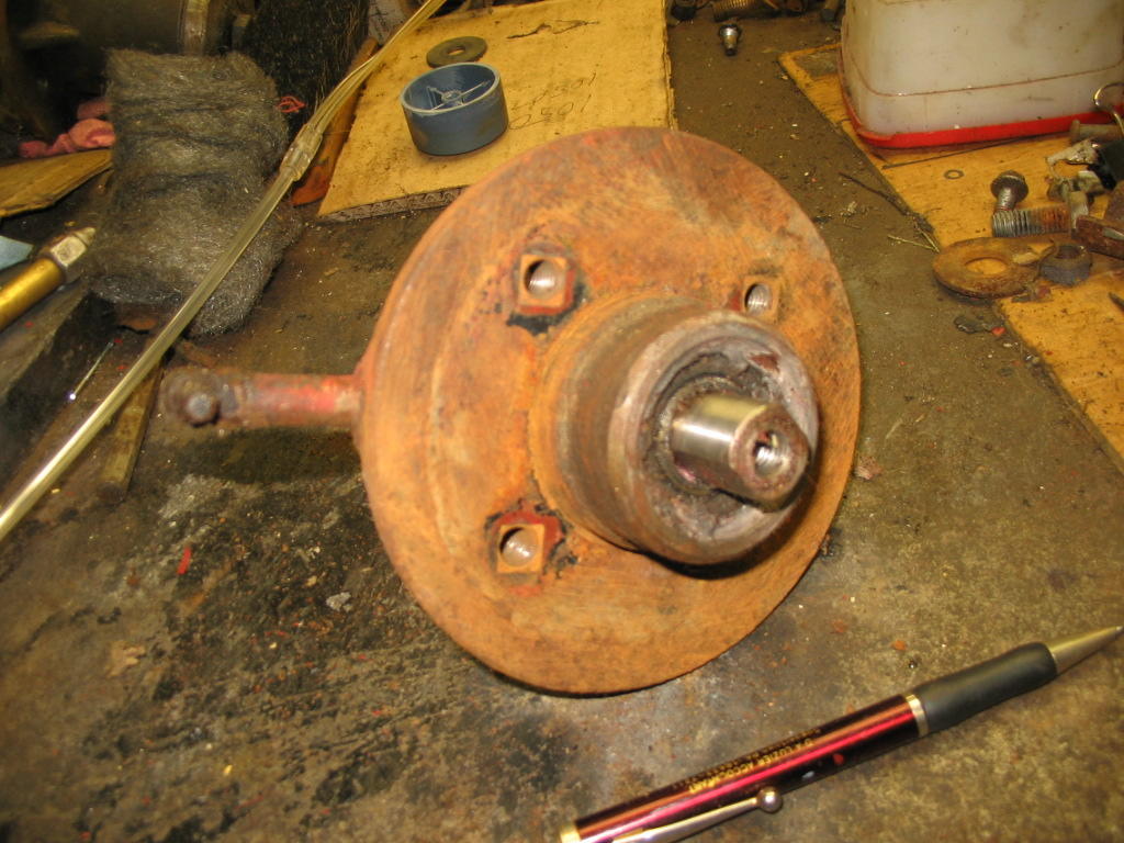

JoeM 9,646 #4 Posted April 24, 2019 (edited) I have not had to much trouble with the double D type and or the keyed ones. If they are really stuck, chances are they are the tapered ones. Like Daveoman said you can drive them out but there is a bit of caution doing so. I have busted the bottom snap ring area out of a housing because the bottom bearing was stuck to the shaft, or I gave it one hit to many and tried to drive the shaft out of the housing with the bearing. I think if you can loosen the bolts a hair and wedge under the pulley that may help. Heating the center of the pulley is always helpful. One thing to remember the spindle assy. is worth way more than the pulley. A couple years ago I messed around with a clamp arrangement trying to pull the pulley off undamaged. It was a fail but the theory seemed good. Maybe some of the other guys can give some ideas. ?? Looking at these old pics I may have another idea. Stay tuned! I did stop at the barn today and put a steering gear puller on the grove of that old spindle and it pulled right off. I looked at one of the newer pulley and looked at taping the holes 5/16 to use as puller holes. There is about 3/16 of metal just wonder if that will hold the up to the pull? Edited April 24, 2019 by OILUJ52 1 Share this post Link to post Share on other sites
