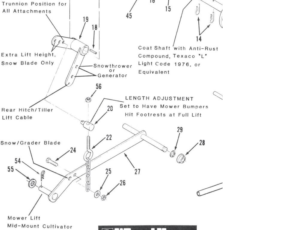

Topo 13 #1 Posted April 23, 2019 Hello; I have a 312-8 and a 312 Hydro , I want to mount the snow blower off from the 312-8 onto the hydro but the lift arm is way to long and will not fit at all, any advice will be helpful. thank you Share this post Link to post Share on other sites
gwest_ca-(File Mod) 12,259 #2 Posted April 23, 2019 They should be the same. Sounds like you may be trying to attach it to the wrong arm on the bellcrank item #19. Garry 1 Share this post Link to post Share on other sites
Topo 13 #3 Posted April 25, 2019 Got it, thanks for the heads up, I went to a friends and looked under his and found the connection point, yup I was totally wrong in location... never would have found it without your help thanks Share this post Link to post Share on other sites
