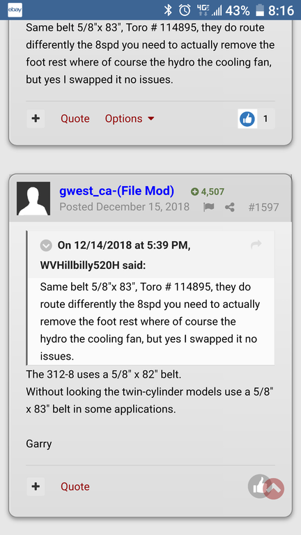

gwest_ca-(File Mod) 12,483 #2 Posted April 22, 2019 Drive belt has been added to this page. Click on the fuzzy picture Garry 3 Share this post Link to post Share on other sites
WVHillbilly520H 10,379 #3 Posted April 23, 2019 I have just pulled a new belt from the project 312-8 and it worked just fine on my '95 520H back in December. Share this post Link to post Share on other sites
