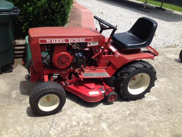

TDF5G 2,074 #1 Posted April 22, 2019 (edited) What happened: I replaced fuel lines on my '77 B-80 a couple of weeks ago. I serviced it, and got it ready for mowing also and put it away in the shed. Started it up this past Saturday to do some yard work and it wouldn't stay running, then finally wouldn't run at all. Fuel pump checked ok. So I assumed carb needed cleaning. So yesterday I remove the carb and opened it up to find debris (which I was expecting) in the bowl and needle seat area. On closer examination, I determined it was rubber debris from the new fuel line hoses. What I learned: To flush new fuel line hose before installing. P.S. I got it installed and adjusted and now it runs sweet! Edited April 22, 2019 by TDF5G 10 1 Share this post Link to post Share on other sites

classiccat 548 #11 Posted April 25, 2019 On 4/22/2019 at 2:52 PM, TDF5G said: What happened: I replaced fuel lines on my '77 B-80 a couple of weeks ago. I serviced it, and got it ready for mowing also and put it away in the shed. Started it up this past Saturday to do some yard work and it wouldn't stay running, then finally wouldn't run at all. Fuel pump checked ok. So I assumed carb needed cleaning. So yesterday I remove the carb and opened it up to find debris (which I was expecting) in the bowl and needle seat area. On closer examination, I determined it was rubber debris from the new fuel line hoses. What I learned: To flush new fuel line hose before installing. P.S. I got it installed and adjusted and now it runs sweet! ^^ Sweet tractor! Share this post Link to post Share on other sites
TDF5G 2,074 #12 Posted April 25, 2019 14 hours ago, classiccat said: ^^ Sweet tractor! Thank you. She's a worker. I've owned her since 1994. 1 Share this post Link to post Share on other sites
