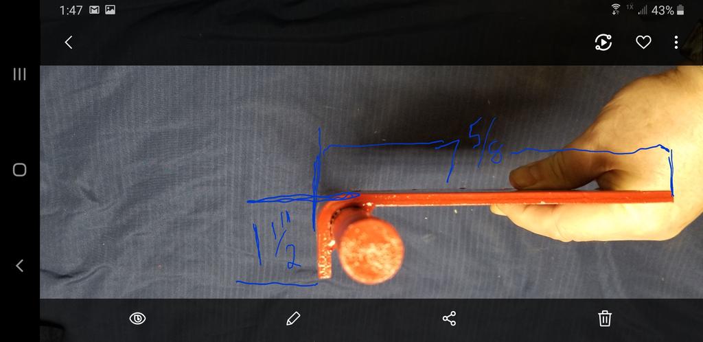

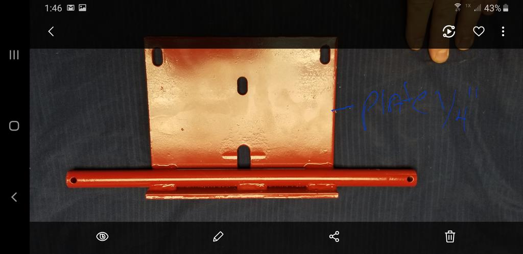

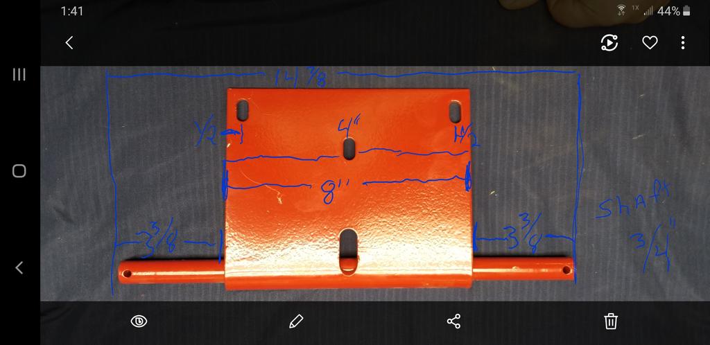

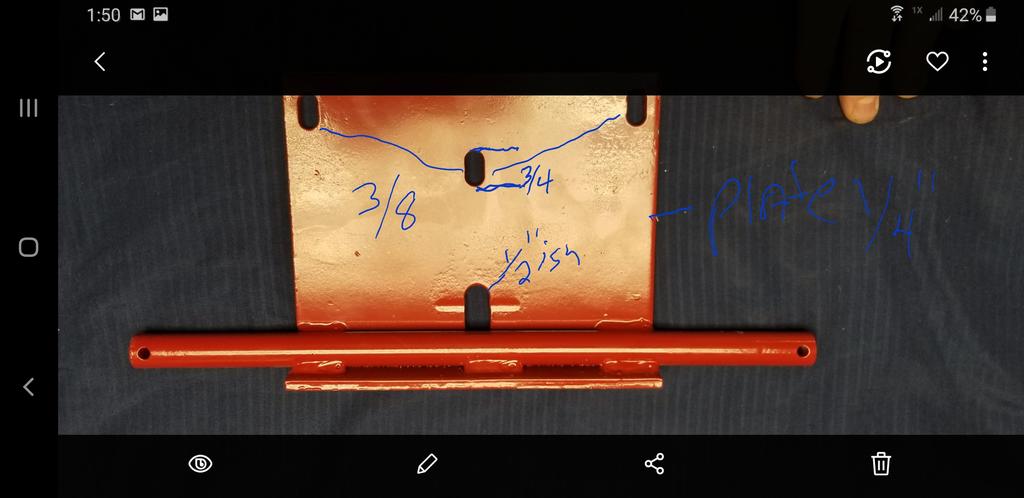

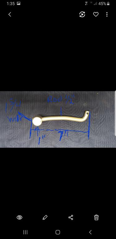

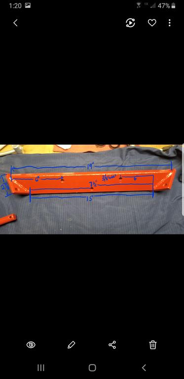

gt14rider 1,233 #3 Posted April 22, 2019 Here are some secs, let me know if these work for you 1 Share this post Link to post Share on other sites
Firsttimer 22 #4 Posted April 22, 2019 gtrider thanks this hopefully will get me what I need ! thanks to you and 19richie66 for all your help ! 1 Share this post Link to post Share on other sites
