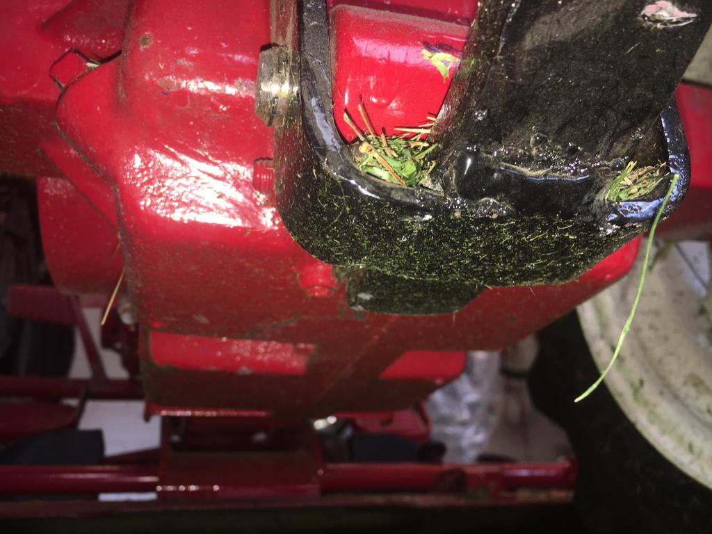

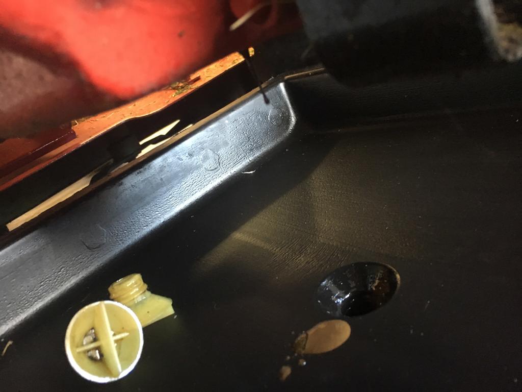

WH656 9 #1 Posted April 21, 2019 (edited) Can anyone point it out? I just see a bunch of smooth metal! Is it that tiny bolt near the hitch?? Edited April 21, 2019 by WH656 Share this post Link to post Share on other sites
Mikey the Monkey 701 #2 Posted April 21, 2019 Yes 1 Share this post Link to post Share on other sites

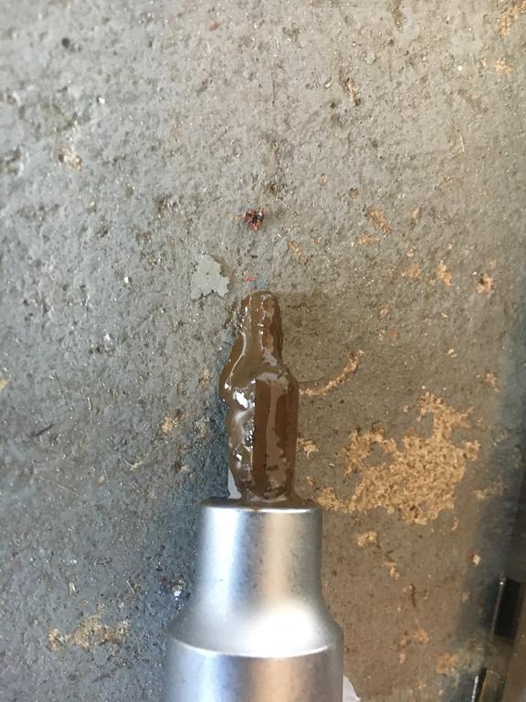

WH656 9 #4 Posted April 21, 2019 Dear God ! is it sposed to drain out as slow as peanut butter and look like mud/poop?? Share this post Link to post Share on other sites
wallfish 20,548 #5 Posted April 21, 2019 Gear oil is thick so it will drain slow and the color is a clear indication of water in it as well. 1 Share this post Link to post Share on other sites
squonk 47,988 #6 Posted April 21, 2019 That looks like a candidate for a diesel flush at minimum. 2 Share this post Link to post Share on other sites
WH656 9 #7 Posted April 21, 2019 The new gear that I am mixing in to drain it faster, comes out fast. This stuff looks like slow drip mud , whew glad I decided to look at it! 1 Share this post Link to post Share on other sites

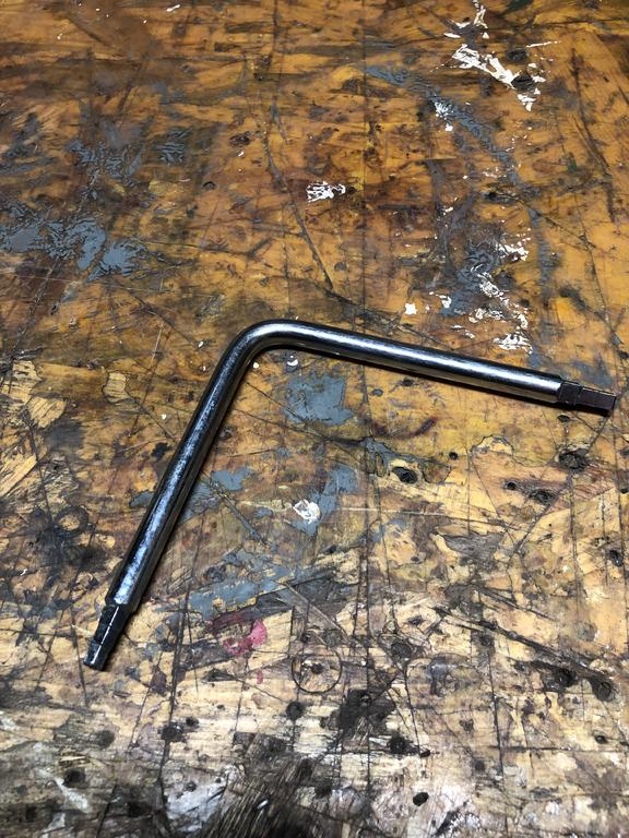

The Tuul Crib 7,354 #15 Posted April 21, 2019 (edited) Here is what I use it’s a plumbing tool. Good leverage with this one! Edited April 21, 2019 by The Tool Crib Share this post Link to post Share on other sites

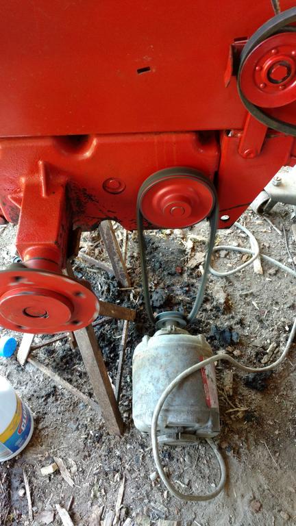

gt14rider 1,278 #18 Posted April 22, 2019 I used a electric motor, ran I in different gears flush, repeat, I let it run 20-25 min flush. Filled with cheap oil, flush then gear lube Share this post Link to post Share on other sites
