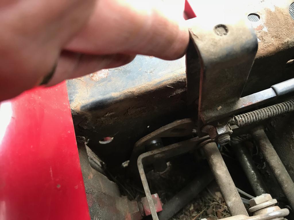

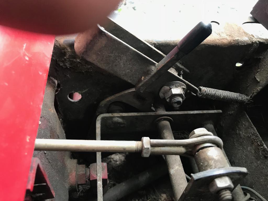

zeke37 24 #1 Posted April 20, 2019 I knew it when I bought it but the parking brake does not work. Dangerous at times. Once opened up I can only think that I am missing some sort of linkage and cannot find a good schematic. Share this post Link to post Share on other sites
gwest_ca-(File Mod) 12,276 #2 Posted April 20, 2019 Does this make sense? https://www.partstree.com/parts/toro/mowers-lawn-garden-tractor/31-18ke01-418-a-toro-418-a-garden-tractor-1987/clutch-brake-speed-control-linkage_1/ Garry Share this post Link to post Share on other sites
zeke37 24 #3 Posted April 20, 2019 Thank you Garry, I had a look, figured out that i had everything there just needed adjustment on the connecting rod. No more rolling backwards every time I get off. This mother is heavy! Excellent. Share this post Link to post Share on other sites
zeke37 24 #4 Posted April 20, 2019 BUT.....The adjustment spring on the other side of the rail allowed the cam plate to rotate enough to let the pawl engage, but now that spring adjustment is all loose and floppy- does not seem right. Share this post Link to post Share on other sites
