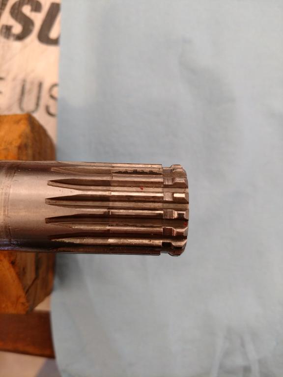

Ran d 24 #4 Posted April 19, 2019 Nice puller. I did not think of that idea. If the inside of the transaxle looks usable, I may buy a couple of used axles from AtoZ and reassemble. The axle that came out did not have any damage to the splined end? Share this post Link to post Share on other sites

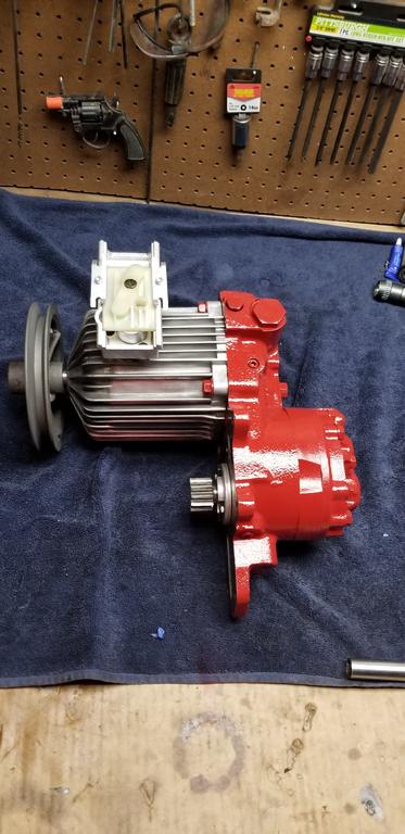

daveoman1966 3,884 #7 Posted April 19, 2019 (edited) tHERE ARE 5 BOLTS HOLDING THE HYDROGEAR TO THE TRANS CASE.. Marked here by 'X". REMOVE THEM AND THE UNIT WILL SEPARATE... Edited April 19, 2019 by daveoman1966 1 Share this post Link to post Share on other sites

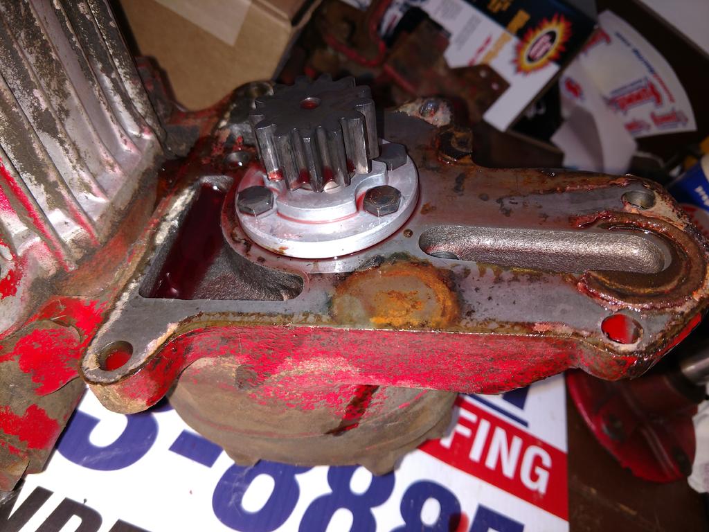

Ran d 24 #12 Posted April 19, 2019 Daveoman1966.....could you post a picture of the output side of the hydrogear you posted a pic of earlier? It may help me better understand what I am dealing with. The manual I am using is a copy and the pics in it are not the best. Thanks! Share this post Link to post Share on other sites

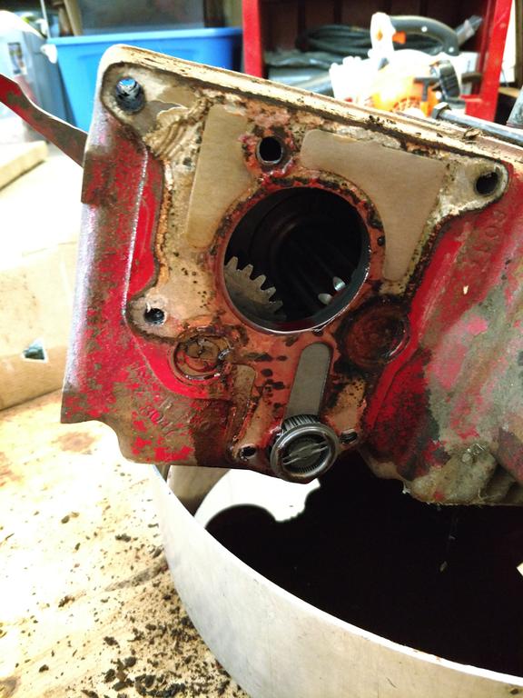

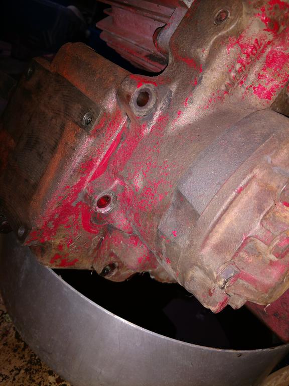

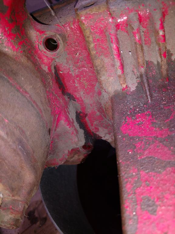

Ran d 24 #14 Posted April 20, 2019 Don't see any reason why my hydrogear can't be removed with all the bolts out. At this point, I am suspecting possibly sealant or rust is causing this issue? BTW....I do not see any sealant at the parting line. Wondering if the round protrusion behind the gear is rusted into the bore in the transaxle? Share this post Link to post Share on other sites

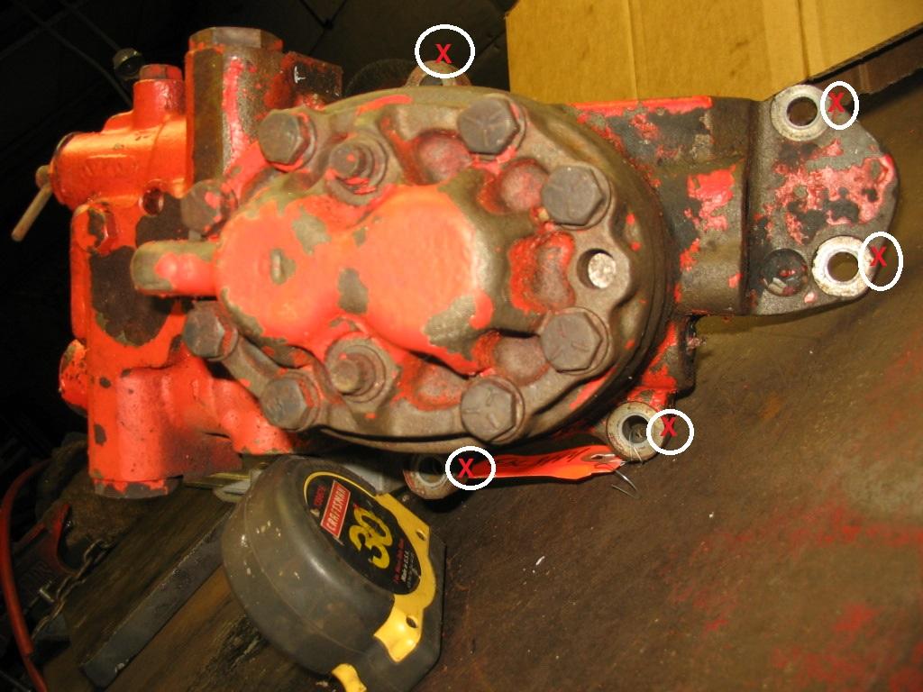

daveoman1966 3,884 #16 Posted April 20, 2019 (edited) 5 hours ago, Ran d said: Daveoman1966.....could you post a picture of the output side of the hydrogear you posted a pic of earlier? It may help me better understand what I am dealing with. The manual I am using is a copy and the pics in it are not the best. Thanks! This what you mean...? Edited April 20, 2019 by daveoman1966 1 Share this post Link to post Share on other sites
Ran d 24 #17 Posted April 20, 2019 The other axle can be turned freely. Thanks for the pic daveoman1966! As solid as this hydrogear appears to be, I am guessing that someone put it on without a gasket using sealant only. No matter what I do trying to get this off, it acts like all the bolts are still in and they are not. I have tried to persuade it tapping right under the hydraulic motor on the iron body that sticks above the transaxle case. Rock solid. Nothing is ever easy 😠 Share this post Link to post Share on other sites

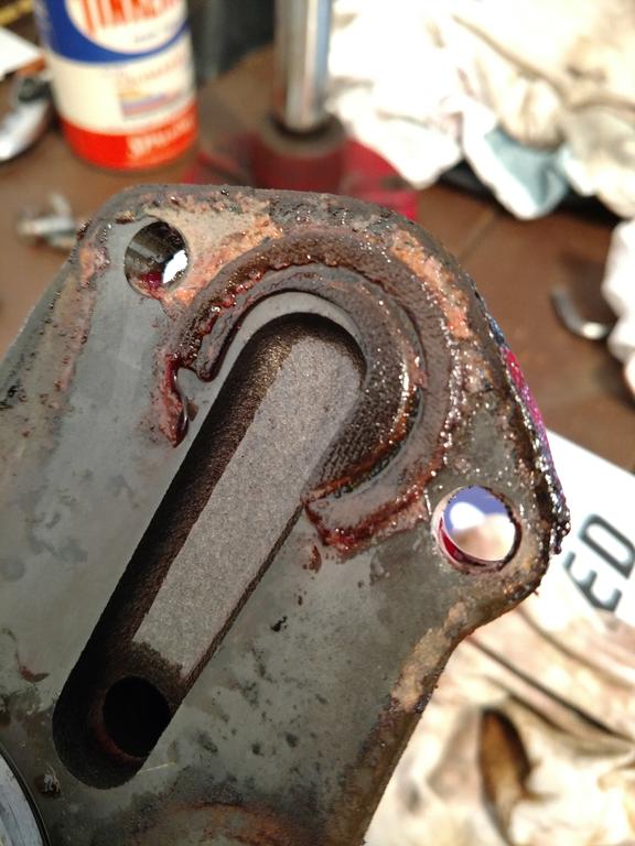

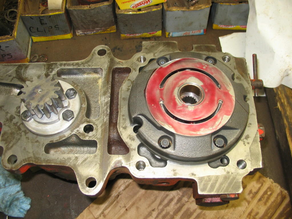

Ran d 24 #19 Posted April 21, 2019 Finally got the hydrogear removed from the transaxle. I used an old kitchen knife as pfrederi suggested. I have attached some pictures showing the two assemblies as removed. I proceeded with the transaxle case separation and had to use the kitchen knife trick again. Was able to split the case apart and removed the gasket/sealant. Share this post Link to post Share on other sites

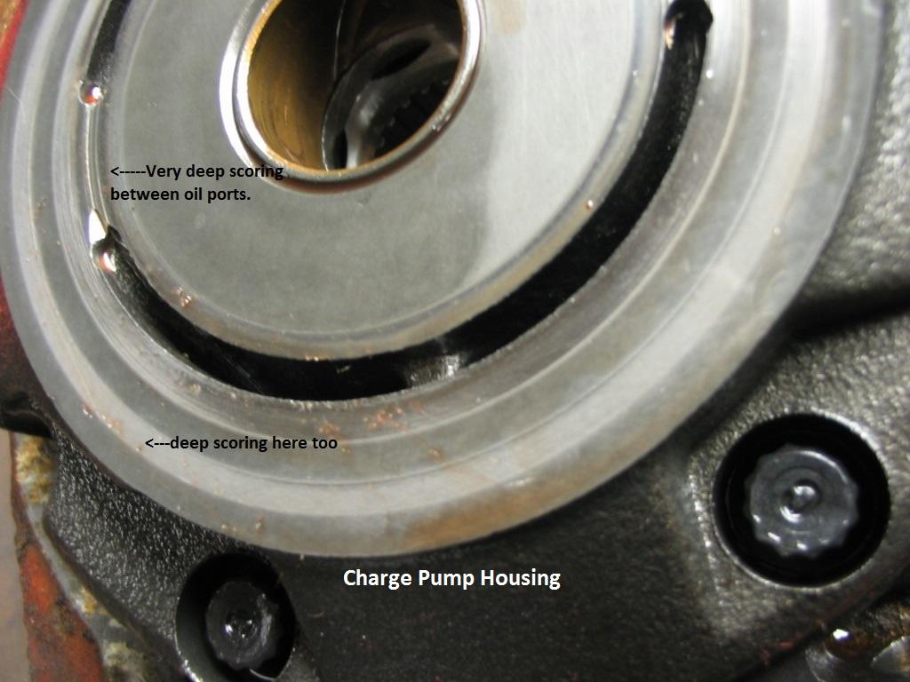

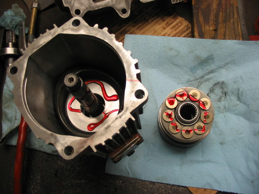

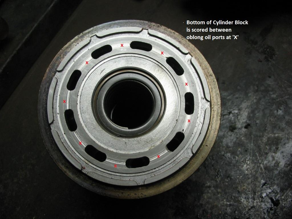

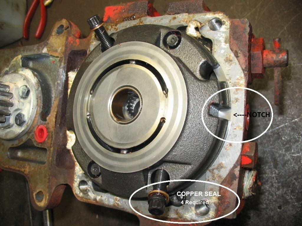

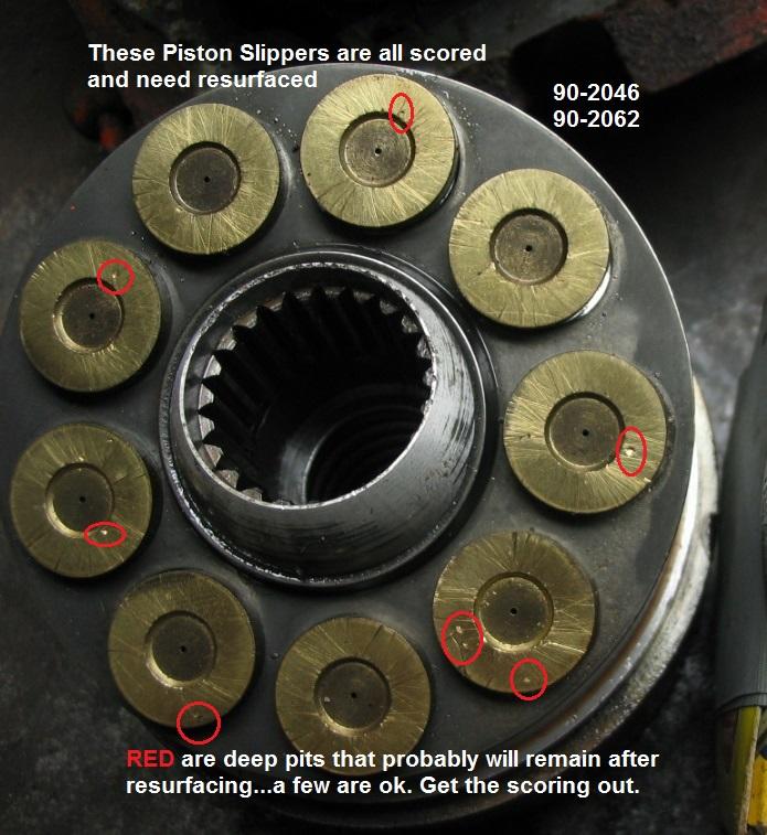

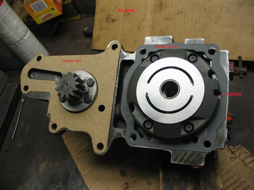

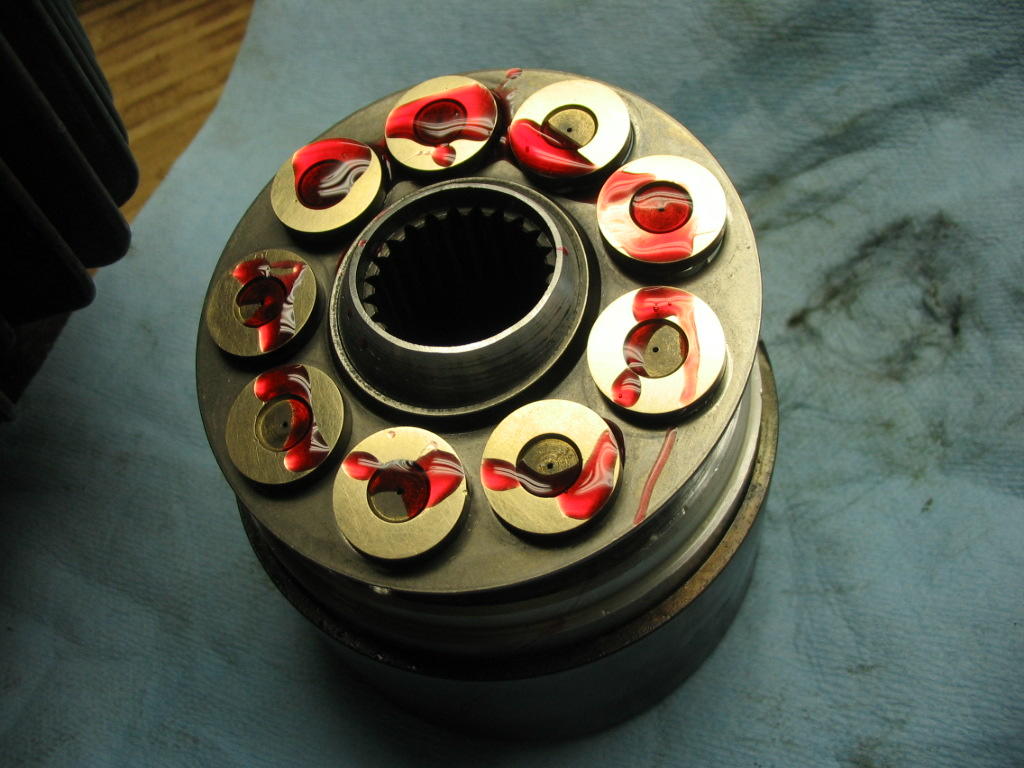

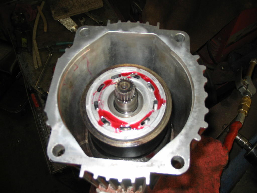

daveoman1966 3,884 #21 Posted April 21, 2019 Don't damage that screen....it is not replaceable. Almost looks like someone used JB Weld as a gasket sealant. Anyway...if you intend to take the hydrogear completely apart...be CERTAIN to scribe marks for reassembly. Note, too that,,,if you take the pump housing off,...scribe it too for cortrect relocation / orientation. The Charge Pump Housing also has to be fit ONE WAY...look a the NOTCH here. If it has scores / gouges, sand on surface plate to remove I bet the Piston Slippers look like this.... And the base of the Cylinder block too....refinish it smooth. Thorughly flush ALL PARTS in Kerosene and apply Break-in Oil to contact surfaces when reassembling the unit....thats the red stuff. 2 Share this post Link to post Share on other sites

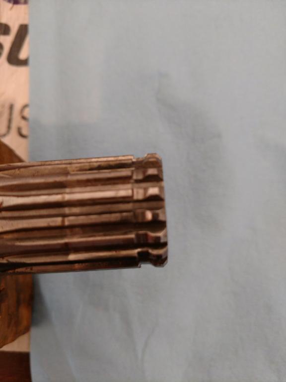

Ran d 24 #24 Posted April 21, 2019 Got to looking over the axle that came out the other day and noticed the retaining ring groove had "rounded off" splines on the onboard side of the groove. One pic shows a spline with no rounding. Share this post Link to post Share on other sites
pfrederi 21,095 #25 Posted April 21, 2019 You need to replace the rounded off axle or drill it and put in a roll pin Older differentials did have the roll pin.(That is second choice) 1 Share this post Link to post Share on other sites
