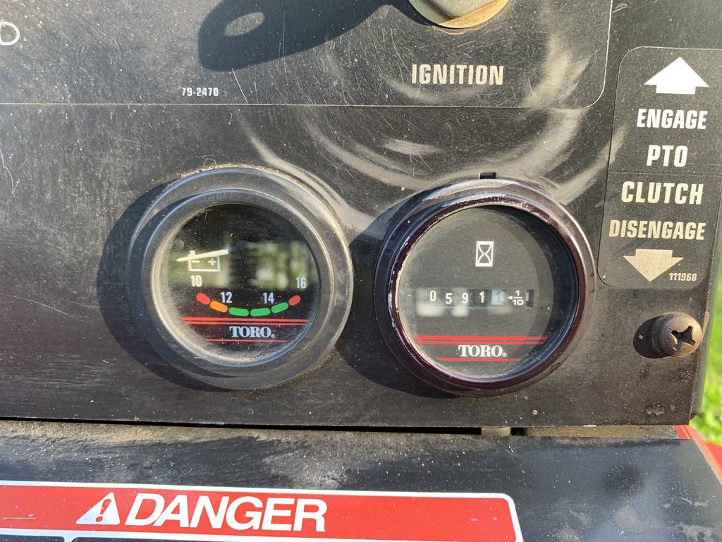

Matash 15 #1 Posted April 18, 2019 Good afternoon. I’m new the the wheel horse. What is the purpose of the cold start clutch ? Thanks Matt 5 Share this post Link to post Share on other sites
Sparky-(Admin) 26,691 #2 Posted April 18, 2019 I’m not familiar with a cold start clutch? Are you talking about the lever that disconnects the drive belt? If yes, that would be more for safety so the tractor doesn’t take off as soon as it’s running. 1 Share this post Link to post Share on other sites
Matash 15 #3 Posted April 18, 2019 Ok. Ty that’s what it is.ty Share this post Link to post Share on other sites

oldlineman 1,820 #16 Posted April 19, 2019 Also it would help in cold weather starting by the starter not having to turn the cold motor with cold oil in it and the hyd. pump with cold oil in it. Just my thoughts. Bob Share this post Link to post Share on other sites
MAD MARK 74 #17 Posted April 19, 2019 Old lineman got it. Being a hydro, it disengages the drive belt to the hydro pump for use on cold days to allow the engine to start without load. You pull up and back. To re-enage you lift up and push forward while releasing it downward slowly. My 314-H has this and I use it quite a lot. Share this post Link to post Share on other sites
