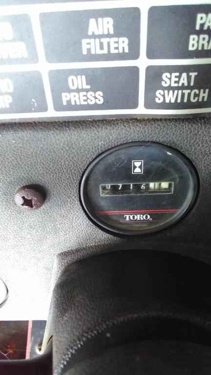

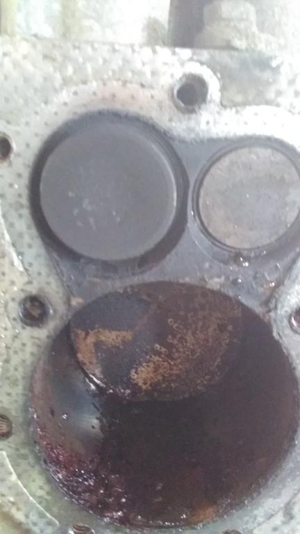

stuppy62 58 #1 Posted April 17, 2019 I recently picked up a 520H with only 716 hrs. on it and it ran and drove on the trailer just fine. Brought it home and went over it thoroughly, changed oil, new plugs, adjusted hydro drive, etc.. Reinstalled the mower and tried mowing some early grass that needed trimming and it had no power. The motor really didn't run rough or sound bad to me. I drove it back in the garage and pulled the plugs out to check compression. Well, the rear cylinder had 90 PSI, the front cylinder had 0 PSI! What the heck! I gave up on working on it for the day, got back to it today thinking it might be a stuck valve, nope, busted connecting rod! The rod is not slapping around or anything, quiet! I quit working on it again to maybe get some of your opinions on where to go from here and best case scenario. 4 Share this post Link to post Share on other sites
WHX?? 57,470 #2 Posted April 17, 2019 Well now that just down right sucks... looks like a PO wasn't keen on checking/changing oil. That cylinder looks rough but might be saved. The way I see it you have only two options, rebuild or replace/repower. Third option is parts it out to try and recoup yer investment but not keen on that but get it. I would pull the motor apart and check things out and figure out what parts would cost and go from there. Since it ran after it threw the rod chances are good nothing else was busted up in the crankcase. Good luck and keep us posted. 3 Share this post Link to post Share on other sites

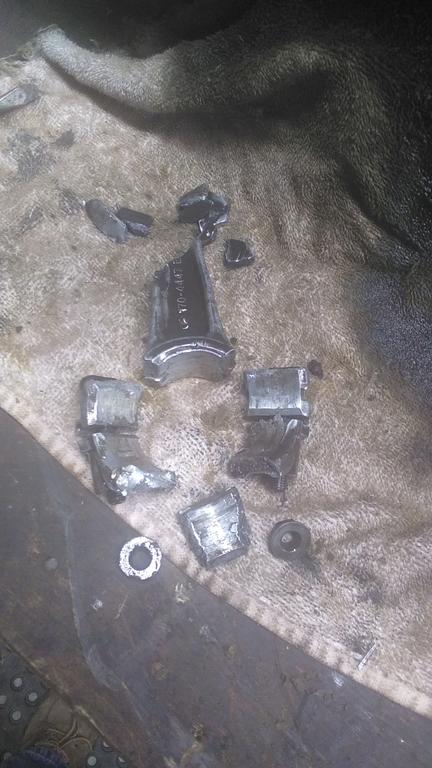

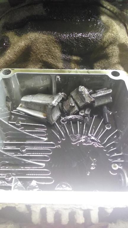

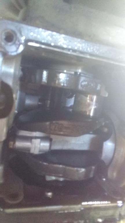

stuppy62 58 #10 Posted April 22, 2019 Well, I got it apart finally, been busy with work. It looks like to me the connecting rod nuts came loose because they were laying in the oil pan. Severe damage to the crank shaft, but it may be salvageable, not sure how I want to proceed. A donor engine would be the easiest fix, but if I repair this one at least I'll know what I have. On the up side the valves look good and the block is not harmed. I did find an Onan P220g listed for sale that claims to have new connecting rods a year ago, but valve seats have since gone bad, so it's a none running engine. If this motor did have CR's replaced then you would think pistons & rings would all be good as well. My question is would all parts be interchangeable for the P220g? 3 Share this post Link to post Share on other sites

onanparts.com 185 #14 Posted April 22, 2019 9 minutes ago, stuppy62 said: So, can any of you Onan fan's tell me if the parts(connecting rods & crank shaft) are interchangeable on these P220g's? Rods are the same on the all the 18HP & 20HP engines. Cranks are the same internally and at the flywheel end. It's the PTO end of the crank that varies. Length, diameter etc. 2 1 Share this post Link to post Share on other sites
GMan 82 #15 Posted April 22, 2019 You should stay with one pulled from a Wheel Horse to be sure the PTO end is the same dimensions (dia. & lgth.) as yours. I know the cranks in the 518 WH series would also work. Stay away from the cranks pulled from the WH 516 & 416 series as those have a different stroke and longer rods. John Deere used a lot of Onans but they had a 1 7/16" PTO shaft end diameter. Call Boomer at 651 437 2826 M-F 10-7 S-S 12-6 cent time. He is an Onan guru and likely has anything you need for your repair. If you would prefer to contact him by email is address is: (boomers_influence@yahoo.com). His real name is Robert Kummer. He's a down to earth guy, easy to talk to and doesn't make you feel upside down just because you might be unknowledgeable about Onan's...................Hope this helps.............Gary 3 1 Share this post Link to post Share on other sites
