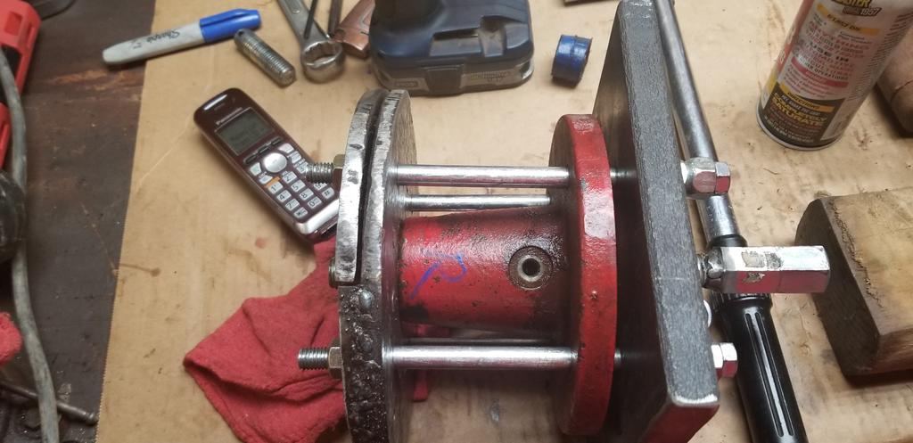

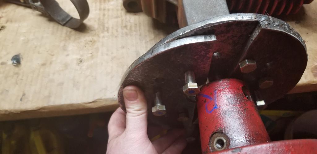

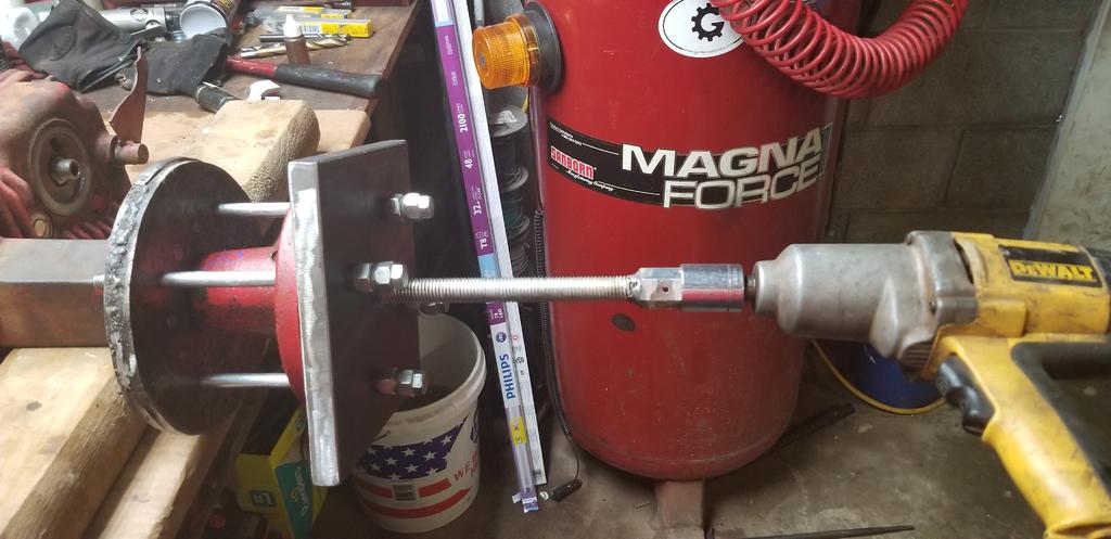

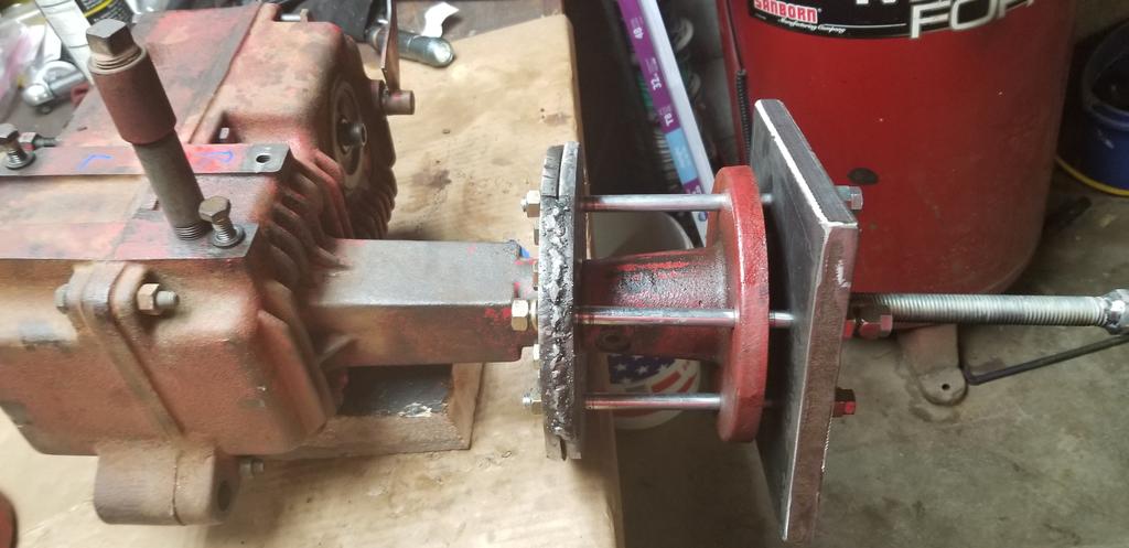

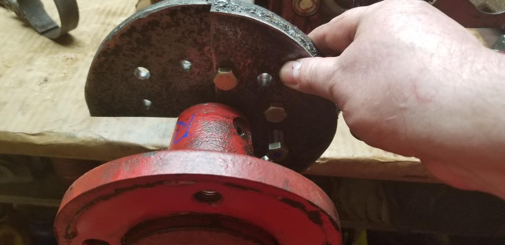

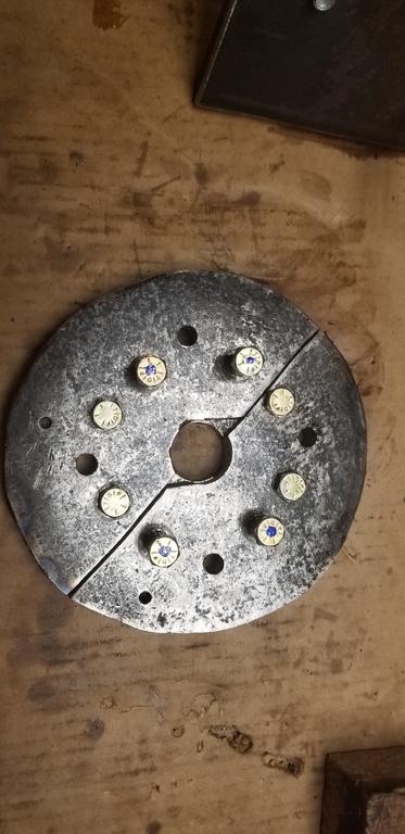

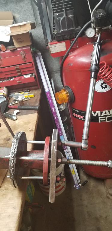

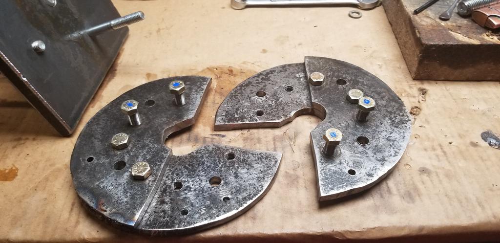

gt14rider 1,278 #1 Posted April 16, 2019 Tried to think of a puller for my gt14 four hole hub, didn't think of making it combo for a 4 and 5 hole hub but easy with a little thought. Here's what I came up with. Used scrap metal I had laying around, not pretty but it works, didn't need all the bolts on plate, can weld plates, first prototype. Pulled off no heat, did soaked with ATF and acetone for a week or too. Also tried (evaporust) let that soak 2 days, put it in hub set screw holes,and key ways. Did use a short 3/4 ×10× 3 to get things moving, than used 10" threaded rod to get all the way off, Sarge, made a suggestion to upgrade to a acme thread, stronger for pulling , may do that upgrade, also may adapt outer plate to use with a hydraulic Jack. 4 3 Share this post Link to post Share on other sites
oliver2-44 11,704 #2 Posted April 16, 2019 Good idea, thanks for sharing. It's great you got them off in one piece Share this post Link to post Share on other sites
