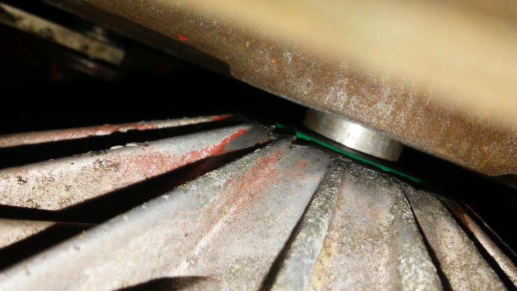

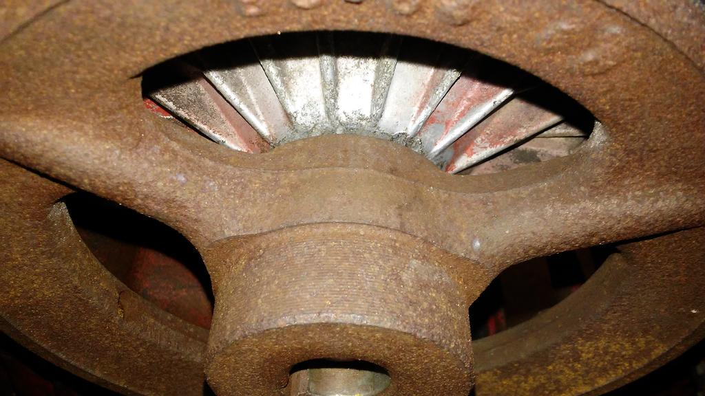

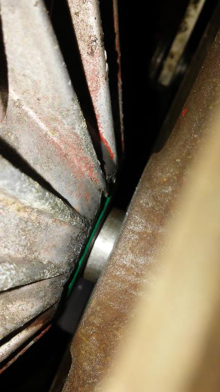

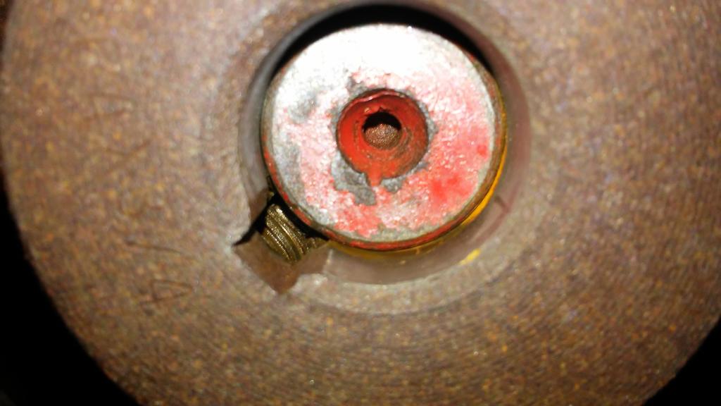

JamesPolinski 3 #7 Posted April 17, 2019 I don't know if this helps much I didn't have time to take the pulley off, but as soon as I get it off, I will post more pictures. Share this post Link to post Share on other sites
