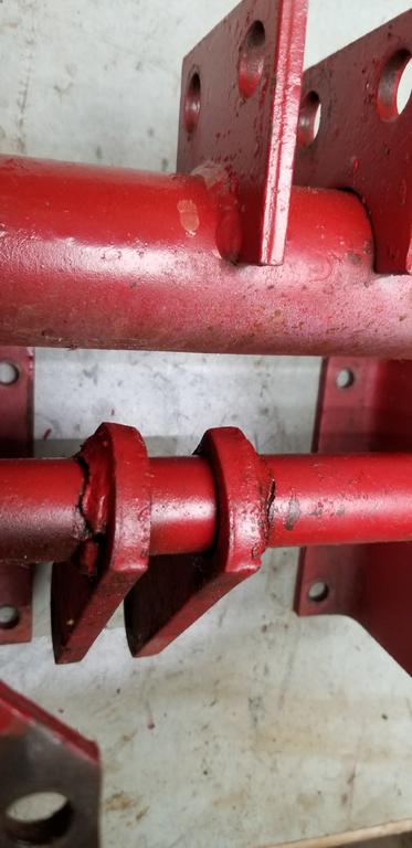

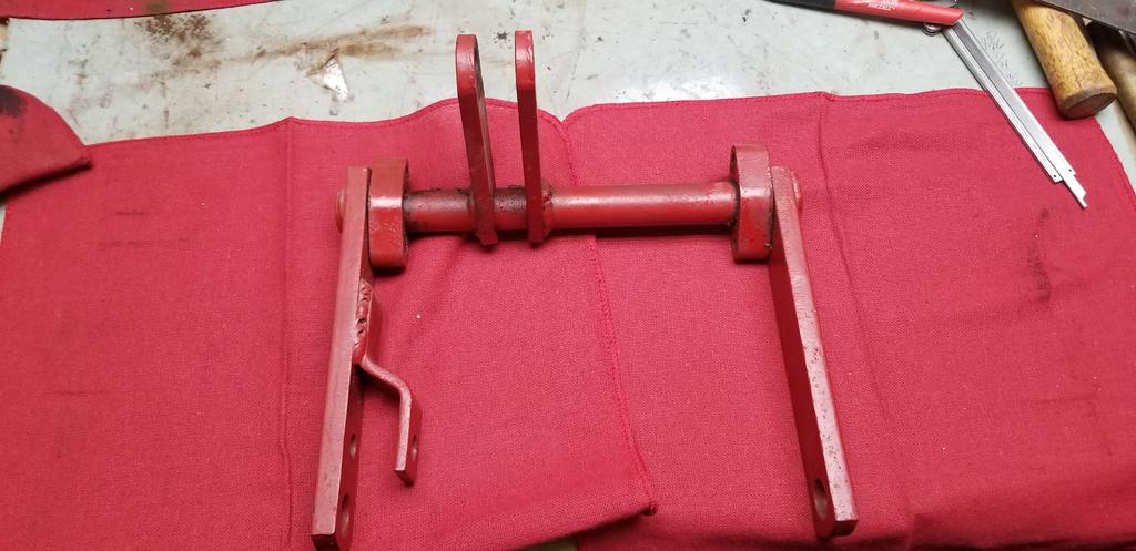

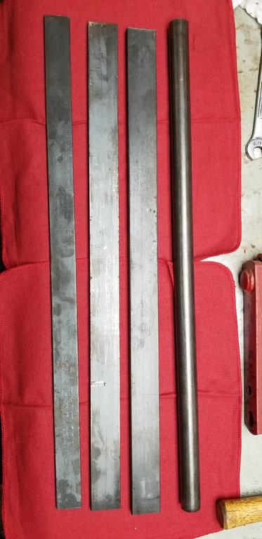

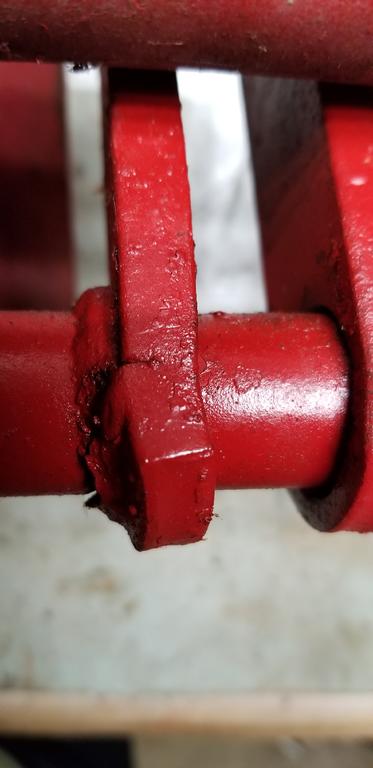

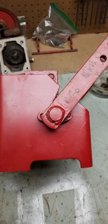

gt14rider 1,278 #52 Posted March 10, 2020 Got some more done, looking at the 3pt hitch rear lift arms, I noticed that the welds were cracked on the small arms, further inspection the arms were cracked. So got some more metal and will be making a new one. Will put brass bushing in bearing blocks. 2 3 Share this post Link to post Share on other sites
