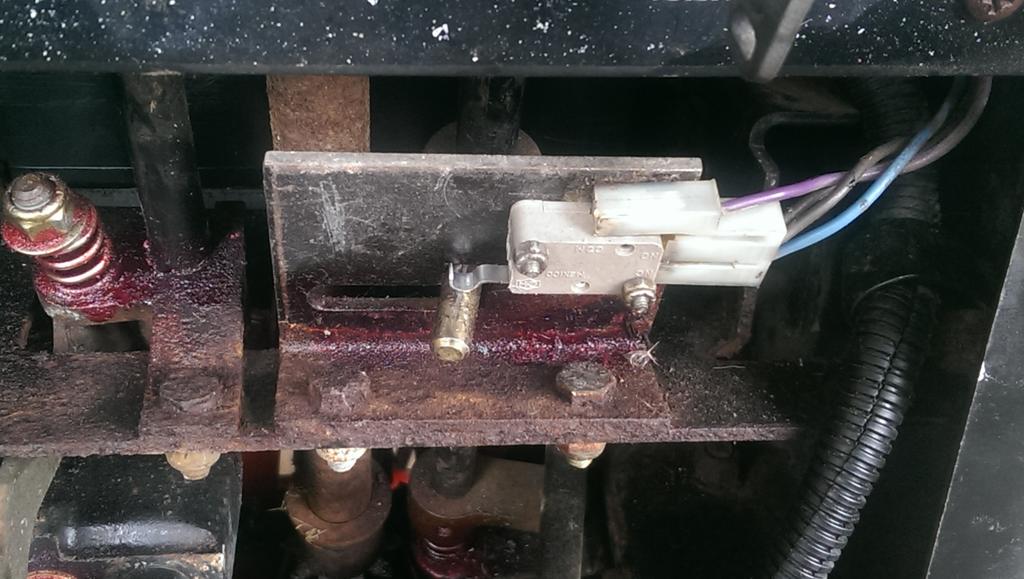

gwest_ca-(File Mod) 12,478 #2 Posted April 15, 2019 Welcome to the forum. You did not supply us with a model number or year so can't look up parts. I don't know if all the 520-H's are the same 1988-1997. Sounds like your shift linkage may be worn or loose at the neutral safety switch or the switch is mounted loosely or the switch is worn out. 1 of the pto switches and the neutral switch are required to get power to the starter. Garry Share this post Link to post Share on other sites

lynnmor 9,026 #4 Posted April 15, 2019 If you have the motion lever next to the steering wheel, remove both panels in the console. There you can clean any and all linkage to see how it works. Lubricate all linkage and contact points for the various parts that move. Under the seat, clean and lubricate linkage with the exception of the cam tension bolt area. The safety switch that is giving you problems is next to the steering column and that might be faulty. I remove the seat and fender at the end of each mowing season to clean and lubricate. Sometimes I remove the gas tank and clean under it, then paint any rusted areas. 1 1 Share this post Link to post Share on other sites
WVHillbilly520H 10,379 #5 Posted April 15, 2019 (edited) Here's the neutral safety switch (missing tang 1st pic) under the steering wheel 90-97... Edited April 15, 2019 by WVHillbilly520H 1 Share this post Link to post Share on other sites

MikeG 2 #7 Posted April 28, 2019 Hi, again thanks for your suggestions. I cleaned up the linkage area and replaced the neutral switch. Looked in the parking brake , replaced that switch too and started right up. I will do a general tuneup and some light body work and good to go. Great forum! MikeG 1 Share this post Link to post Share on other sites
