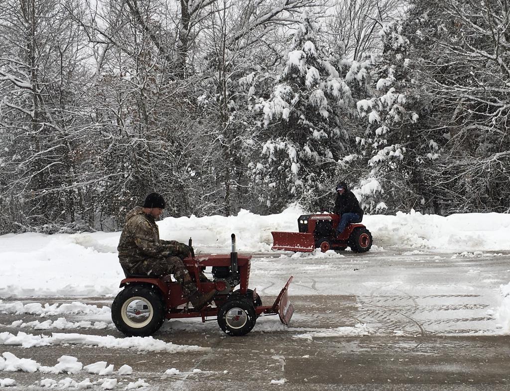

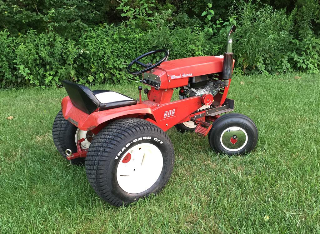

cschannuth 3,819 #16 Posted April 15, 2019 (edited) I have a Predator on my 606 and it has been great. It starts on the first pull every time and runs strong. I just had to widen the sides of the grill (no cutting) to clear the air cleaner and slightly mod the belt guard. I also upsized the engine pulley to speed it up and it does great. I use it as a tow pig and to push snow. On a related topic, my brother bought a cheap Chinese mini bike about 10 years ago that had a 212cc Predator on it. He is not a maintenance guy and is very hard on things (drives me crazy). That thing still runs strong today and it has never had so much as an oil change. Edited April 15, 2019 by cschannuth 3 Share this post Link to post Share on other sites
