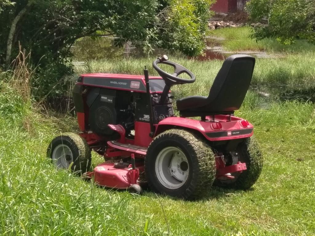

WVHillbilly520H 10,378 #8 Posted April 14, 2019 Sounds like a coil to me as well... I have a 315-8 that I just acquired last summer, starts easy runs smooth and quiet... Share this post Link to post Share on other sites
