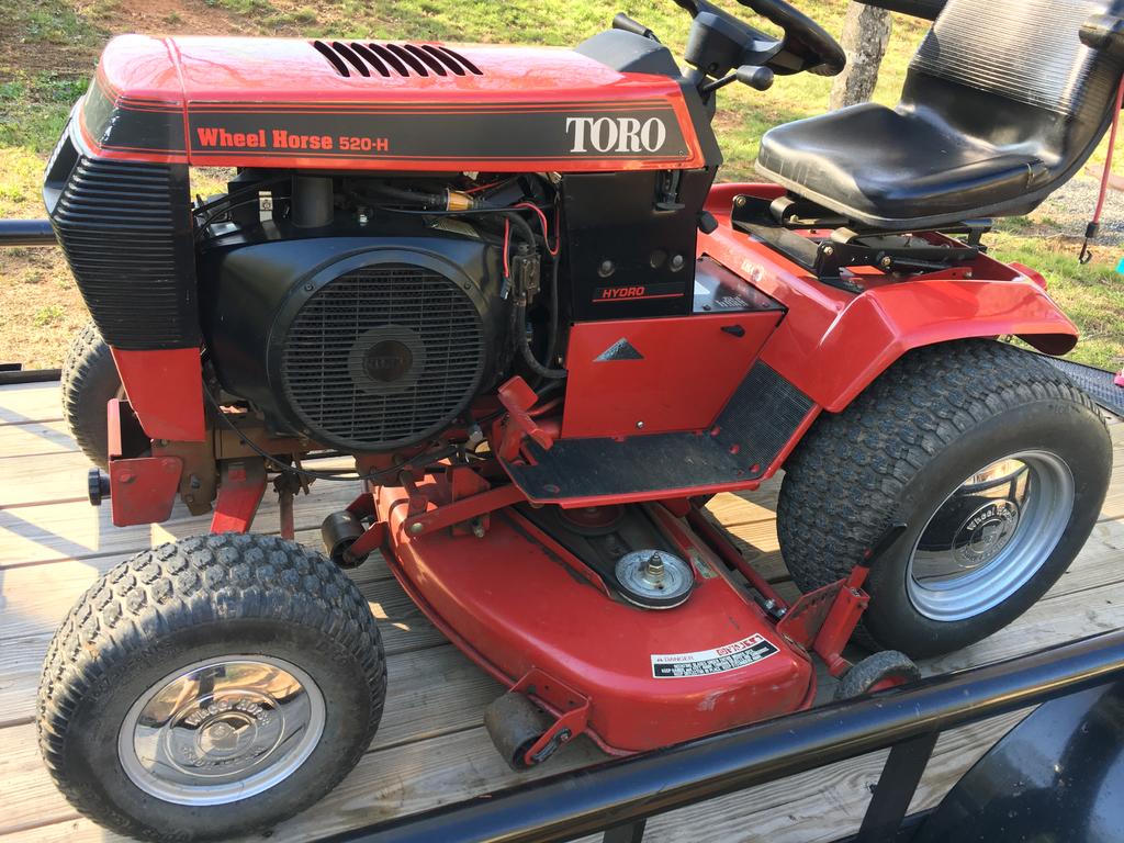

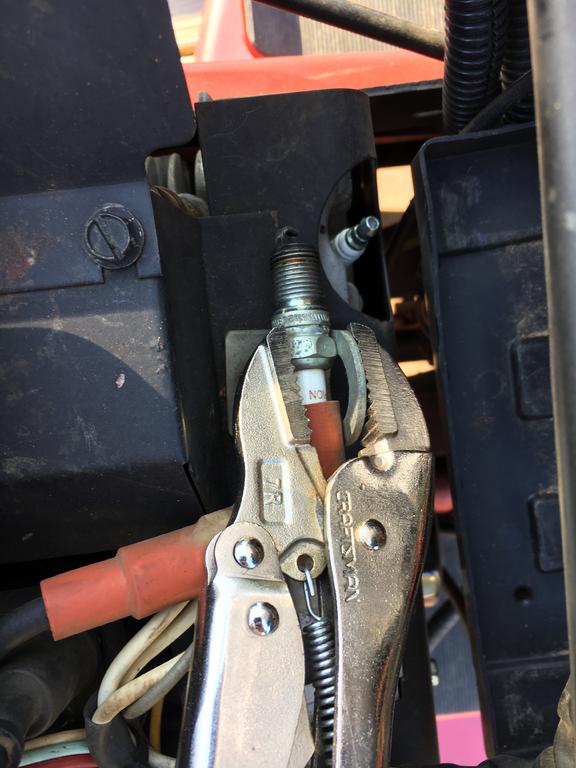

Honda4828 2 #1 Posted April 11, 2019 (edited) Update: added new plugs tonight, it fired right up. It is blowing gas out of the carb though. So correct me if I’m wrong, but the main jet must be stuck? Hello, I purchased a 91 520h yesterday that’s in excellent shape, but only fires on the front cylinder. The original owner I bought it from said it will only start and run with a spark plug grounded to the bracket on the rear block. This really confuses me, why would it not fire with the plug wire on the plug that’s in the rear cylinder. The plug that he has vice gripped to the bracket is sparking. I plan on compression testing the rear cylinder. And also swapping the coil and wires from my 92 to the 91 to see if it will run. Anything else I could try? Pics attached Edited April 11, 2019 by Honda4828 Share this post Link to post Share on other sites

ericj 1,580 #3 Posted April 11, 2019 do the compression test, I think you'll find either low or no compression in the back cylinder. Nice looking tractor, hopefully you got it for a good price with it having a bad cylinder. Does it back fire through the carb ? if ti does it could be a loose valve seat. Do the compression test, then depending on what you find pull the motor and do a tear down to see what the problem is. Good luck eric j 1 Share this post Link to post Share on other sites

squonk 46,856 #13 Posted April 11, 2019 Take a good look at the plug you take out of the rear cylinder. This engine fires both plugs at the same time. Once on compression and the other exhaust. The spark current travels out of 1 coil tower, thru a plug wire, across the spark gap to ground (block). At the same time that current travels out of the block, across the other plug gap thru the wire and into the coil. The spark current basically travels in a circle. If there is an open in a plug It breaks the circle and eliminates the spark. That's why he needed to get that other wire grounded. I used to run into this on GM car's in the 90's with waste spark ignition. 1 plug would go bad and kill 2 cylinders. Share this post Link to post Share on other sites
Honda4828 2 #14 Posted April 11, 2019 3 minutes ago, squonk said: Take a good look at the plug you take out of the rear cylinder. This engine fires both plugs at the same time. Once on compression and the other exhaust. The spark current travels out of 1 coil tower, thru a plug wire, across the spark gap to ground (block). At the same time that current travels out of the block, across the other plug gap thru the wire and into the coil. The spark current basically travels in a circle. If there is an open in a plug It breaks the circle and eliminates the spark. That's why he needed to get that other wire grounded. I used to run into this on GM car's in the 90's with waste spark ignition. 1 plug would go bad and kill 2 cylinders. Boy wouldn’t that be nice if it’s just a bad plug. I’m going to put new plugs in today I hope, and feel for the compression. Share this post Link to post Share on other sites
