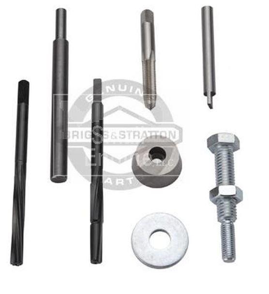

classiccat 548 #2 Posted April 11, 2019 I've never done a Kohler but have done an old Briggs last summer using this kit (5/16" valve stems). Maybe a similar kit exists for Kohler? Share this post Link to post Share on other sites
