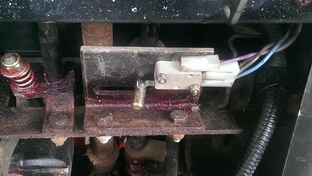

WVHillbilly520H 10,379 #5 Posted April 10, 2019 Another thing to check is the nuetral safety switch under the steering wheel on my '95 the actuator tang had broken off, the switch was techinally good just wasn't being made... 1st pic ...2cd new switch... 1 Share this post Link to post Share on other sites

WVHillbilly520H 10,379 #7 Posted April 10, 2019 1 hour ago, WVHillbilly520H said: Another thing to check is the nuetral safety switch under the steering wheel on my '95 the actuator tang had broken off, the switch was techinally good just wasn't being made... 1st pic ...2cd new switch... Notice the BLUE wire going into the switch ... When I bought this tractor used the P.O. had already installed a bypass wire from ignition switch to the starter solenoid until I track it down with help from the demystification guide and having a 2cd (no issues) 520H to look at. 2 Share this post Link to post Share on other sites
