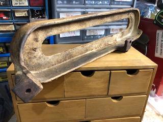

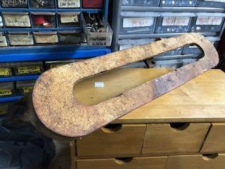

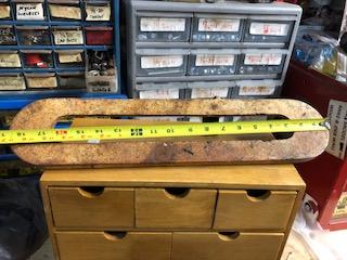

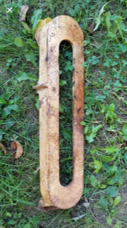

55rj35jr 626 #29 Posted January 15, 2020 i have a cast metal belt guard for one of these if interested not sure what model it fits, it is like the long white one in picture from engine pulley, if interested let me know Share this post Link to post Share on other sites
Mudrig150 395 #30 Posted January 15, 2020 15 minutes ago, 55rj35jr said: i have a cast metal belt guard for one of these if interested not sure what model it fits, it is like the long white one in picture from engine pulley, if interested let me know How much? Also- That's what the paint is supposed to look like? Dang. Mine is ROUGH. 1 Share this post Link to post Share on other sites

Mudrig150 395 #33 Posted February 11, 2020 Bought the belt guard for the Burns, gonna get some funds together, buy my almost brand new briggs, and get the restoration going. 3 Share this post Link to post Share on other sites

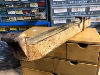

Mudrig150 395 #34 Posted February 13, 2020 (edited) The belt guard came yesterday. It's quite a chunk of cast iron! It weighs like 5 pounds, and is 1/8-1/4" thick cast iron. No wonder the original one broke off. Thanks, @55rj35jr for helping me out. Edited February 13, 2020 by Mudrig150 2 1 Share this post Link to post Share on other sites
55rj35jr 626 #35 Posted February 14, 2020 23 hours ago, Mudrig150 said: The belt guard came yesterday. It's quite a chunk of cast iron! It weighs like 5 pounds, and is 1/8-1/4" thick cast iron. No wonder the original one broke off. Thanks, @55rj35jr for helping me out. Glad to help, its one of those parts that you would probably never find, it just so happened that I had one. thanks 1 Share this post Link to post Share on other sites
Mudrig150 395 #36 Posted February 14, 2020 10 minutes ago, 55rj35jr said: Glad to help, its one of those parts that you would probably never find, it just so happened that I had one. thanks I've only ever had one other guy have one, it was off a parted out Gilson and he wanted 200$ for it, because he said the tractor was rare. Share this post Link to post Share on other sites

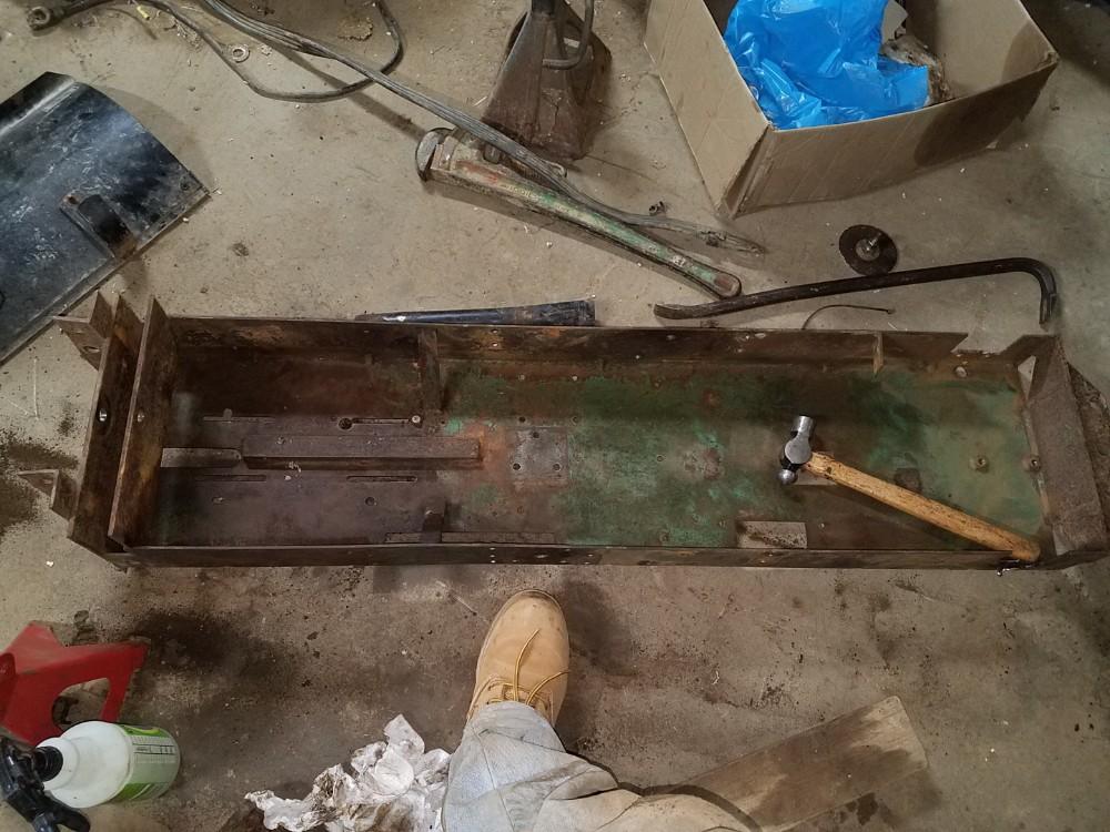

Mudrig150 395 #38 Posted February 20, 2020 I finally got the steering column apart. The lower roll pins, and everything else around there, were absolutely COVERED in grease, like someone put grease in a super soaker and tried hitting the grease zerks from 15 feet away. The pins were also mushroomed, which didn't help. The chrome is in good shape for being almost 57 years old. Frame and dash cleaned up okay. The frame has a lot of bad pitting, and we don't have a working welder, so it's just getting body filler in the pitting. Worst place is under the engine where all the water sat. It's too bad they actually sanded the paint off the outside of the hood and the frame is so pitted, I would've loved to keep the patina this thing has. 1 Share this post Link to post Share on other sites

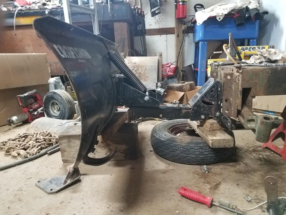

Mudrig150 395 #42 Posted March 3, 2020 (edited) The blade got dug out, I fabbed it up. Then, I cleaned up the shed and the Burns frame and finally got the mushroomed spindle out of the front axle. Don't mind my foot in the picture... Just unintentionally showing off my new-ish boots. Old ones just...fell apart entirely. Edited March 3, 2020 by Mudrig150 Share this post Link to post Share on other sites
Mudrig150 395 #43 Posted March 5, 2020 Set the blade up again... Had to ditch the side brackets because they got in the way of the tie rods and front axle. In the place it's getting mounted, I get about 7.5" of lift max and it sticks out about 19". Now to figure out how to bolt it up without interfering with the axle channel and how to lift it with the stock lift handle. Share this post Link to post Share on other sites
