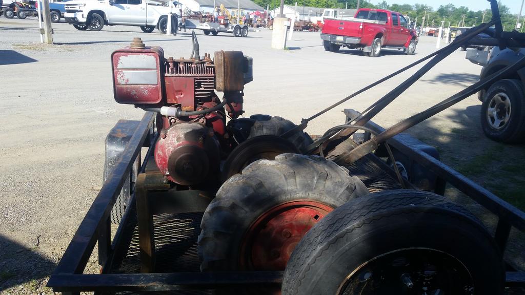

Mudrig150 395 #1 Posted April 8, 2019 So I spotted this little guy while driving down the street one day in winter. It was quarter of a mile from our farm and rotting away under a shed in the woods. The shed was collapsing, and the roof and the mud had just about swallowed this thing whole. I asked the neighbour who had the tractor about it, and he said that if I wanted it, to just come take it. That made me happy! We went down almost 5 or 6 months later, and using my brother's quad, we wrestled it free from its grave 6 inches deep in the mud and brought it home on a trailer on another quad. I was ecstatic. My neighbour stopped by and thanked me for getting it out of the way. We said what it's been sitting since around 2004, so it sat for 14 years. This thing was ROUGH. The original briggs was long gone, replaced with a junk wisconsin which was missing everything to run. That swap was killed so early that the engine wasn't even bolted in. The jackshaft was stuck, the belt was stuck to it, the shifter was good, but the detents are bad, the throttle and choke cables are frozen, the steering is good, and the front tires were flat. The rears would've been flat, but they are so old and stiff that the tubes are shrunken inside the tire and they hold up the whole tractor plus my 135-ish pounds. The chains were stuck to the tires, too. First thing I did was put it outside, where I pulled a ton of parts off, and then winter hit and water in the transmission froze. Oops. Luckily the tractor was on a stand at a 45 degree angle so it saved the gears from getting ice around them, and it only froze the differential. We rolled (well, dragged) it inside and I attempted to remove the transmission to no avail. They used these stupid rounded bolts and the things were stripped. It was awful. I found a Kohler K161 in rough shape, tried putting that in, screwed up all my drilled holes, figured out that the spark plug hole was stripped, and then realized we had a briggs the whole time. And now it sits, briggs engine laying on the frame with no spark. Soon... 5 1 Share this post Link to post Share on other sites

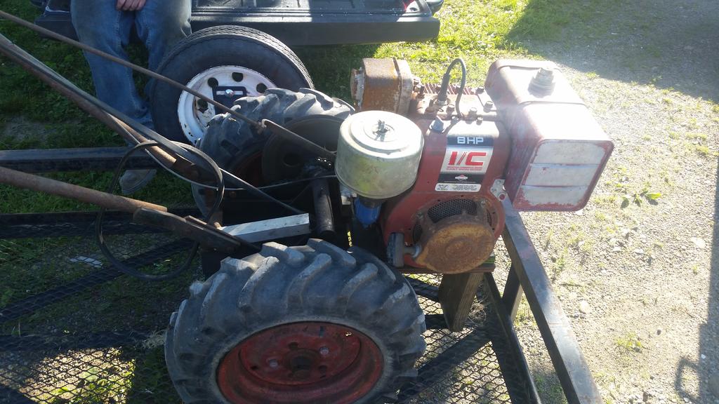

Achto 32,140 #2 Posted April 8, 2019 (edited) Cool looking tractor!! Do you have any better picture of the engine? That air cleaner looks a lot like one for a Kohler. Edited April 8, 2019 by Achto Share this post Link to post Share on other sites
Mudrig150 395 #3 Posted April 9, 2019 This is a picture with the kohler. I need to upload the briggs picture. 1 Share this post Link to post Share on other sites
Mudrig150 395 #4 Posted April 9, 2019 I have it apart to replace the coil and to fix a few things. I need to fix the carb linkages. 2 Share this post Link to post Share on other sites

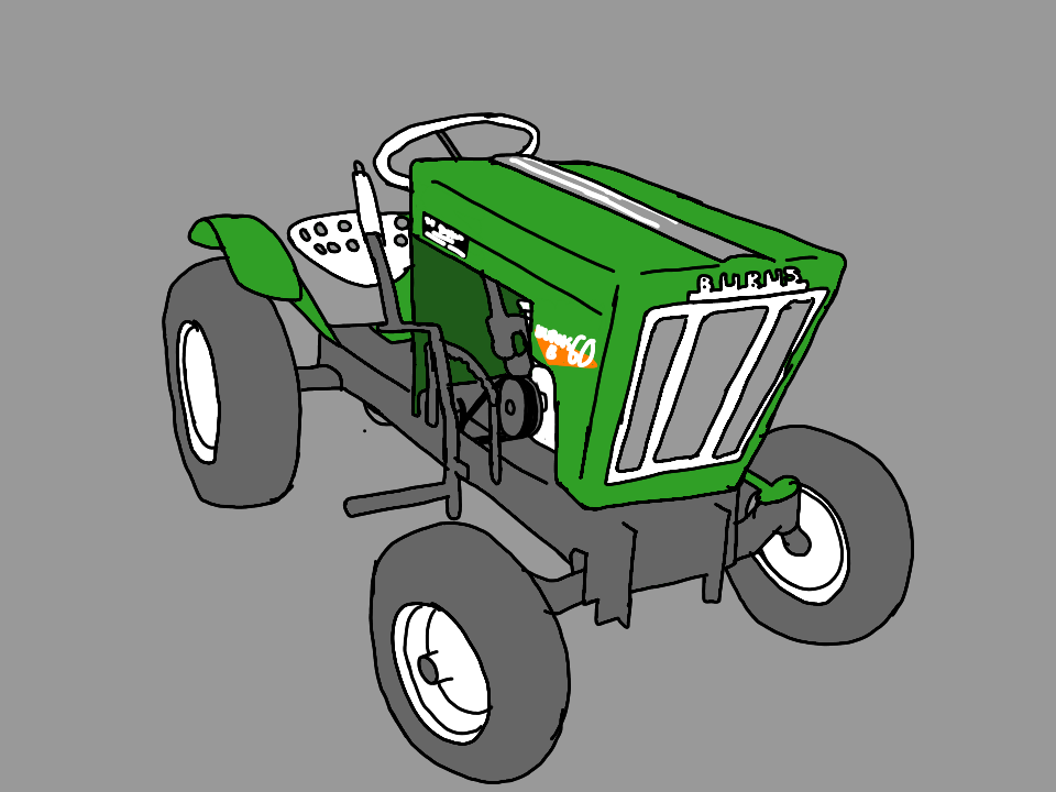

Mudrig150 395 #11 Posted September 13, 2019 What do you guys think of this paint scheme? 3 Share this post Link to post Share on other sites
AMC RULES 37,259 #12 Posted September 13, 2019 Well, I guess... iffin' you're one of them "green" tractor kinda guys. 1 Share this post Link to post Share on other sites
ebinmaine 79,829 #13 Posted September 13, 2019 I like the scheme and the accents. As long as it isn't the same color as those "other green" ones.... Share this post Link to post Share on other sites
Mudrig150 395 #14 Posted September 13, 2019 (edited) 19 minutes ago, ebinmaine said: I like the scheme and the accents. As long as it isn't the same color as those "other green" ones.... It won't be. It'll be more green and less yellow than JD paint. I tried seeing how it looks with the original paint scheme of mostly green with like 3 parts being either white or gray, and it looked bad. I think the extra gray and white accents make it look good. 27 minutes ago, AMC RULES said: Well, I guess... iffin' you're one of them "green" tractor kinda guys. Well, it was originally green, so... In the picture, it should be a very green green. Depending on the monitor it may look more yellow but trust me, it is literally 100% green. The RGB value is basically 0, 255, 0. Basically the JD green is on the left and the Burns will be like the one on the right in this picture. Edited September 13, 2019 by Mudrig150 Share this post Link to post Share on other sites
AMC RULES 37,259 #15 Posted September 13, 2019 Way too close to notice the difference. Share this post Link to post Share on other sites
rjg854 13,244 #16 Posted September 13, 2019 (edited) If you're going for original, the proper green is fine Edited September 13, 2019 by rjg854 Correction Share this post Link to post Share on other sites
adsm08 4,850 #17 Posted September 14, 2019 17 hours ago, Mudrig150 said: What do you guys think of this paint scheme? Looks just about right to run it on the Northern & Burlington line. Share this post Link to post Share on other sites
