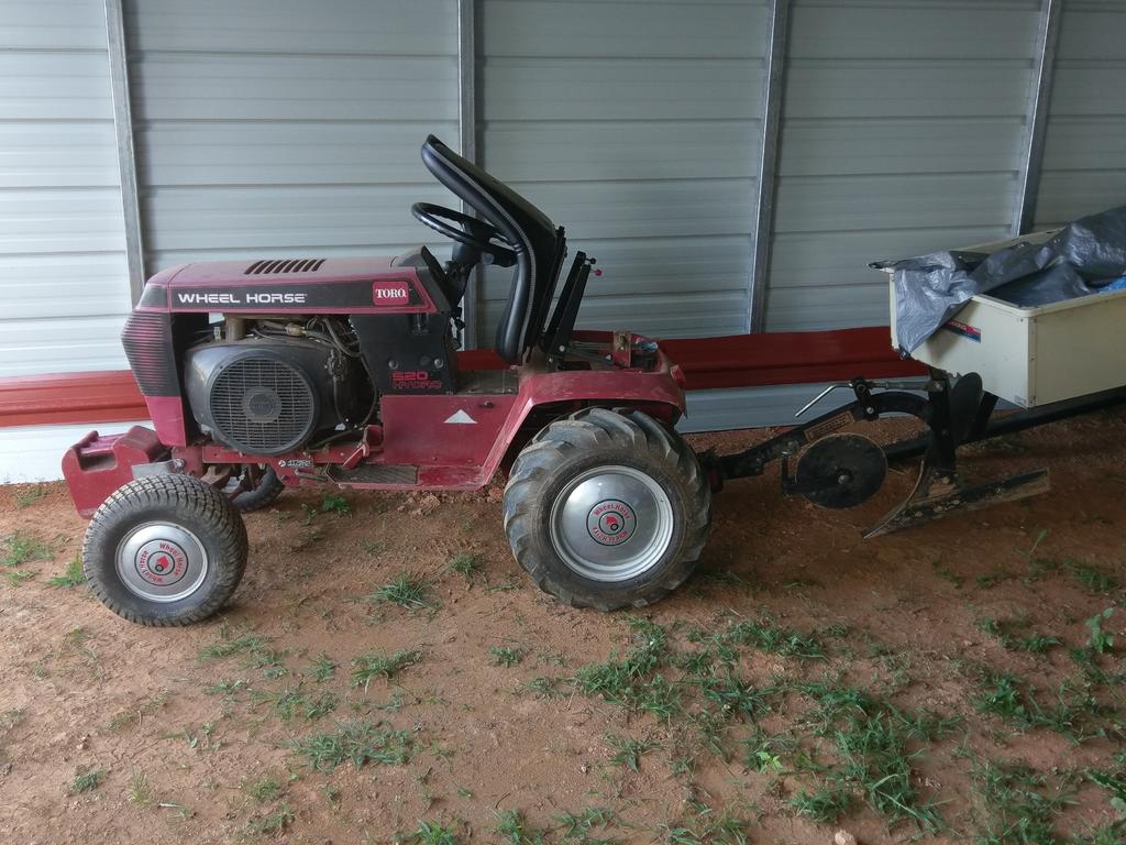

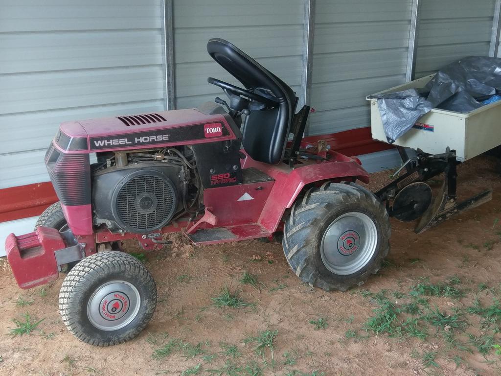

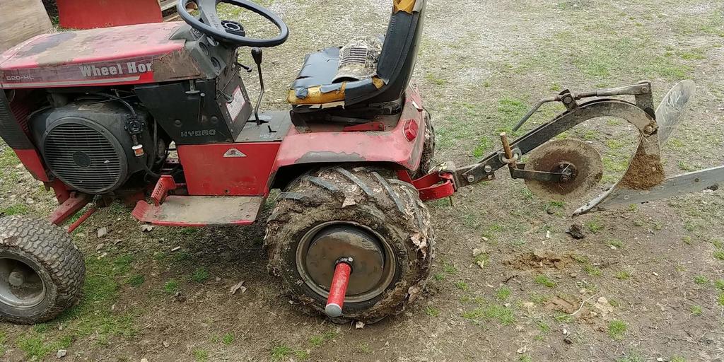

Pullstart 71,520 #2 Posted April 8, 2019 That 520 sure is earning it’s keep! 1 Share this post Link to post Share on other sites

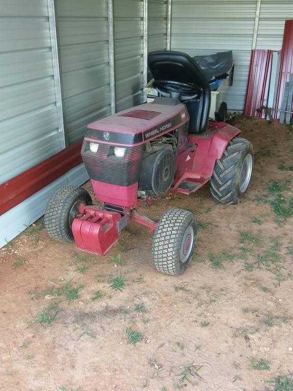

Ralph S 342 #3 Posted April 8, 2019 The front end needs some weight so I can steer the thing. 😆 1 Share this post Link to post Share on other sites
WHX?? 58,347 #4 Posted April 8, 2019 You get some cutters for the ends of them axle stubs you be like them chariots on Ben Hur! 3 Share this post Link to post Share on other sites
Ralph S 342 #5 Posted April 8, 2019 (edited) 53 minutes ago, WHX22 said: You get some cutters for the ends of them axle stubs you be like them chariots on Ben Hur! I added 40 more pounds then trimmed them. LOL That was what I was thinking it looked like too. Edited April 8, 2019 by Ralph S Share this post Link to post Share on other sites
WHX?? 58,347 #6 Posted April 8, 2019 You could take out a few of the green & yellow thingys ! 1 1 Share this post Link to post Share on other sites
WVHillbilly520H 10,379 #7 Posted April 9, 2019 6 hours ago, Ralph S said: The front end needs some weight so I can steer the thing. 😆 1 Share this post Link to post Share on other sites
Ralph S 342 #8 Posted April 9, 2019 1 minute ago, WVHillbilly520H said: Do you have steering assist and how much weight do you have on the front ? Share this post Link to post Share on other sites

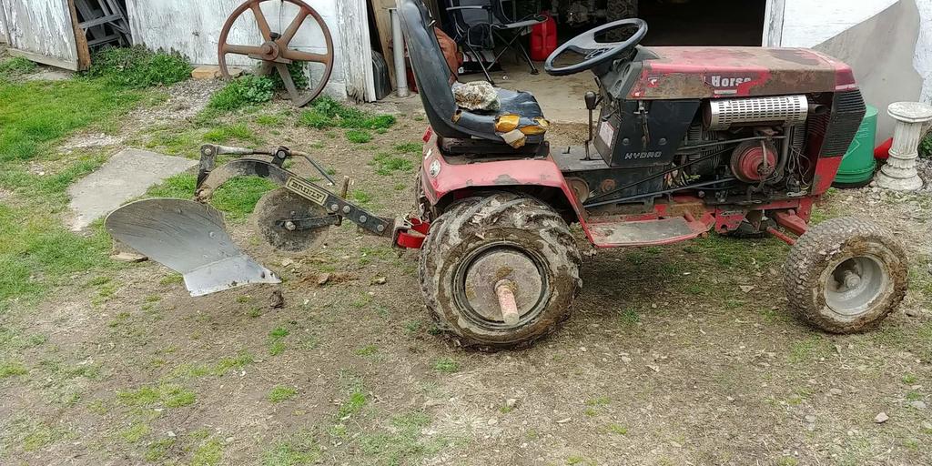

WVHillbilly520H 10,379 #9 Posted April 9, 2019 1 minute ago, Ralph S said: Do you have steering assist and how much weight do you have on the front ? Standard 520H with swept forward front axle has the "gear reduction" steering that an HC doesn't have, and approximately 127-130# (42# each weight plus my hanger/bumper. 1 Share this post Link to post Share on other sites
Ralph S 342 #10 Posted April 9, 2019 9 minutes ago, WVHillbilly520H said: Standard 520H with swept forward front axle has the "gear reduction" steering that an HC doesn't have, and approximately 127-130# (42# each weight plus my hanger/bumper. Cool ! Thanks ! 1 Share this post Link to post Share on other sites
WHX?? 58,347 #11 Posted April 9, 2019 Not to be Debby Downer here Ralph but a 520 doesn't make a primo plowin tractor. I mean it will work but a gear jammer is the best choice. BTW you get a pant leg caught in that open belt don't say you weren't warned. Don't ask me how I know. Share this post Link to post Share on other sites

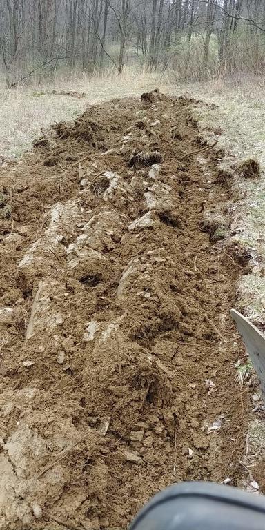

ericj 1,580 #12 Posted April 9, 2019 i also use a 520-H with a 12" plow, I love the hydro lift for the moldboard plow. eric j 1 Share this post Link to post Share on other sites
WVHillbilly520H 10,379 #13 Posted April 9, 2019 6 hours ago, WHX22 said: Not to be Debby Downer here Ralph but a 520 doesn't make a primo plowin tractor. I mean it will work but a gear jammer is the best choice. Depends who's got the reins and how much shoulder you want to strain . Share this post Link to post Share on other sites
Ralph S 342 #14 Posted April 9, 2019 9 hours ago, WHX22 said: Not to be Debby Downer here Ralph but a 520 doesn't make a primo plowin tractor. I mean it will work but a gear jammer is the best choice. BTW you get a pant leg caught in that open belt don't say you weren't warned. Don't ask me how I know. Im new to this sort of thing but I kindof like the hydro lift. If i can somehow get the speed controller to stay put and the throttle tostay put, I think it works just fine. I agree with gear jammers have the advantage of constant speed, but I'm working with what I have. LOL Share this post Link to post Share on other sites
