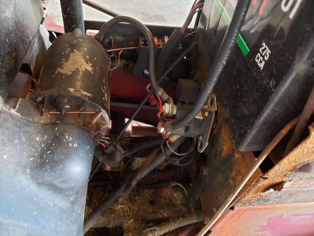

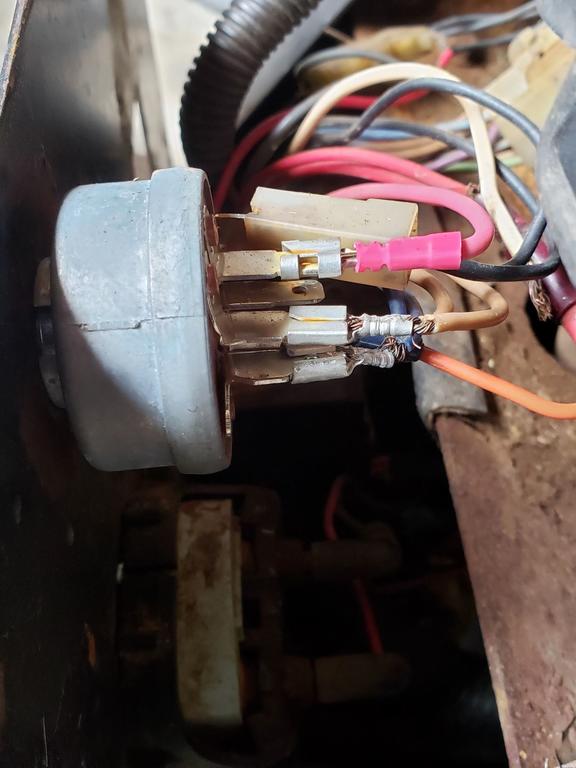

KyBlue 655 #1 Posted April 7, 2019 Picked up a rough 1990 312-H this weekend off Facebook. Mechanically it's sound. Starts Right up, Runs Strong, Mower deck has some swiss cheese going on but seems to mow alright. The hydraulics are starting to leak but that's to be expected. Not sure if it's a hose or the cylinder yet. There are somethings that need to be corrected such as the muffler is mounted wrong. It's vertical instead of Horizontal. That's a easy fix, except they cut the hood!! UGH!! The bigger issue and where I'm going to need help from the experts around here is the wiring. I hate wiring. With a very strong passion. The Key Switch went out, so instead of ordering a correct one, he ordered one from Amazon.com that said it fit wheel horse along with tons of other models. Needless to say, now they key is useless, the plastic connector for the key switch is gone - it's just wires with cheap crimp connectors. Toro has the Plug available so that's easy. However finding out what's supposed to be where is going to be the 'fun' part. I'm also not sure what else he's done. to start it you jump the solenoid, to shut it off use the choke. Any ideas what to check for? There isn't anything obviously rigged. It's also missing the correct Air Filter assembly. It just has a filter no shrouds or housing. I'll need to track that down at some point. For now I stole parts from a different style off the shelf. Pictures! 4 Share this post Link to post Share on other sites

pfrederi 21,308 #5 Posted April 7, 2019 There is no illegality in not using the fancy plug for the ignition switch. Insulated female spade connectors work just fine. Couple of my horses use them on the switch.. Insulated ones not like the PO used. His can short each other out. Wiring switch isn't that hard.. Just make sure the switch has an "M" terminal. Share this post Link to post Share on other sites

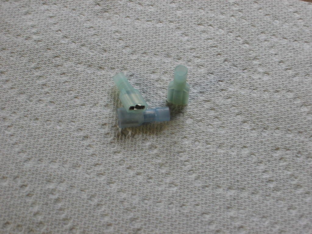

KyBlue 655 #6 Posted April 7, 2019 26 minutes ago, pfrederi said: There is no illegality in not using the fancy plug for the ignition switch. Insulated female spade connectors work just fine. Couple of my horses use them on the switch.. Insulated ones not like the PO used. His can short each other out. Wiring switch isn't that hard.. Just make sure the switch has an "M" terminal. Yeah I realize there isn't anything wrong with using those style connectors, but he used the ultra cheap ones, and the less than good crimping tool that pinches more than crimping. I prefer the self shrinking ones with a dab of dielectric grease inside to minimize corrosion. Found the wiring info I needed in the manuals section. Just a matter of taking the time to change the connectors and get it back the way it should be. Thanks! Share this post Link to post Share on other sites
