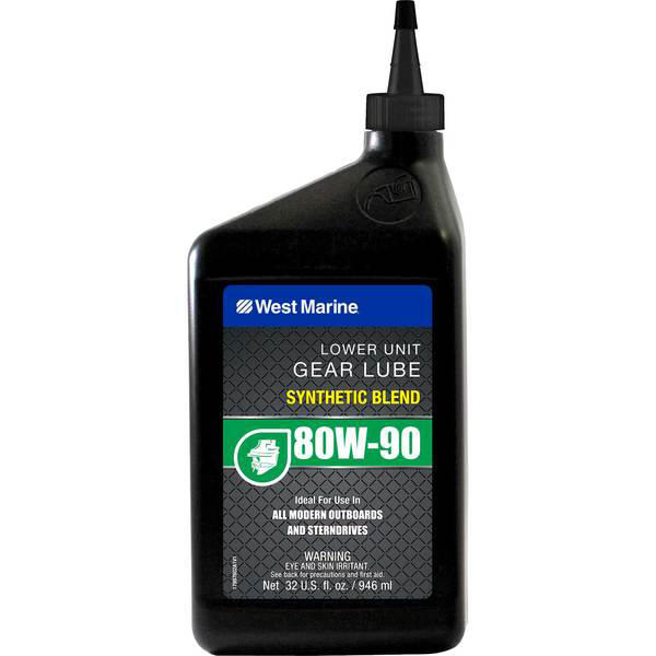

troutbum70 858 #9 Posted April 7, 2019 I will probably try the shifter hole first if in the event I can't get the lock nut lose or securely handle the set screw I will go to plan B. I have a hard time imagining getting 1 and a 1/2 quarts of 90 wt in the hole in the rear. 1 Share this post Link to post Share on other sites
wallfish 19,379 #10 Posted April 7, 2019 19 minutes ago, troutbum63 said: I have a hard time imagining getting 1 and a 1/2 quarts of 90 wt in the hole in the rear. Get yourself some kind of a squeeze bottle if using the fill hole. It will take FOREVER using a funnel. 1 Share this post Link to post Share on other sites
The Tuul Crib 7,347 #11 Posted April 7, 2019 19 hours ago, stevasaurus said: You can fill through the shifter hole, but I like to fill through one of the two bolt holes that hold on the seat and fenders. Fill until oil starts to run out the fill hole on the side. 1 1/2 to 2 quarts. 90 wt. Share this post Link to post Share on other sites
